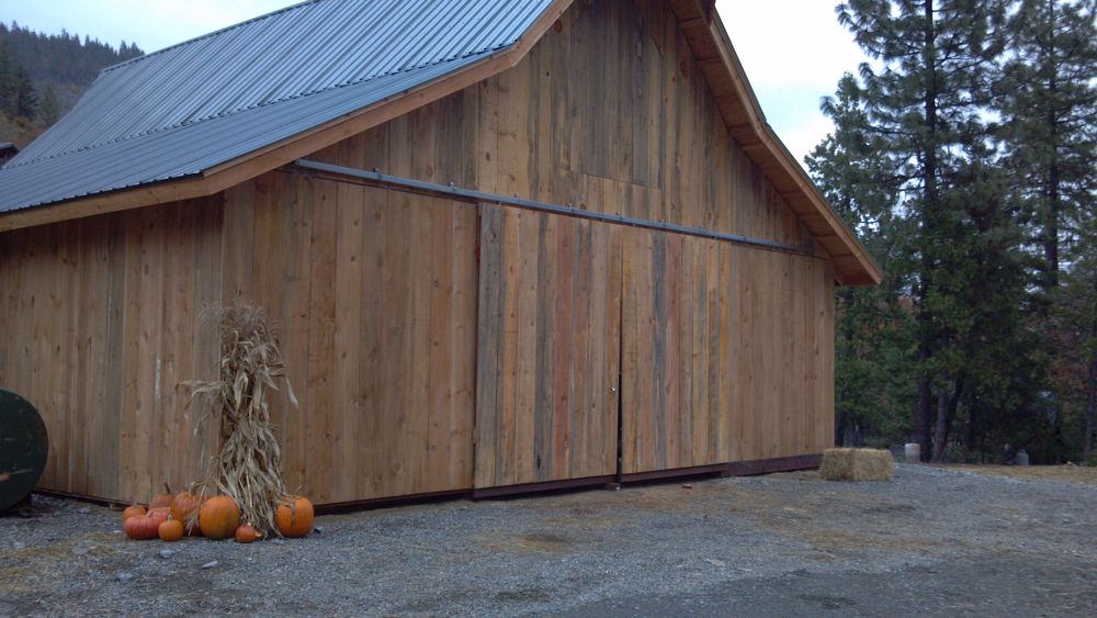

Im getting ready to have a barn built this spring. Problem for me is the type of materials. My family has owned our farm in Ohio since around 1850. All the structures have always been wood and i really want the new barn wood as well. BUT i know metal last longer so am i making a huge mistake going wood? Im looking at a 40x60x12 or something close to that size. Will hold equipment etc.
Lastly bats are a big issue to so need a tight structure too. If i do wood i want some sort of barrier like tyvek to keep stuff out.
Thoughts?

You're not crazy. I have an all-wood pole barn. The previous owner built it so I don't know what it cost, but he was cheap and it seems cheap. But it has stood for 20 years now. The walls are vertical tongue and groove pine over 2x4 girts on 24" centers, and the roof is asphalt shingles over 1/2" sheathing on top of 2x4 purlins on edge, on 24" centers. So it's pretty standard pole barn construction. I can get locally sawn and milled T&G for $1.50/SF which I think is competitive with steel siding. All my other buildings have cedar shingles, the last time I bought them I paid $1.22/SF for grade B's. I think that with 3/4" plywood sheathing shingles would work, that's about $35/sheet right now or another $1.10/SF. Board and batten isn't popular around here, but if I wanted to go that route rough cut lumber is running about $0.80/SF now for pine and about twice that for cedar.
Now what's crazy is thinking your barn can be bat-tight!

Wood barns are beautiful! I just built mine. It's 36' x 36', pole frame w/ 1x12 rough-cut pine vertical siding. 16' wide center aisle without center posts. Built the trusses myself. Already have mice building nests and need to get a few barn cats! :) Metal barns are just big metal boxes. No character. Depends on what you're looking for. I did a lot of the labor myself except for the roofing and setting the posts and it cost somewhere around $20k.
