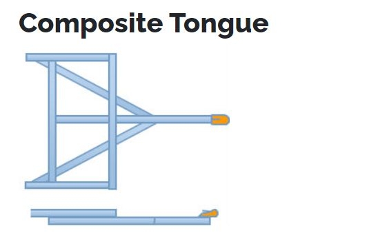

As for the design "channel tongue" another nope, go with tubing. If you ever get into a situation where it's loaded to the max or on a rough road, you're looking for cracked diagonal braces where they're under the front edge of the deck from flexing. IMHO the best style of tongue is one that is a single center tube that goes back two preferably three bunks and two diagonal braces (same idea as what they have now) from the coupler back a couple of bunks either side.

   / Aluminum car trailer vs steel
Something like this only with tube not channel?

   / Aluminum car trailer vs steel #8
Yup, except the main tongue is back further so it's under one more bunk.and the diagonals are bit further forward toward the coupler.

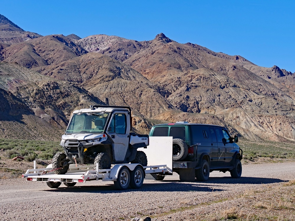

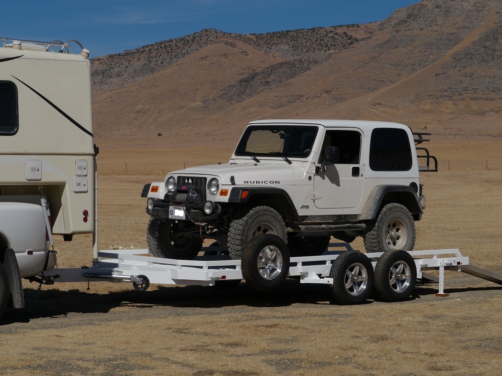

I wouldn't be afraid of an aluminum trailer at all, considering your application. 8 years ago I bought an Aluma Model 7816 all-aluminum trailer and it has held up perfectly despite being used mostly on washboardy dirt roads. It has thousands upon thousands of miles on it - I've towed a car on it to Texas from Nevada, and my Jeep all over the west coast and my side by side also. I've had to do NOTHING as far as repairs to it. I did paint it white because I preferred that to the aluminum color (deck is aluminum also); I also mounted a 4' high piece of plywood across the front because gravel off the towing vehicle's tires was messing up paint and glass on whatever was on the trailer. The fenders are quick and easy to remove in case the car doors don't clear.
