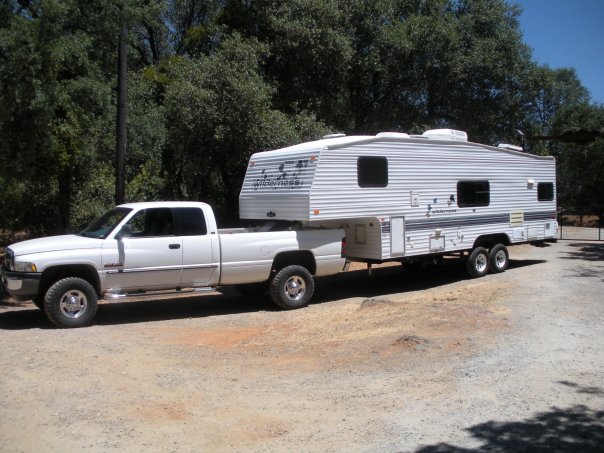

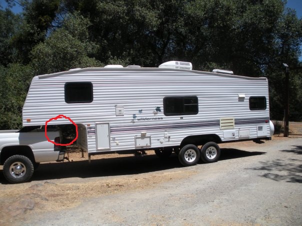

Same reason my 5th wheel has flipped axles for 4-5" of "lift". My stock Dodge 2500 4x4 sits too high in the back. If I were to remove that "lift", the trailer would be at too much of an angle; the trailer would hit on the top of the bed rails and tailgate. The portion of the trailer from the hitch/pin-box, to the main body. That's just sitting on level ground. going in and out of parking lots ect, as the truck moved in comparison to the trailer, it would hit.
My 5th wheel sits level behind my truck. But, the axles are under the springs for about 4" lift. If I did not have that "lift", the back of the trailer would sit too low. That would cause it to hit where the red circle is.
That is the clearance issue the OP would have.
