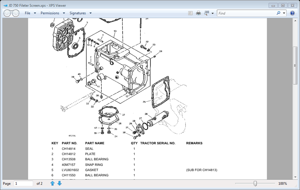

I also have a loud buzzing sound anytime the trctor is running, except when I am using the hydraulics (it stops when I raise / lower the bucket or tip the bucket).
It starts again immediately when I stop using the hydraulics.

Before messing with the hydraulics, I'd make certain the Hydraulic fluid is new and the screen cleaned, or if it has power steering to make certain the filter isn't old.

The hydraulic filter and oil are both new, I don't think it has a screen.
The hydraulic noise started recently and goes away when the FEL is in use, but it comes right back when I stop moving the FEL. Kind of like the noise is there unless I am making the hydraulic pump work. Noise when FEL is not being used, no noise when FEL is being used. Could air in the hydraulic lines be causing this problem?

JD 750 have a screen that is accessed from the side (Remove one of the rear wheels and it is there). The hydraulic filter was an add-on when the optional PS was added. It's simple enough to verify the screen is there and clean. Other than draining the hydraulic fluid again and your time it doesn't cost anything and is a place to start.
Is it the correct hydraulic fluid being used?

Thank you for the information on the hydraulic screen, I will look into it, might be a little while as we just got 2+ft of snow in northern Colorado and the tractor is outside. I'm using John Deere hydraulic oil and the level is ok.

my 750 was making the same hydrualic noise and cleaning the screen did wonders. The hydraulics work amazingly now.
