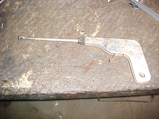

I've never had a problem with the standard striker either, but recently found a trigger pull striker, a little more consistent spark.

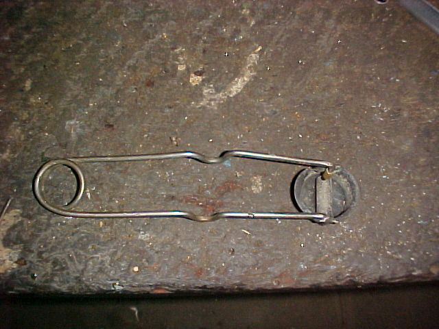

Thanks for your opinions gentlemen.
I'll see if I can find the piezo lighter as sold by Kimball - in Australia.
I have used a piezo that was intended for gas ranges in the past, but it too expired.
As I love looking at other's photos, I thought it only fair to show the flint and piezo from my workshop.
