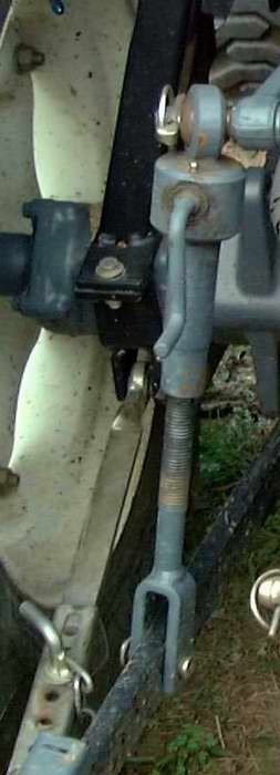

Hi Brad, can you give us some dimensions? How about a picture so we can see how the top of your turnbuckle attaches to the rockshaft lift arm? I'm pretty sure the bottom fork on the swinging sidelink arm would be adaptable, but I don't know how the turnbuckle attaches at the top. It might take a little cutting/welding, but I'd bet one could be adapted for your tractor.
   / Alternative adjustable lift rod on 3PH #3
I'm not Brad, but here is a picture I took of mine awhile make when I lost the bolt on the other side. The top is basically a ball link.

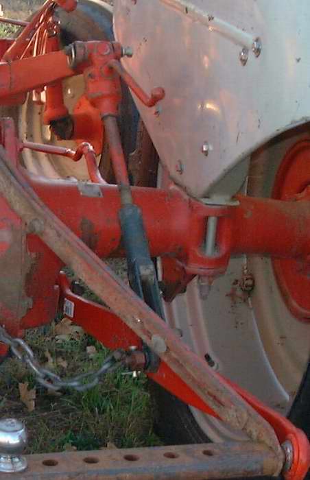

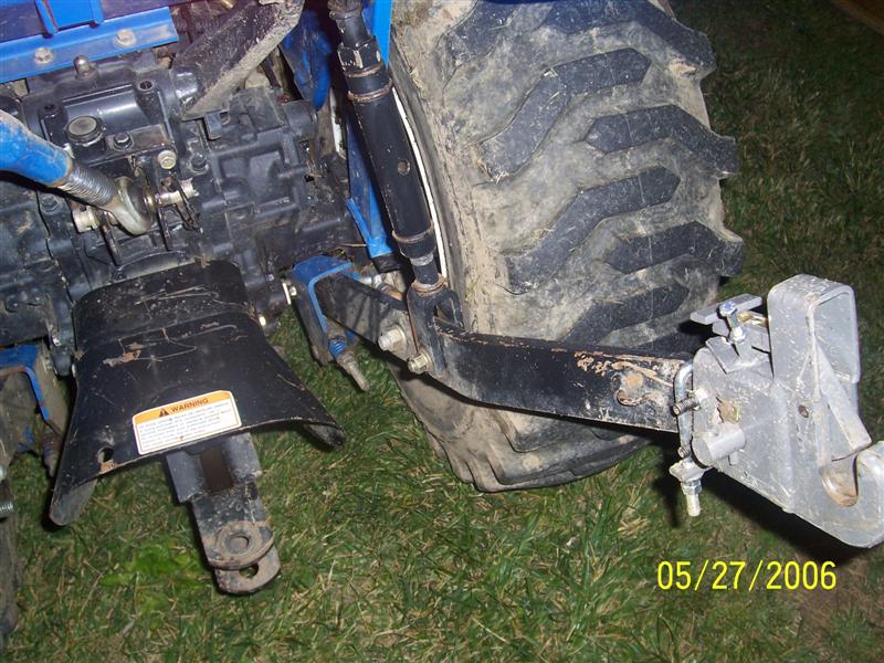

Soundguy, I think you are correct. Brad could probably change the mounting if he has to. On the older tractors like our NAAs, the handcrank is mounted with a pin into a yoke at the top, but the newer ones have a hitch ball that is just like the ends of the lower lift arms. I'm attaching two pictures: The first is the old NAA style and the second is the handcrank moved to the left arm after I installed a tilt cylinder on the right.
Brad, I think the only problem you might have is turning the handcrank with an implement on your 3PH. Your arm is very close to your wheel. That may be why NH put the turnbuckle type on your tractor.
