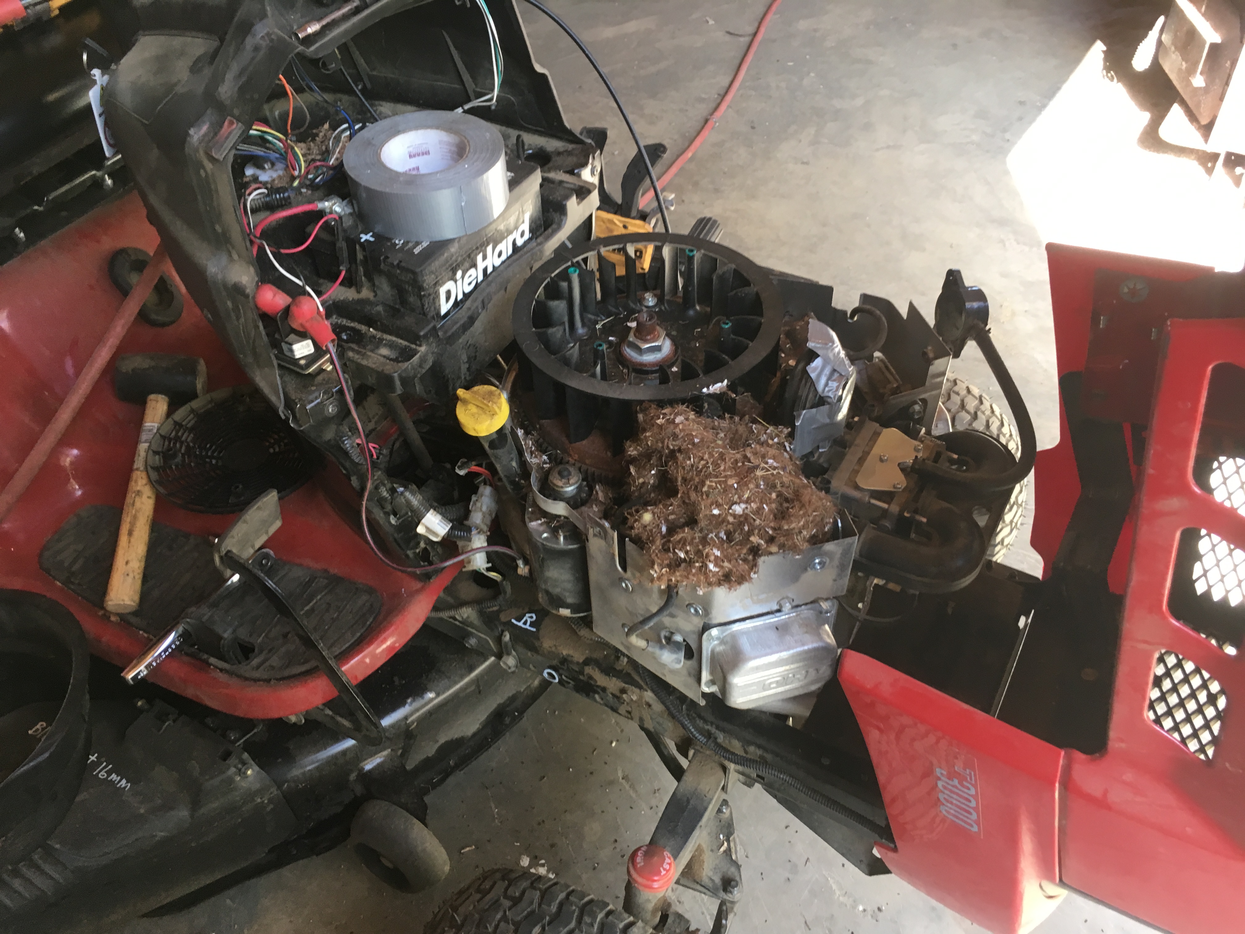

Getting almost pass time to mow the lawn so this afternoon I pushed my riding mower out of the shed, tried to start it and no go, the motor wouldn't turn over but the starter was turning. Ok so the starter was making a noise but wasn't engaging the flywheel, must need more juice so tried boosting with power pack, Rhino, then lastly the tractor, nothing, just the starter making noise.
So dragged it the garage and noticed there's no good place to hook a chain on the front end, fix that later. Once in I check the battery with multimeter, 12+ volts, must be something wrong with the starter, I got the plastic off where I could see part of the problem, got it all cleaned out, spray with Gibbs penetrating oil, then pried the starter gear up and down, got it unstuck then took the plugs out and the starter whirled the right motor over. Put it all back together hopping the pickup coil and flywheel wasn't to rusty, then turned the motor over about a minute and finally started, thought it would where I put StarTron in the tank last fall.
I sprayed peppermint oil all over that mower, the stuff must not be long lasting, this fall when I put in my storage shed I'll load it down with moth balls and put a tarp over it see what that does.

Based on experience, the tarp will just give the little buggers more courage, because it gives them cover. About the only thing which keeps them down is a cat. Or D-Con, but I try to avoid using that.

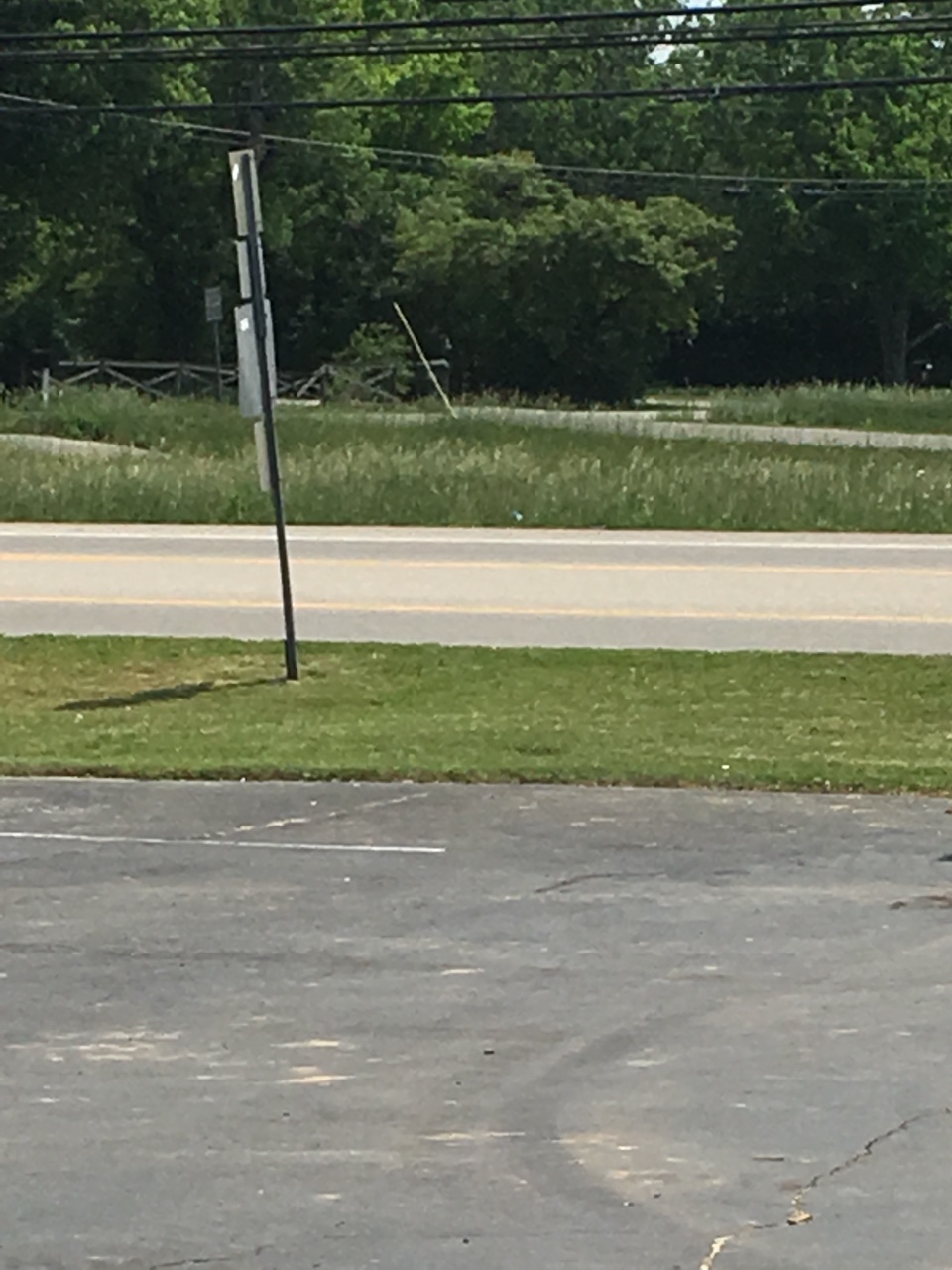

Where do you live that just now needs mowed? I’ve been mowing since Easter. Here’s a field that hasn’t been mowed yet.IMG_4183.JPG
