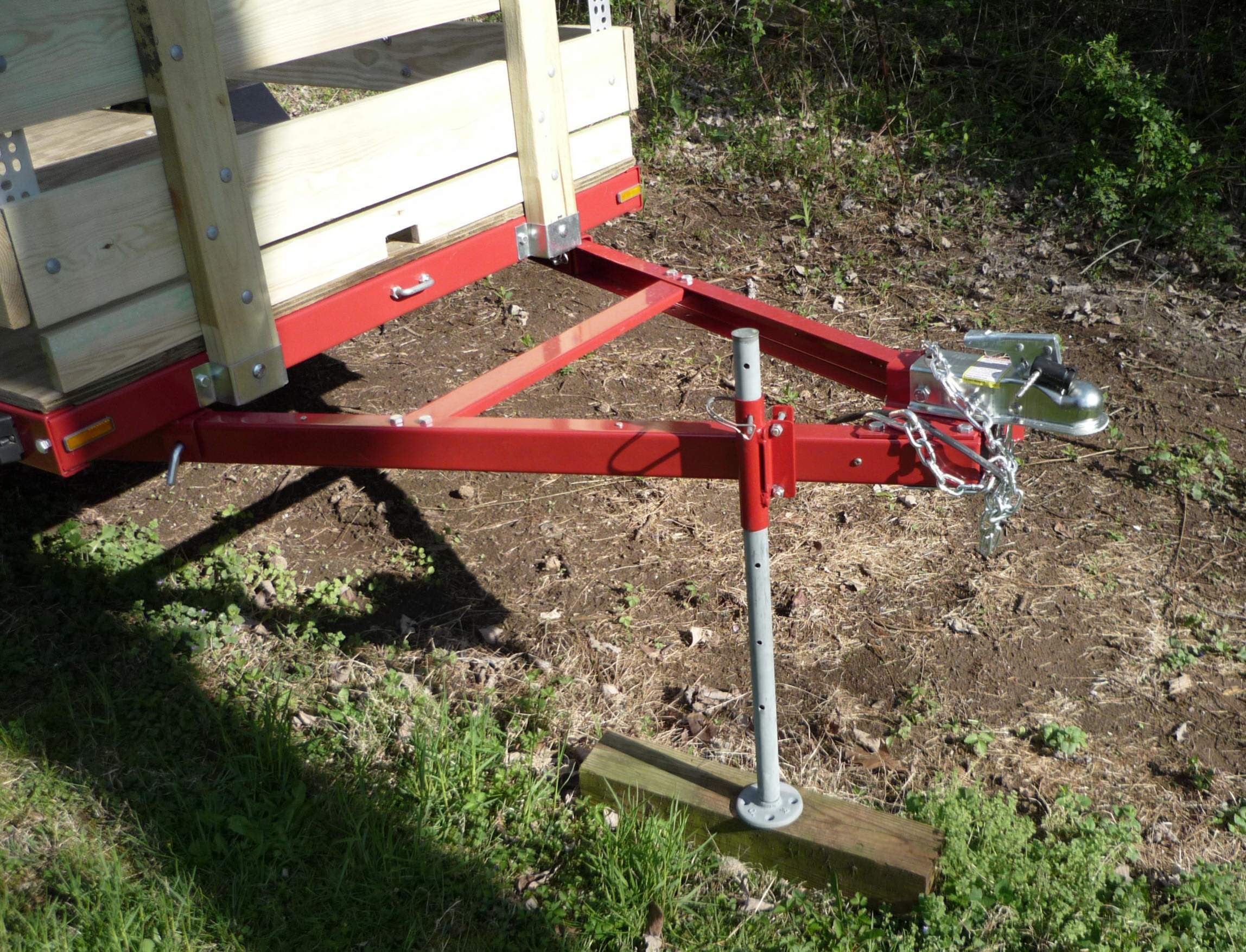

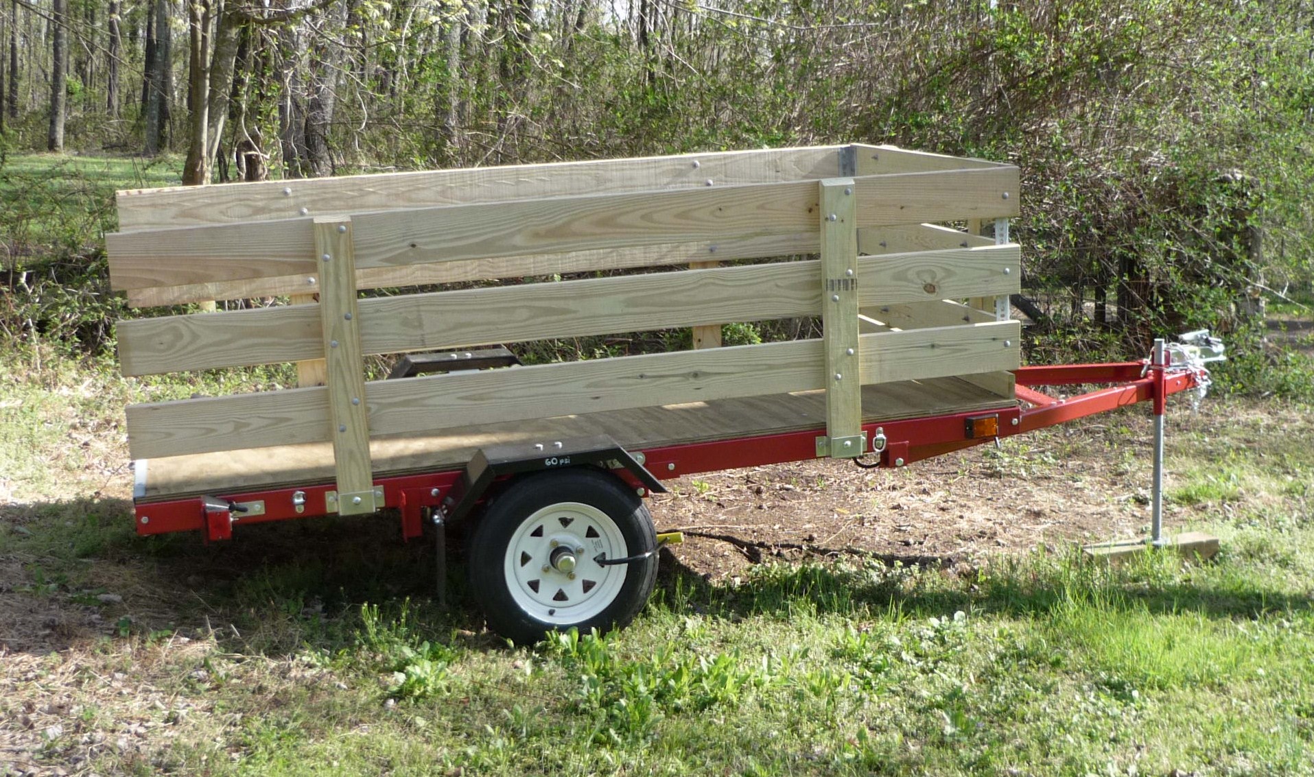

So, when I posted some photos a couple of weeks ago of my "new" Harbor Freight" trailer project (it's a kit, and I started "improving" it when I put it together) I hadn't figured out just how I would finish it. I decided to add rails around it, some mud flaps to keep spray off the lights, and a little jack stand to hold it off the ground for drainage, etc., when it was being stored. Notice the bike lock thru the wheel to slow down potential thieves. Only project left is a steel wire gate/ramp to be hinged at the back. I know, I have probably used up 20% of its weight capacity with all the improvements, but since I don't carry really heavy stuff, I think the utility is worth it. I can always remove the rails if I have to.

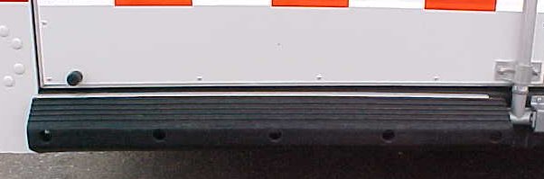

Yes good job, May I make a suggestion, I see it is a tilt trailer, You will be loading things by either using hand truck or ridding mower ect,etc, when the trailer is tilted posistion it will have a bit of a step-up at the rear rail, perhaps adding a rubber bumper could tapper this area providing a easier transition, plus add some protection to the rear frame rail against the ground,

I store it tilted so water won't pond on it. You can't really tilt it to load because of the license plate and lights, but the wire gate/ramp will be intended to drive things/walk onto it. I did install a galvanized angle to protect the back of the plywood deck when I load it. Keep in mind I was mostly using stuff I had around, since I am cheap (oops- thrifty...)

It is looking good. You might want to take out the bolts on the sides and turn them with the threads facing out you yo don't catch you loads on the exposed threads.

RoMad: believe me, I agonized over which way to put them... better inside, so passersby don't get snagged, I figured. I will probably take a cut off wheel to them before I am done. An on-going issue.
