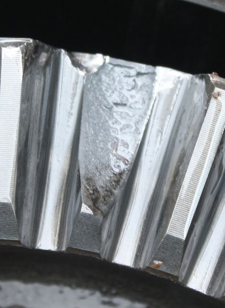

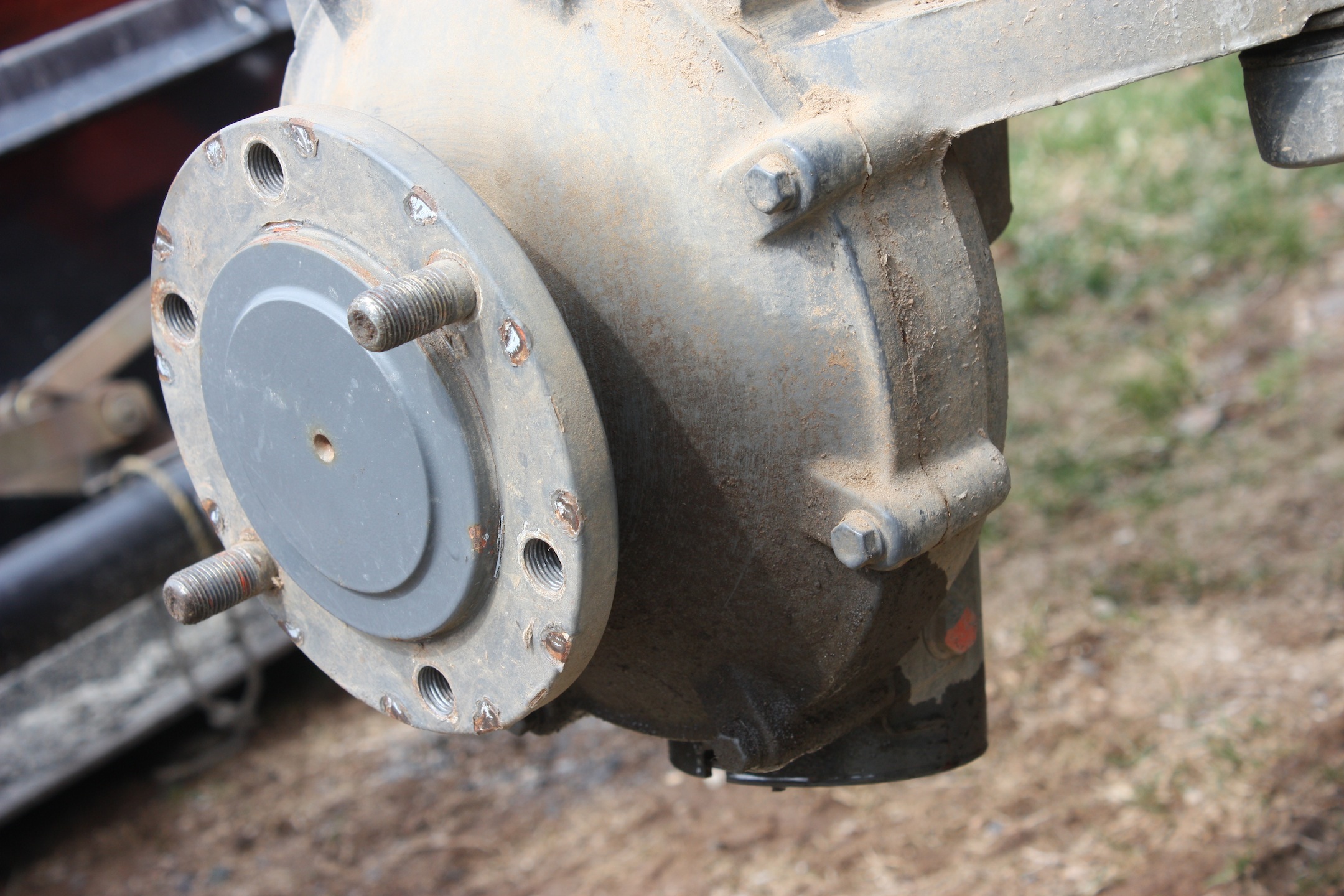

On the way home(just before my lane) the front left wheel locked up. Left a black mark on the pavement. I stopped, tried going forward, moved a bit. Backed up fine. Moved forward slowly and made it home. The tractor is due for 700 hour service. I called the dealer and explained the situation. I also noticed a bit of oil leaking around the hub assembly. He suggested it might be a bearing and to take it apart bring it to him Monday and they will fix and return when the do the servicing later in the week. It was a challenge to get the wheel lugs off and all of the other bolts. Is it a good procedure to take all the wheel lugs off a grease?

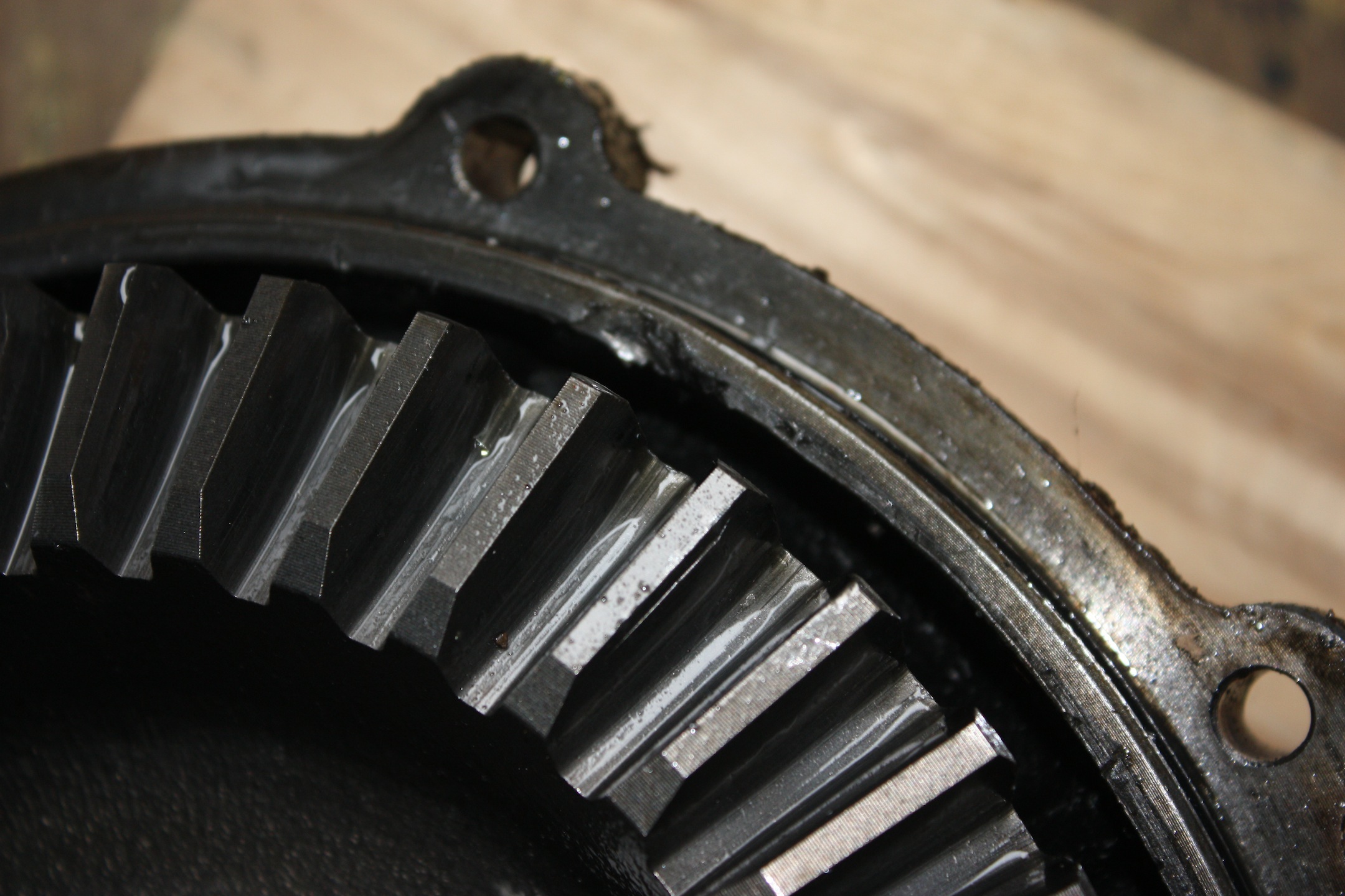

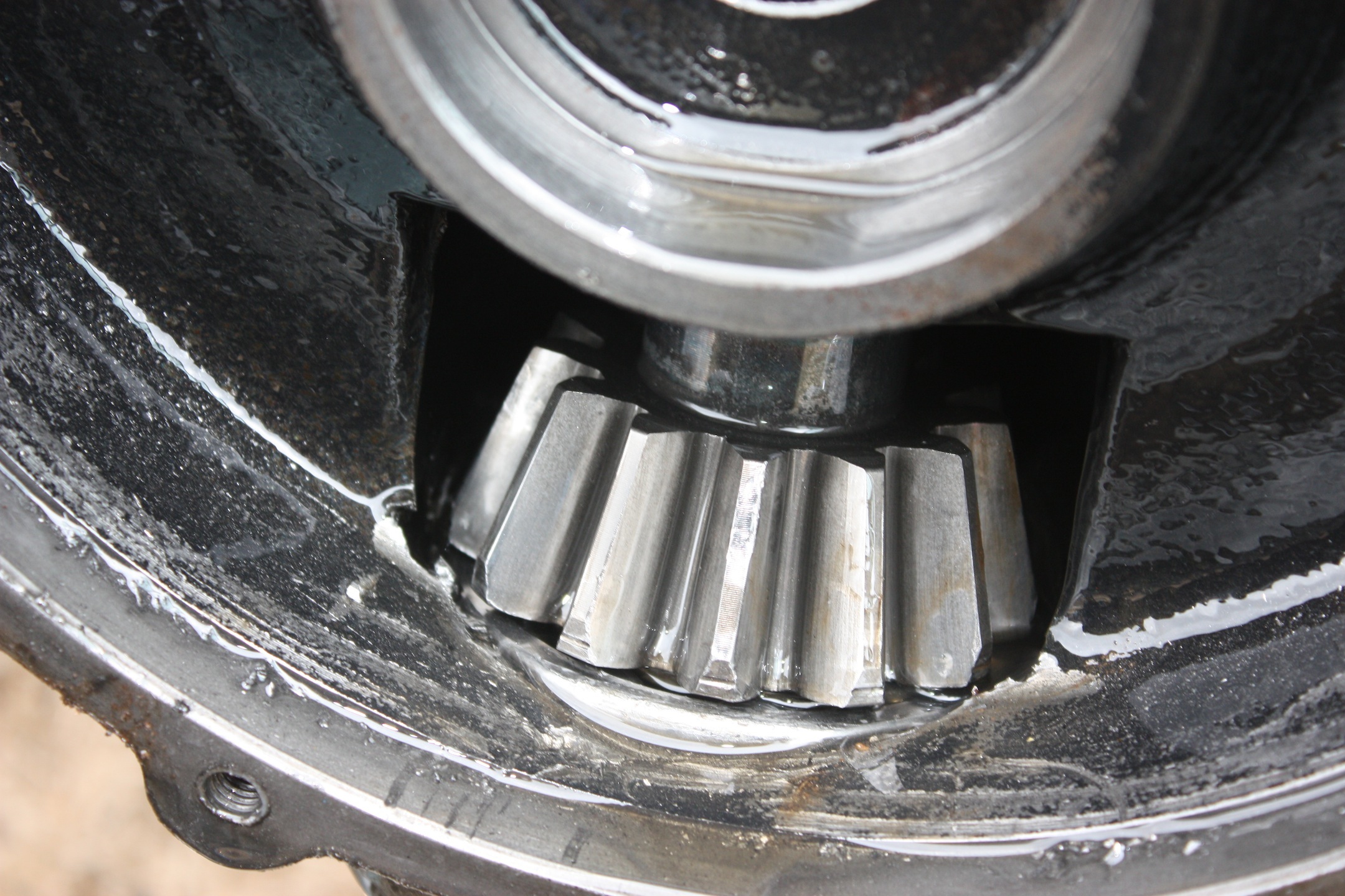

This is what I found... more than a bearing...

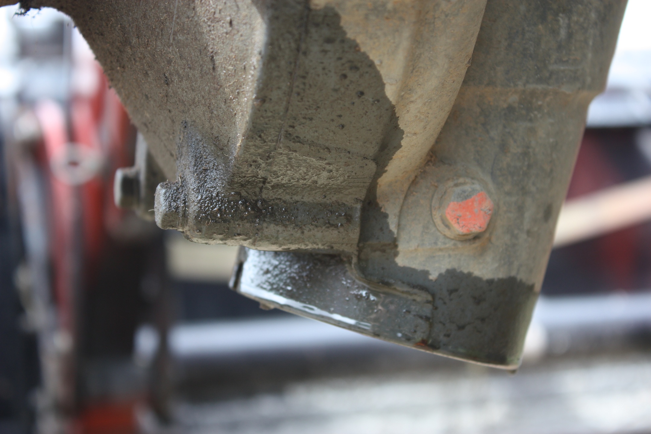

Both bevel gears need replacing. The housing/cover has a little nick in it plus the axle case has a few burs at the base just below the cog.

There is no blueing to the gears. It look like it may have just been a failure.

Looks like a casting flaw, upper part of gear looks like 1/2 an empty bubble, was probably an air bubble in casting, and as a weak spot it just let go and a bunch of the tooth chunked out as well, I would be concerned if it was not covered by warranty.

Forgot to include this section of picture 4 as area with flaw.

Sure looks like a tooth blew out and got caught up in the housing, thus the case damage resulting too.
Dealer should take care of it for you under warranty.
