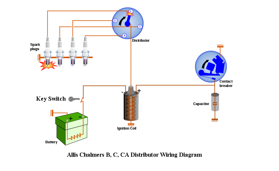

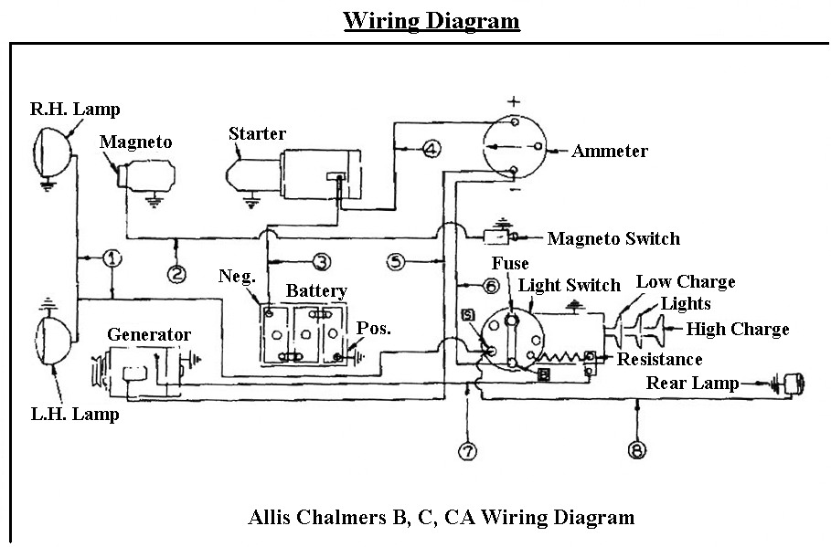

Allis Chalmers CA
I scanned the Schematic from my Service manual and modified it to show
the proper wiring for a Distributor.
Make sure you verify the Positive Ground Wiring, and verify that the Coil
wiring has the PLUS (+) Terminal wire going to the Distributor.
Enjoy!
LK

Perfect,Been looking for dist. wrg, pic. THANKS.

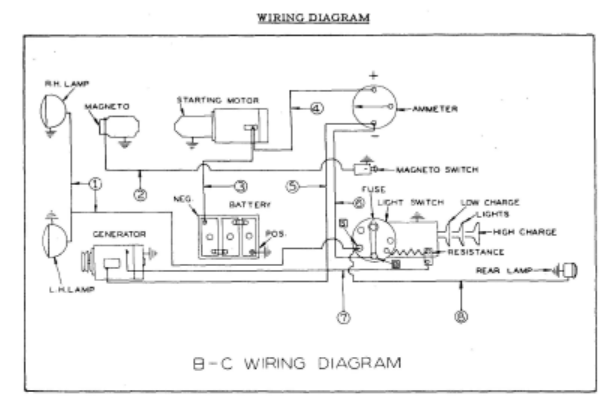

From the AC B&C service manual
The firing order is 1-2-4-3 (I assume cylinder #1 is the one at the front of the engine).
Good luck
