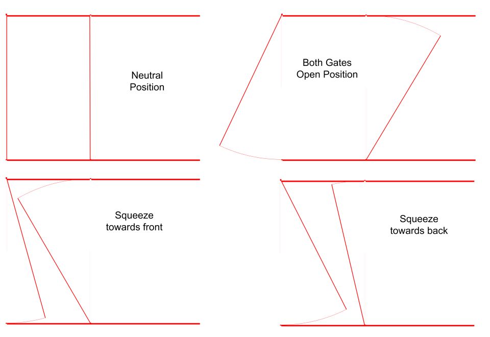

The Dube chute is interesting. I've been studying the pictures you provided trying to decide for sure how it works. I see the palp access on both ends. I see how it ratchets but what controls an animals back and forth motion? Nose pinch and/or squeeze?
Sorry I didn't have better pictures for you there. I'll do a better job when we get the handling system actually built. It is really quite versitile. The gates swing in from opposite sides, so you can squeeze them up any way you want. You can squeeze them towards either end of the chute or keep it balanced in the middle for branding. There are cleats as well that you can use to tie off nose pliers. Here's a graphic of how it works:
