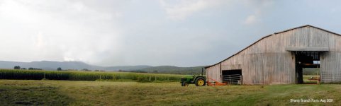

   / All over but the Shouting
#9
Got a quick pic of the 4500 just after I finished mowing the barn lot. This is before FEL was put on.
