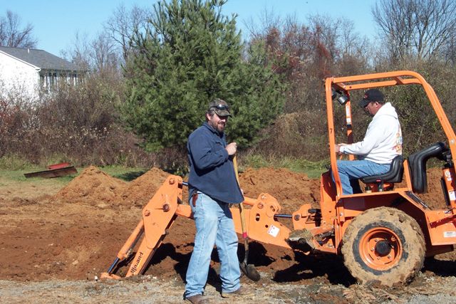

Was the machine 4WD, and was it muddy out? My contractors rented one to dig the foundation of my garage/barn, and it was 2WD and it was muddy out. I ended up having them do the excavating with the hoe and I moved all the spoils with my little kubota because they couldn't go anywhere with any weight in the bucket.
