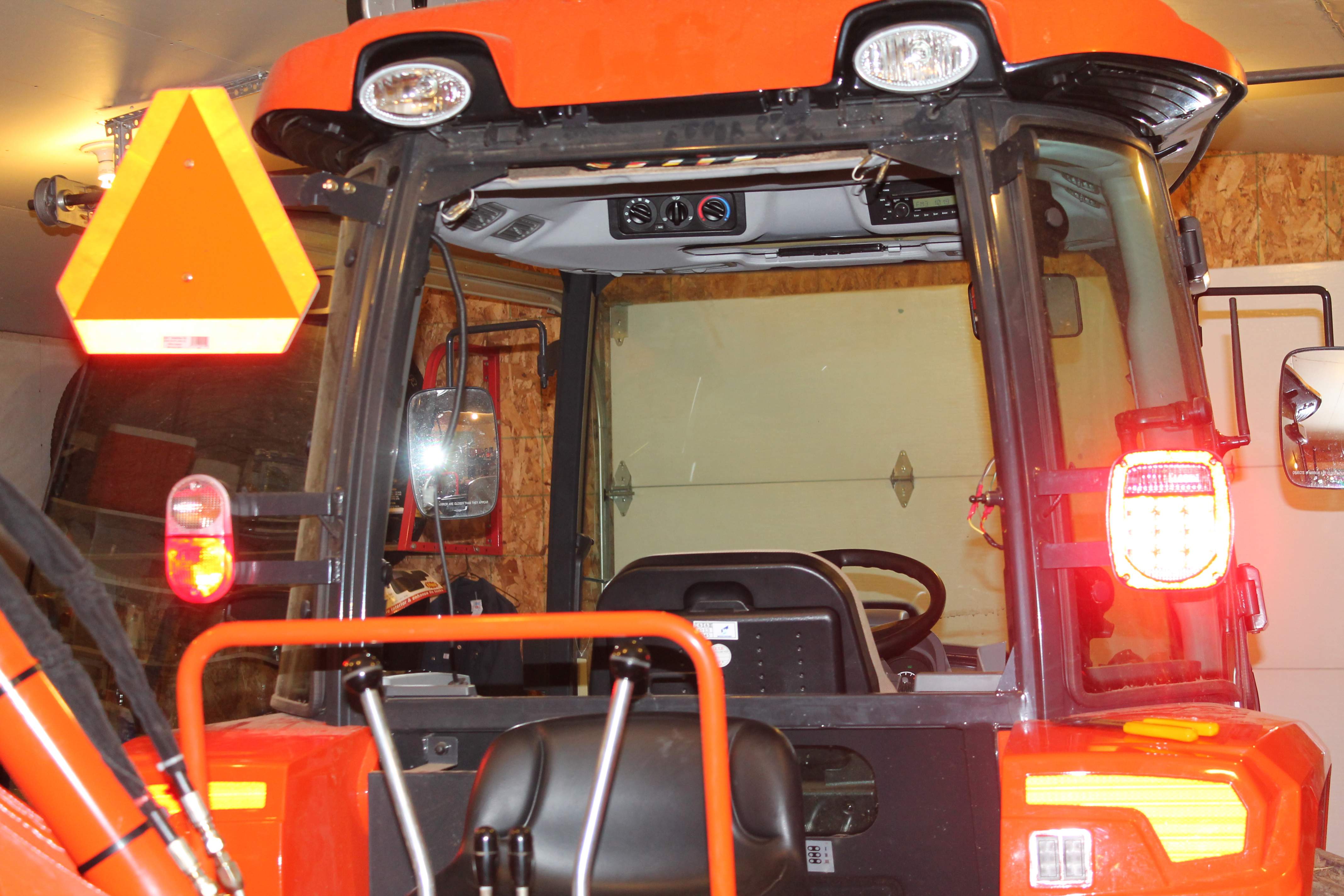

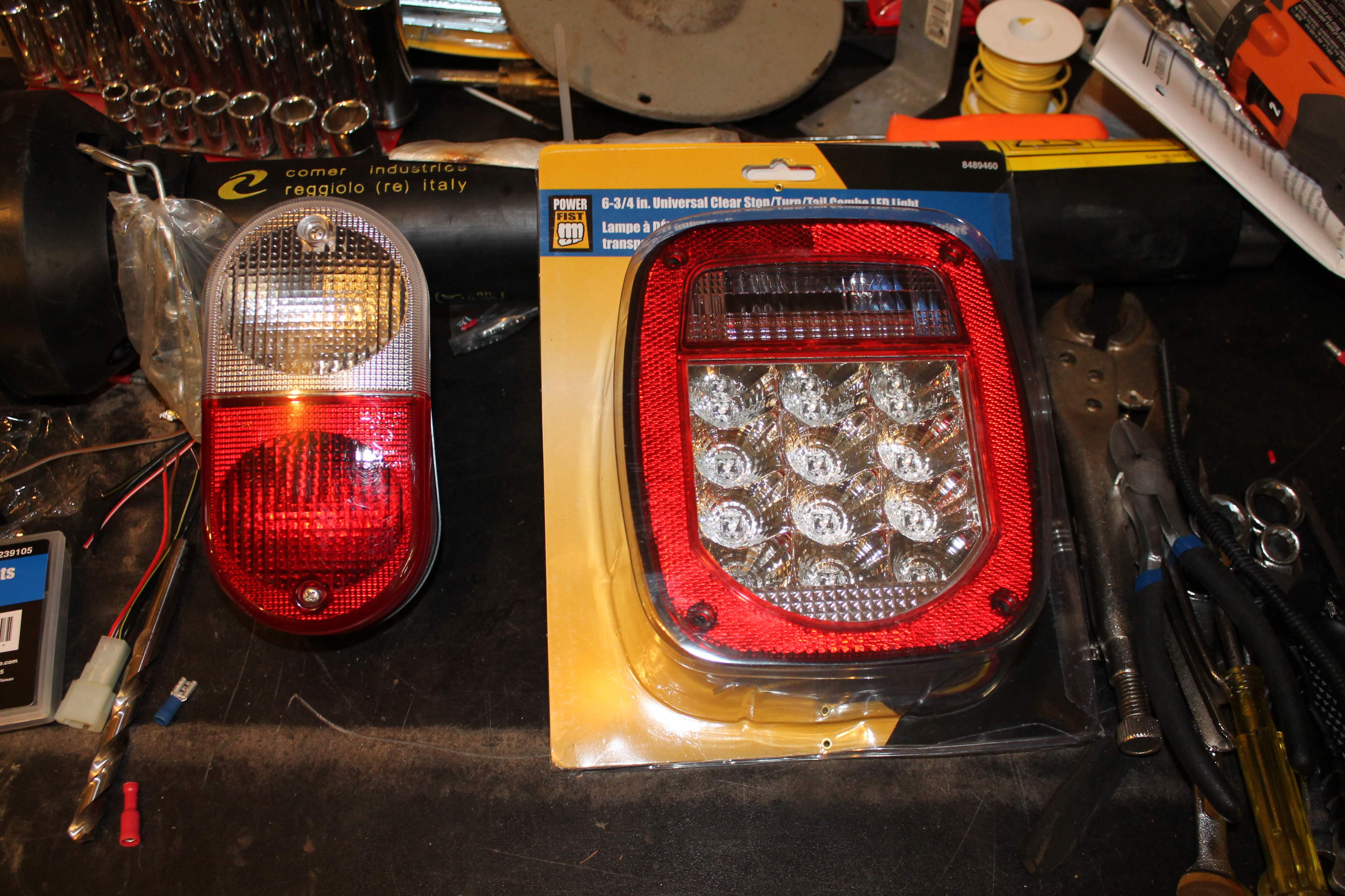

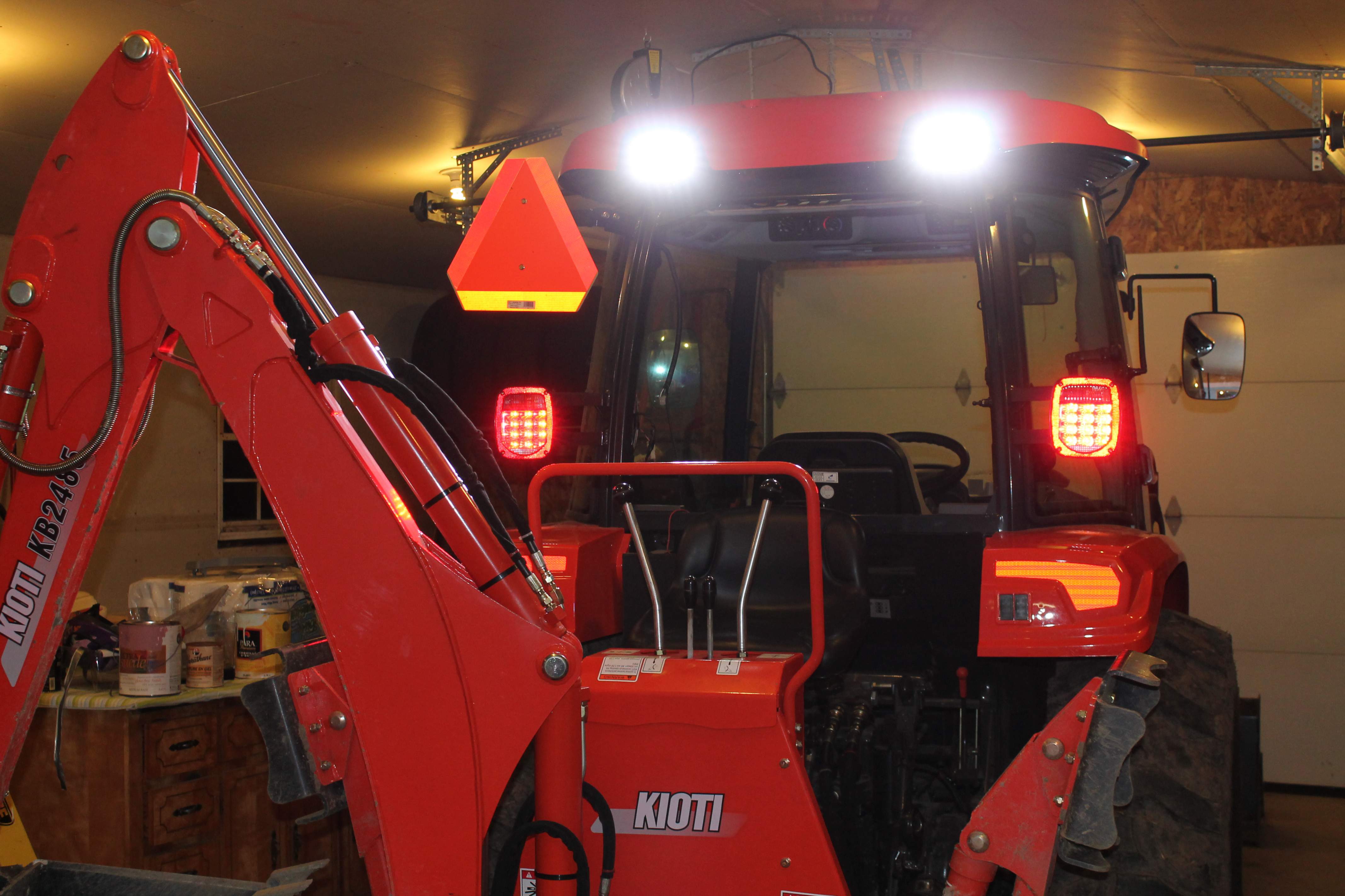

Just finished installing my rear LED lights and figured I may as well switch the tail lights also they were only $25 when they were on sale at Princess Auto.

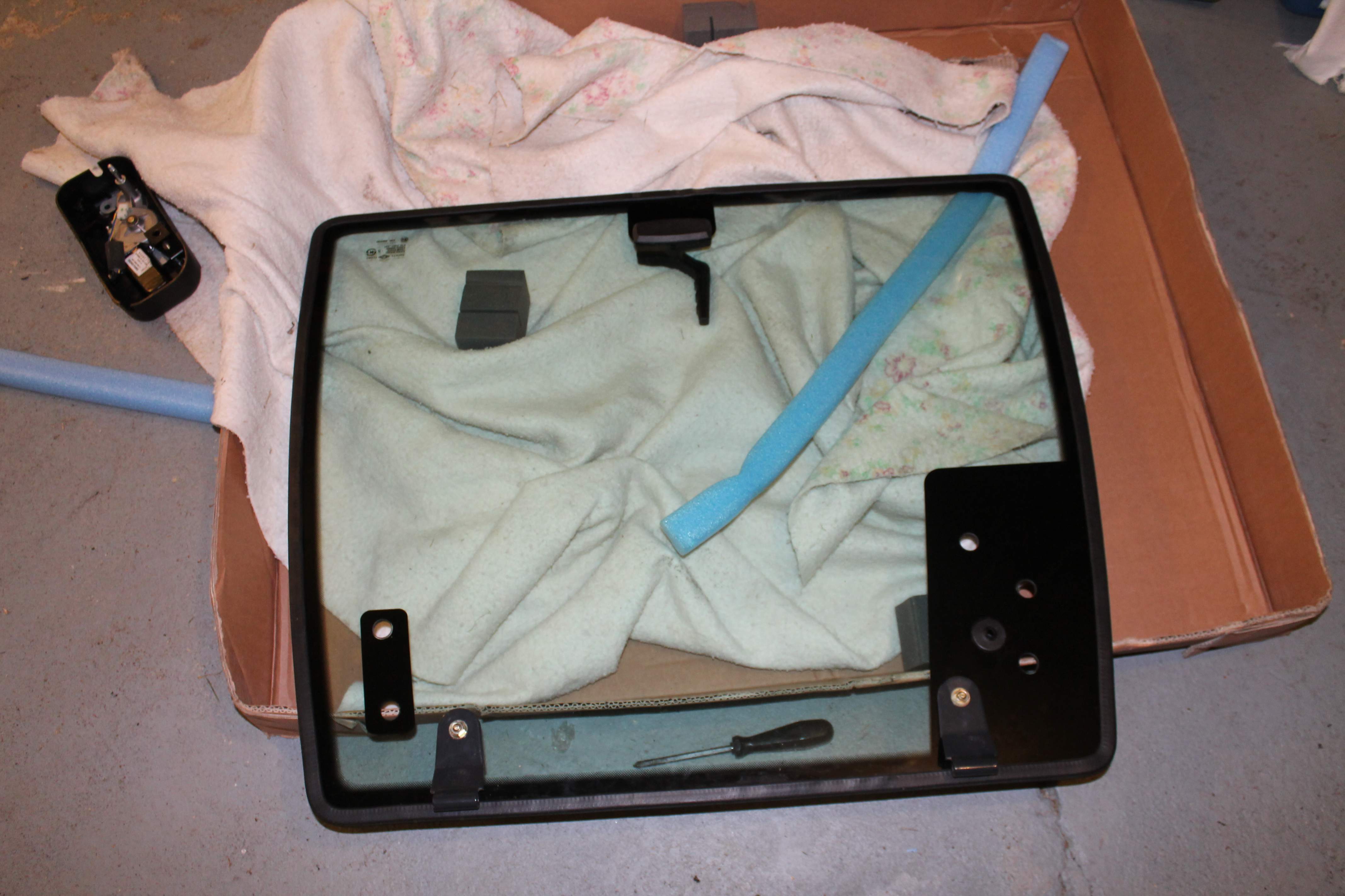

If you notice I don't have my back window in place. I broke it about a month ago when I borrowed my neighbor's hay rake. After I had it hooked up to the 3 pt hitch the housing of the rake was higher than I expected and when I raised it it bumped the bottom of the frame under the window and it exploded. Well $336 later. I can say the window would be very easy to remove to get at the back wiring it didn't take very long to do the installation. For those who might be interested it's just a matter of unplugging the wiper motor, pull the washer hose off the outside pull the grommet that goes with it, the cylinder lever just pops off the little pivot ball on the right hand side by the seat and the 2 outside hinges have slide bolts with a tiny push/pull clip on each one (be careful not to drop one I had a job trying to find it). It was a nice weekend project. Now the backup camera installation, should be a little easier without the back window.
