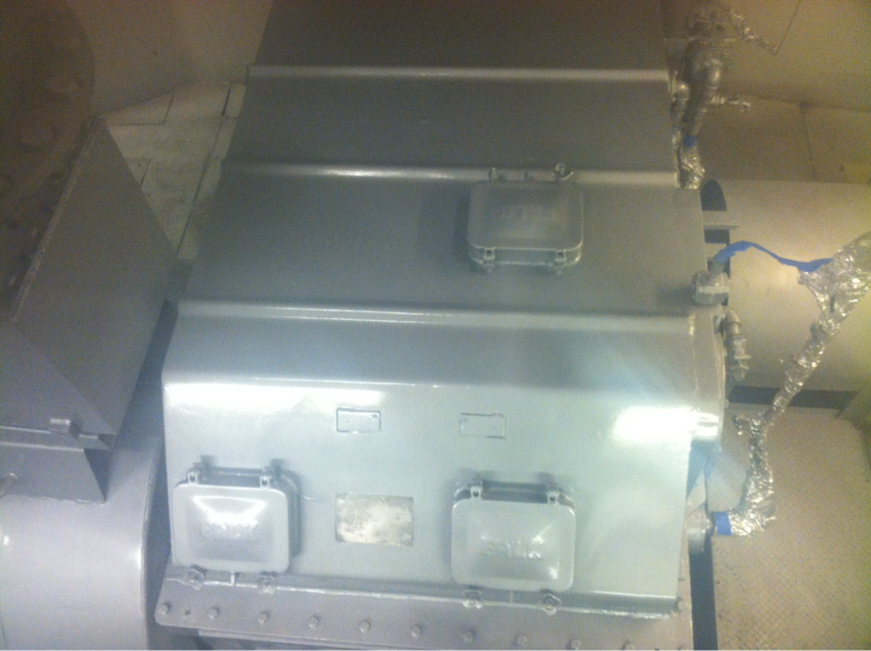

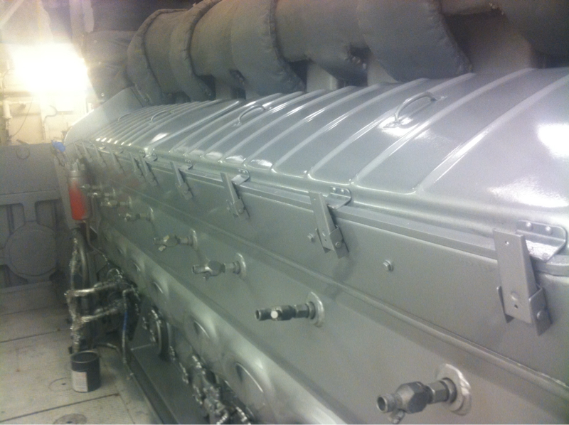

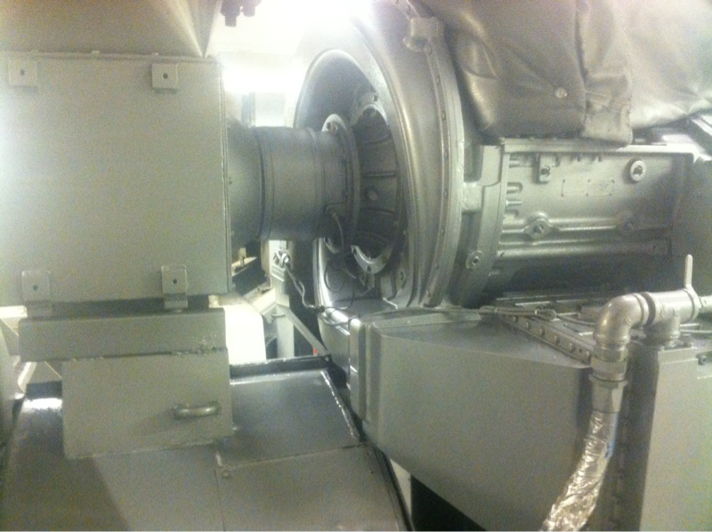

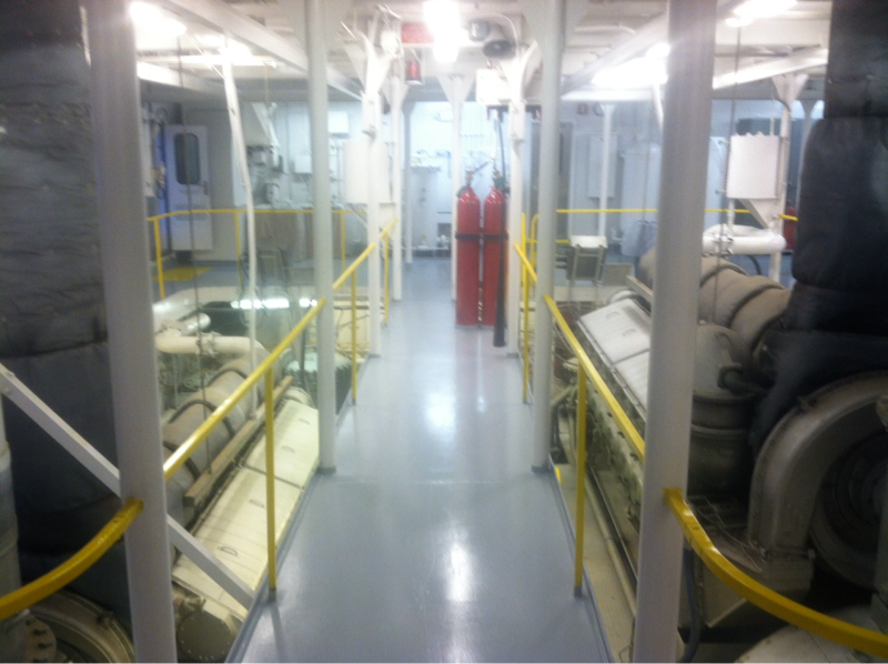

I spray indoors here on te vessel I'm chief engineer on. I would take the suggestions as others have mentioned about brushing the frames and taking the doors out to spray. You can spray indoor with precautions, plenty of ventilation, a respirator, tape off an cover anything and every thing you don't want sprayed. Of you have expirence spraying you can turn your gun down and an spray it helps with the overspray. Here are a few pics of the engine room I run chief on. LUTT
