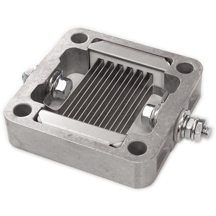

The same air intake electric wire heaters have been around since the late 70s on the Mitsubishi, Shabarura, Kubota and Yanmar machines. It's typically found on the higher pricey models.
The Mitsubishi tractors have a button to press for cold starting. Then it runs thru a relay timer for about 6 mins. The device fails at times and the aftermarket offers the Hella brand as a replacement.
Here's the Yanmar / John Deere / Cub Cadet version.
Some of the housings look like this . . .
AIR INTAKE HEATER JD 3TNV84 M801118
   / Air intake grid heater
I understand that, but it doesn't help explain how, on this particular tractor model/series, does the operator activate it when attempting a cold start. That's what I'm after here. Not so much the concept of grid heaters on tractors in general.

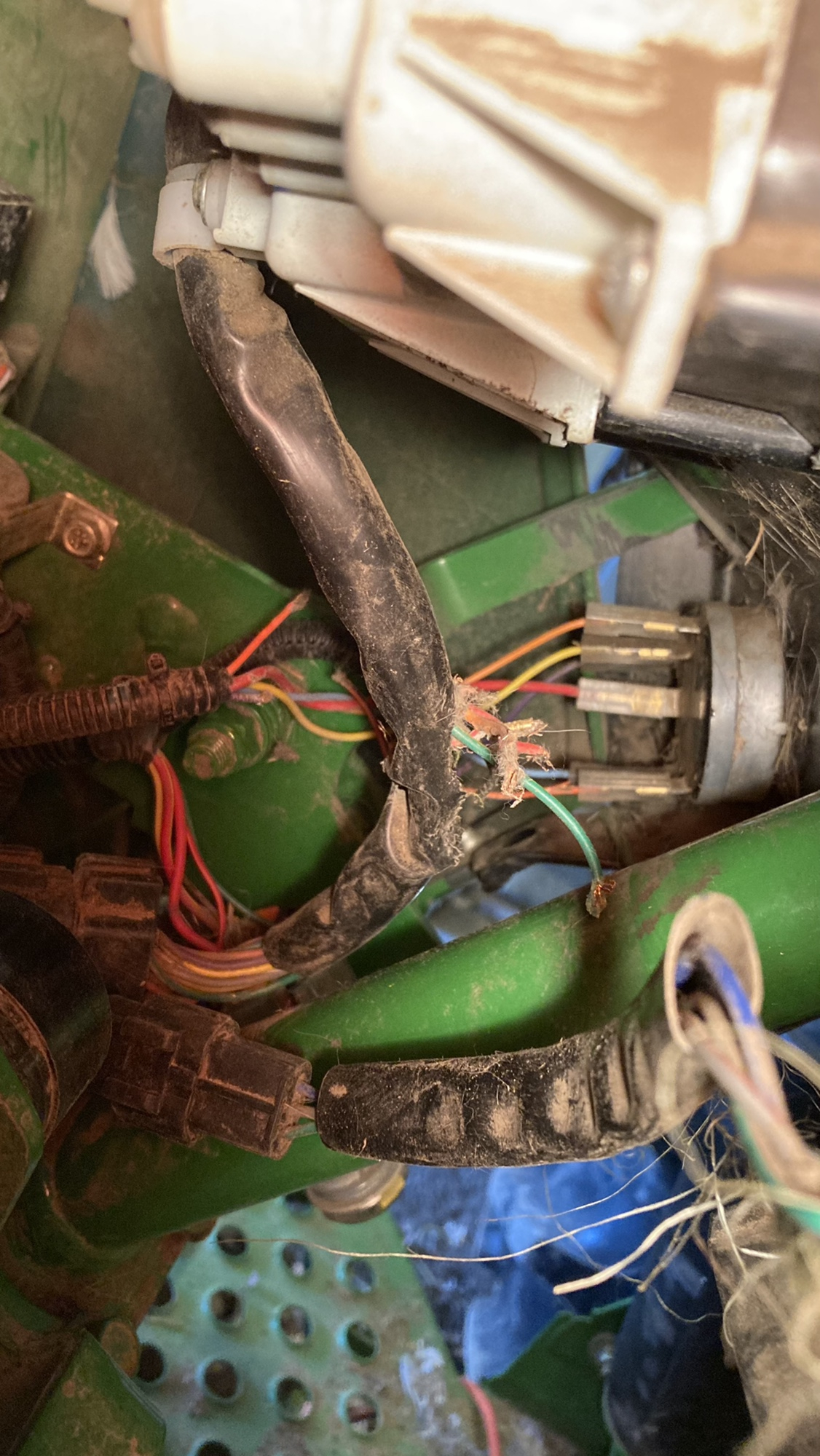

   / Air intake grid heater #8
The terminals of the key switch can be seen at the right in photo.
There’s a terminal that comes off the side of the switch. Not sure, but I’d check if that one changes status with the key pushed.
#9
The information I have states the signal wire from the key switch is labeled 385 green on the wiring diagram. I hope to get out there tomorrow and hopefully get something accomplished.
