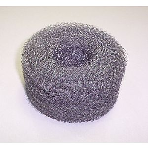

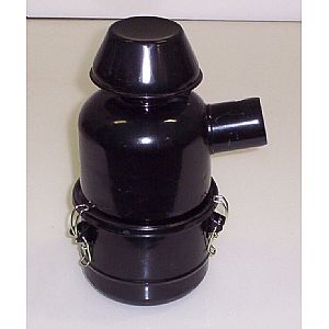

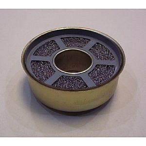

Many thanks for the advice. I went onto the FarmPro site as per Greg's suggestion. The attached pics are what I currently have. I don't tend to be in a dusty area but obviously get a bit of stuff flying around when cutting pastures.
With clean elements and some oil in the bath will this work ok?
Thanks
Mark

Oil bath is fine. All the Ford 8n's, 2n's, 9n,s, 800's 900,s and many more have used them for 60+ years. I would not reinvent the wheel. Just use it as designed.
Chris
