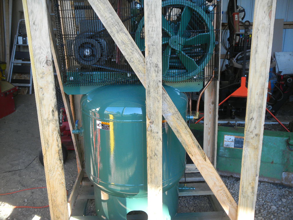

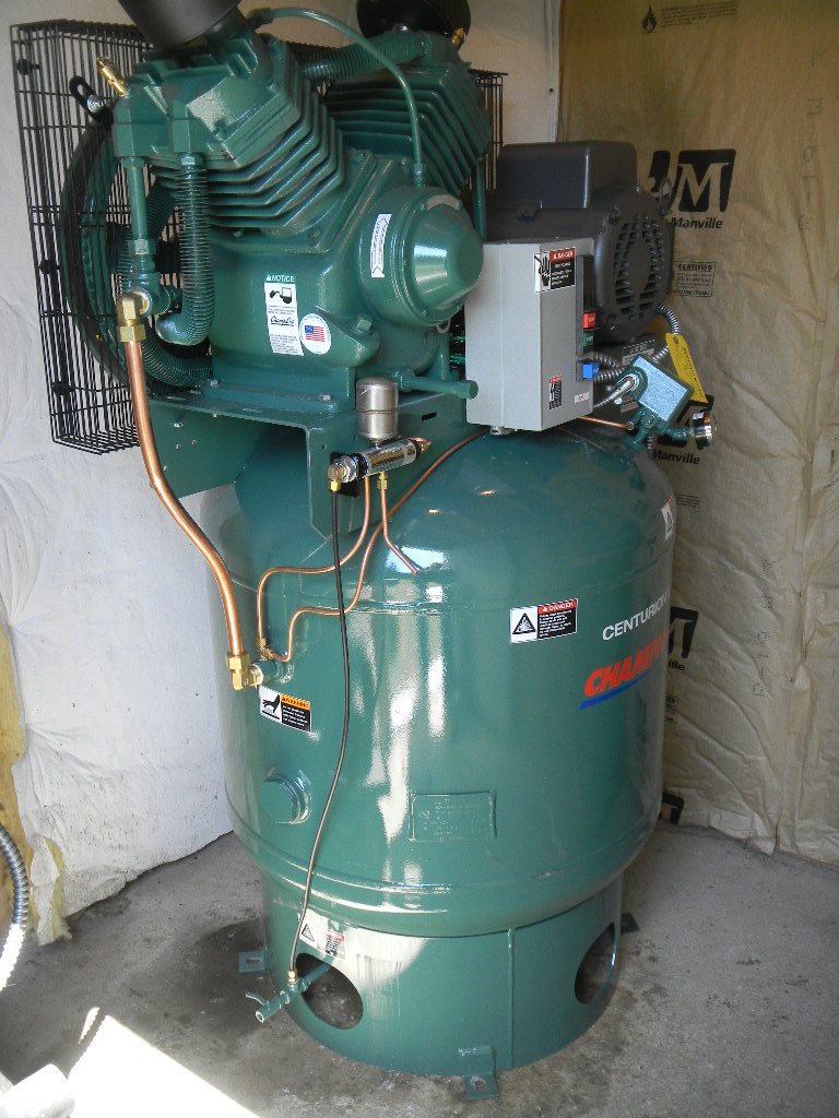

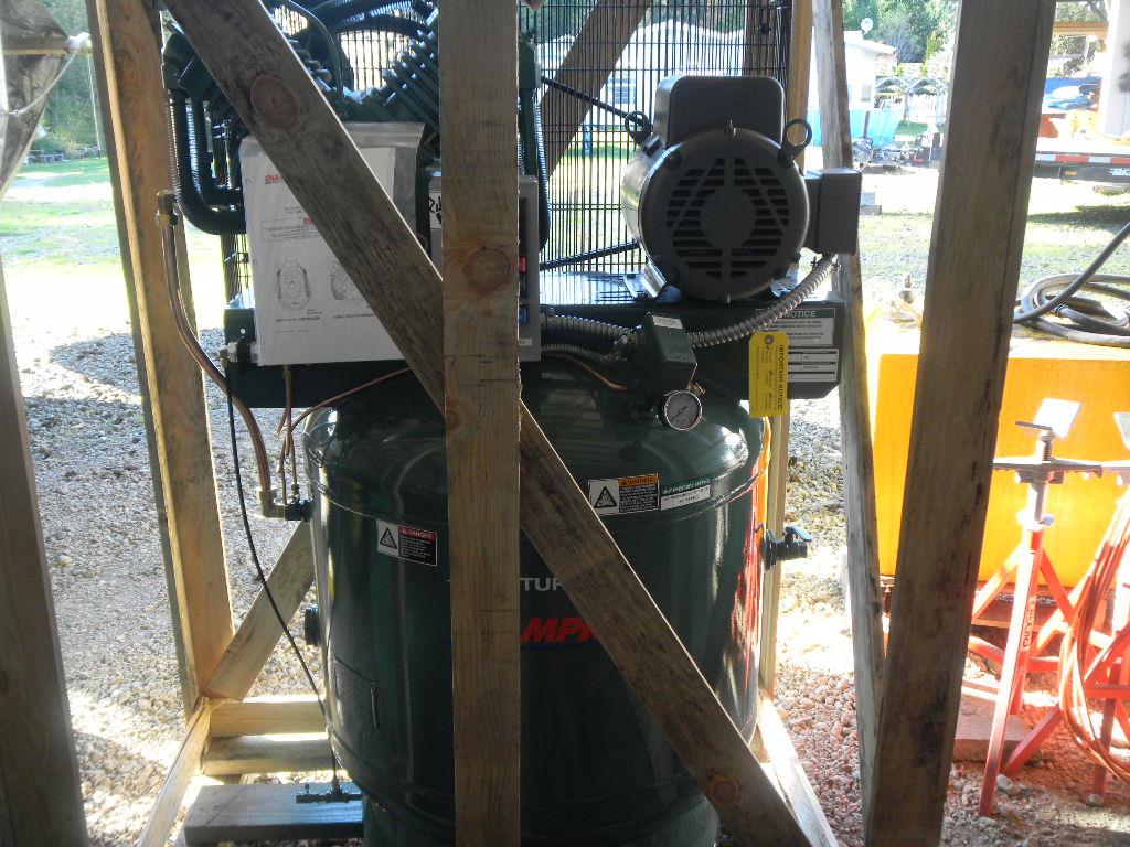

   / Air Compressor #6

   / Air Compressor #7
You last two posters bought nice compressors, but for most farm and home use, those are just too expensive for many of us. When I lived out in the country, and was also in the business of repairing/rebuilding mechanics' air tools, I had the Puma PK6060V and it was actually all I ever needed. But I bought mine from a place that also built and sold their own bigger compressors. Northern Tool didn't have the Puma at that time. And then about 8 years ago, back in town, I bought this Industrial Air by Powermate Compressor from Northern Tool and now they no longer sell this one.:laughing:

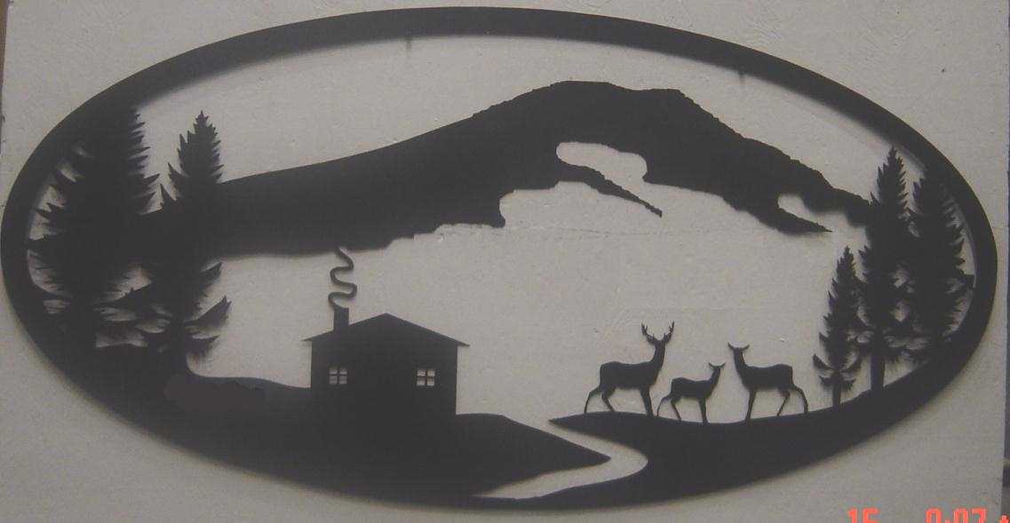

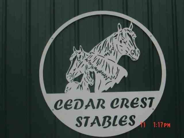

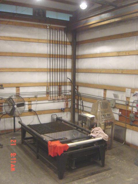

Hopefully that's the last compressor I ever buy! I have a small compressor for airing up tires, nail gun, etc, etc. This compressor is mostly for the plasma cutter, and CNC machine. Which I don't hardly ever use.
