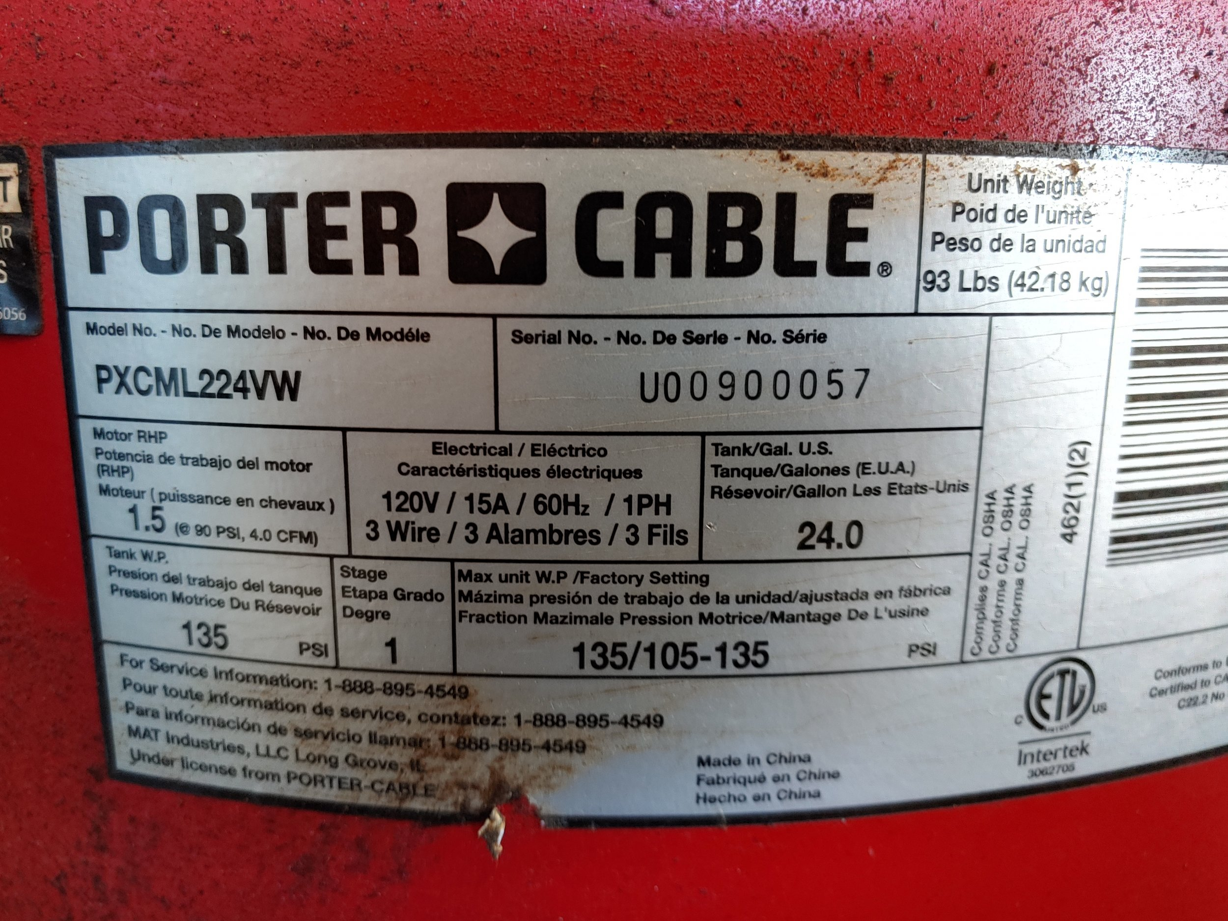

Bought used a couple years ago, my Porter Cable 24gal air compressor decides to quit working. I know little about air compressors but can fix most things if I am told what I need and what to do.
Power is good, but makes only a humming sound when powered on. I have confirmed it is not an electrical issue from the breaker or plug.

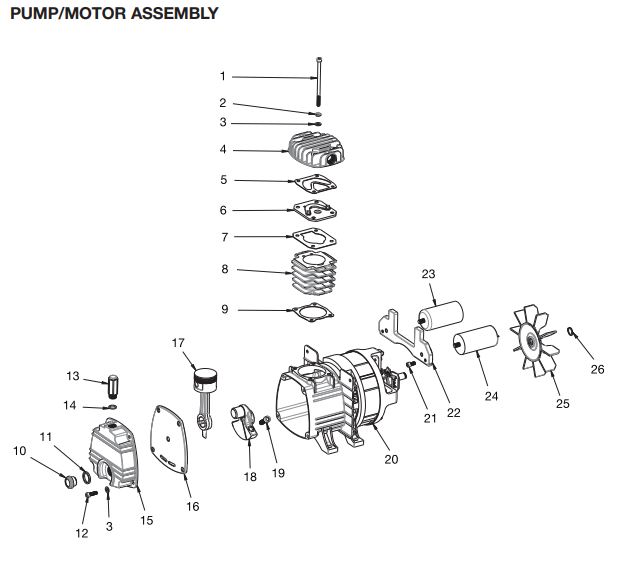

Same thing happened to mine. I took the start capacitor off and googled the numbers on it and bought one from Amazon for about $10 to $15. Worked fine.
Jeff
   / Air compressor quit #9
Item 23 in your parts book.
