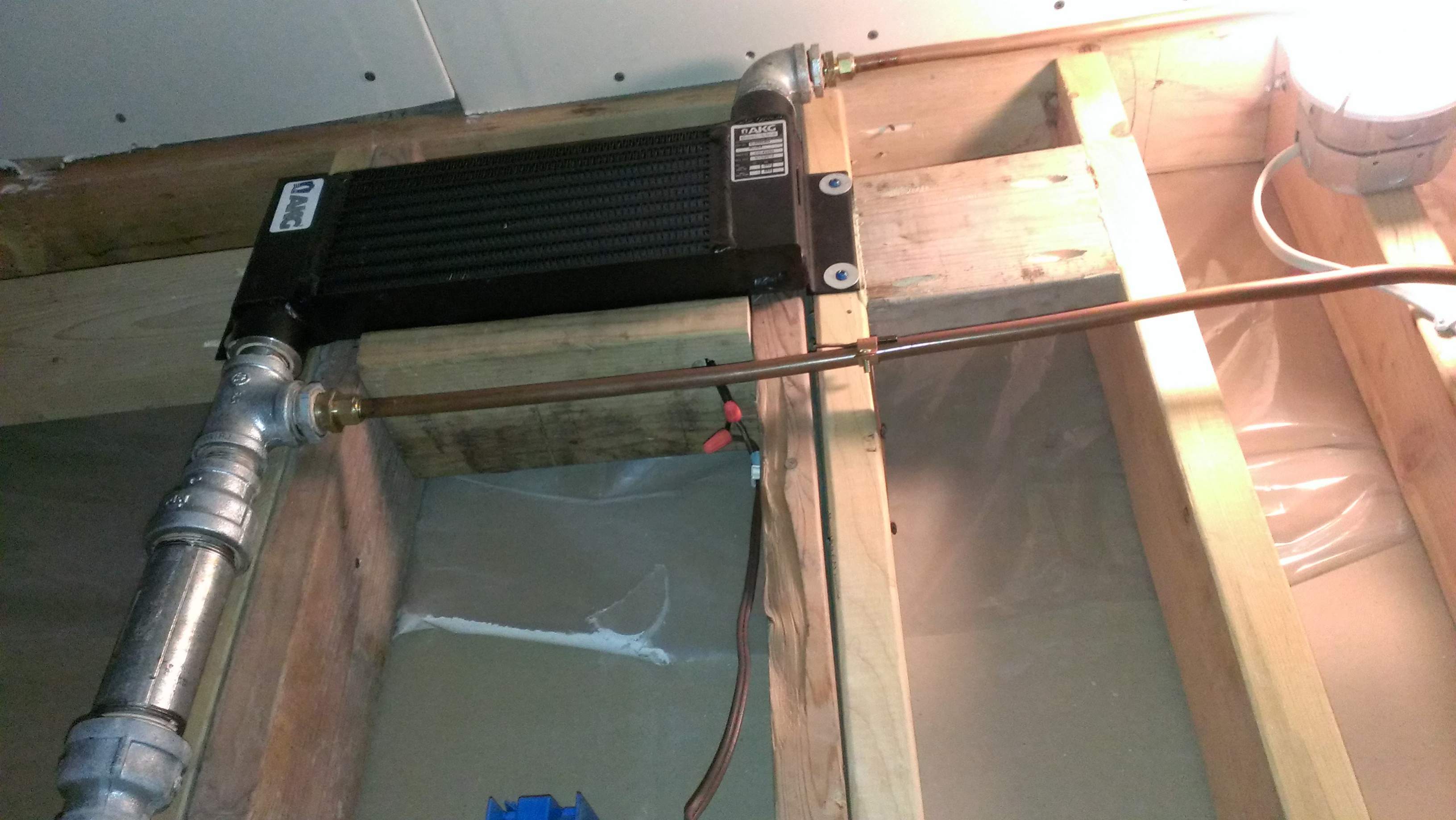

The issue we were having is we were getting way to much water in the air for our bead blaster. I you look for a good drier costs upwards of $1000, which is more than we paid for the compressor. So what we did is put an after cooler between the compressor and tank. The air temp out is 220 and after the cooler it is 100. Most of the water condenses right there never makes it to the tank. Then we use a cost effective desicent drier right at the blaster works slick.
came from Zoro tools.
Air Cooled Aftercooler by AKG - Air and Water Aftercoolers by Zoro Tools Industrial Supplies
we then put two muffen fans behind it that turn on with the compressor.
Steve

sounds like a great idea. Are you an HVAC tech in real life? :)

or just use several lengths of heavy 1/2" copper pipe vertically floor to ceiling ( think of a compressed snake outline) with a water drain at the bottom of one of the loops ...
or go to the wreckers and get a bunch of power steering / transmission coolers ( use on smaller compressors ) and mount so air flows up thru them ....

This is a great idea that does not look really rigged. Worth it.
Another thought to consider: Air in the tank is at 100 percent relative humidity. If you install a regulator at the tank and drop the pressure then the volume increases and the relative humidity will drop below 100 percent. You
I use 3/4" PEX tubing for my air lines, which are all indoors and not in sunlight. Works fantastic.
