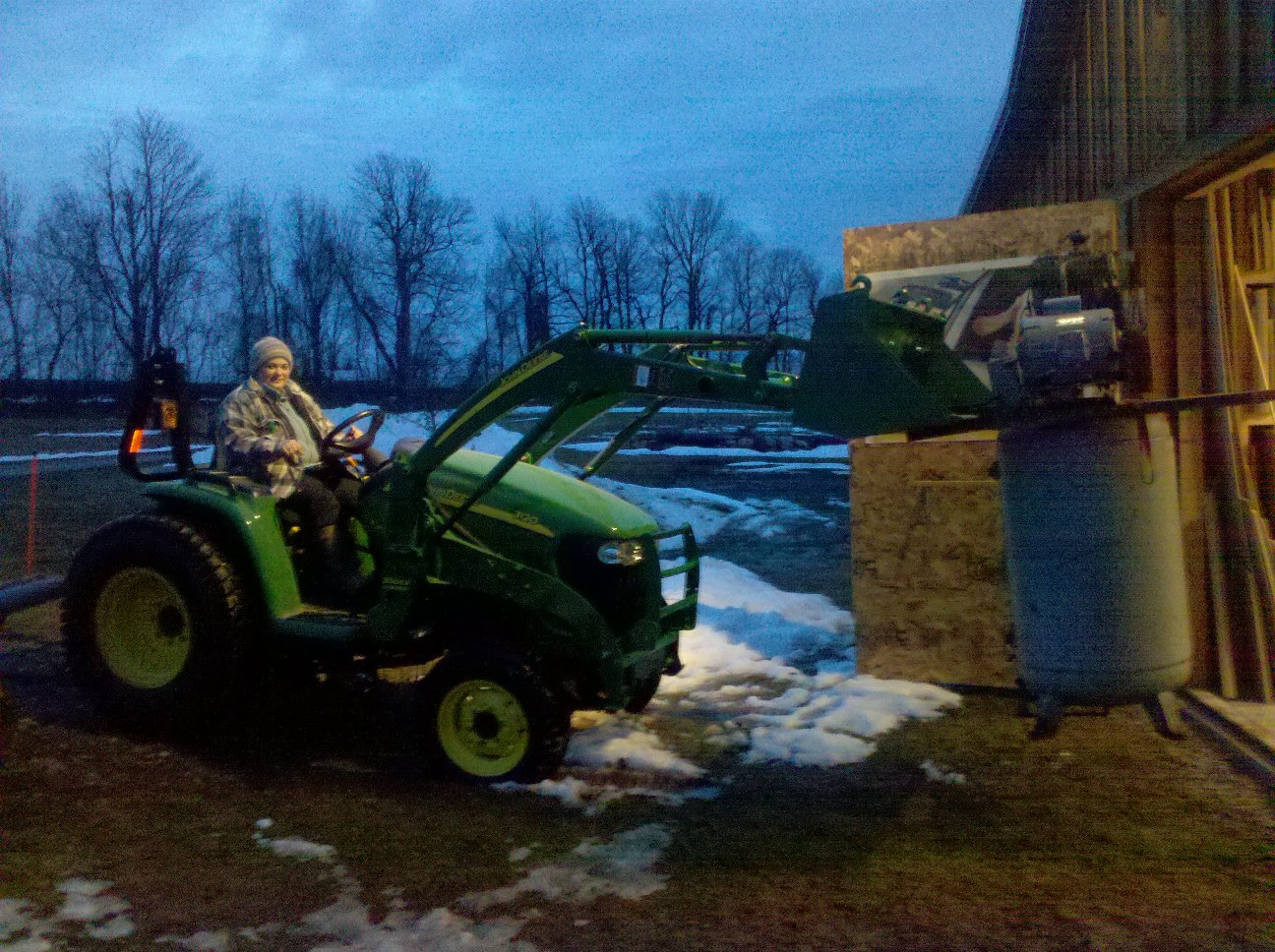

Thanks to everyone for the advice. I did purchase the Quincy. It's a 1968, QR-25, model 325 pump on a Gilbarco tank (need to measure, looks to be 80 - 100 gallon). It looks to be in good shape, wired it up, turned it on, found it leaked at the drain on the bottom. Looked closer, it has an auto drain plumbed in, with a couple of shutoff valves, and other misc fittings. One of the fittings was cracked (I may have done it when moving it). Running today to get a couple of new fittings, and do a full pressure test. Have to admit, running it up to 175 psi on that big of a tank for the first time has me a little nervous.
Assuming all goes well, next decision will be whether to take it apart and paint it, or use it as is. We'll see, I really don't need another project, but it would be a fun exercise. If I pull it apart, I'll probably go through the valves and what not to ensure everything is up to snuff while I'm at it.
It does sound sweet - thumpa, thumpa, thumpa at 380 rpm's!
Here's a quick pic of the wife on the tractor bringing it into the shop. I'll get some better pics and post them as I have a question about the single unloader tower (every other QR-25 I have seen has two).
Thanks again.
Jon
