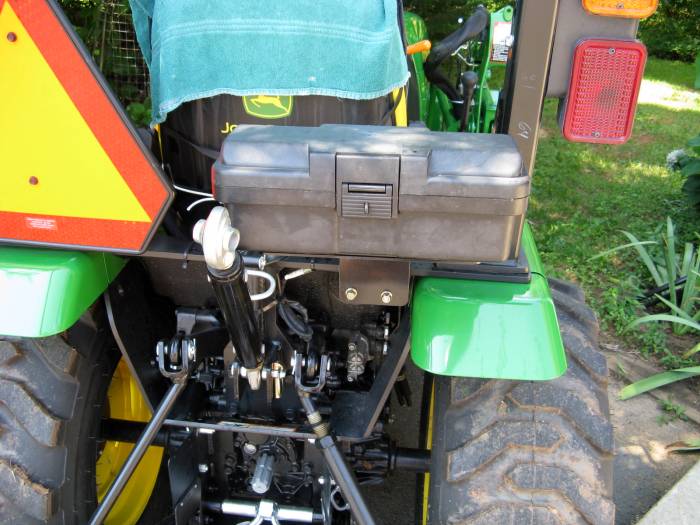

Sales person put my 1025 toolbox onto the 2025. Only trouble is that it blocks the hook on the top link.

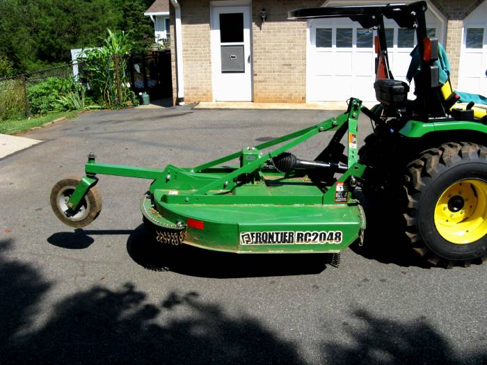

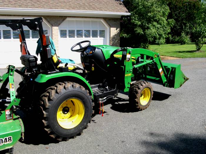

Here are the pics. Tractor came yesterday, but sales person didn't get my new push button power shaft until today. He had it cut it down, and I went and got it.

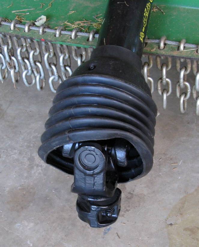

The push button on this one needs to be flatter and bigger. It is on the power shaft to my chipper/shredder. Still, easier than the collar type I had before. Think I may be able to push the button with a clamp to hold it. Couldn't do that with the collar type.
This is a more modern version of my old JD 4010, or a 4010 with more hp and improvements. Didn't need the hp, but the improvements are nice.
The sales person moved the toolbox from the 1025 to the 2025.
The bush hog doesn't lift very high with the standard 2025 settings on the 3ph. There are 3 lift holes in the vertical lift members and 3 holes in the horizontal lift arms. Looks as though I need to move to a higher hole in the vertical arms. This lift height on the bush hog is what was the case on the 4010, but it had no adjustments. One could tighten the top link to get it higher for travel with it up.
Ralph

Discovered that moving the pin in the vertical member of the 3ph to the topmost hole makes the hitch control almost exact. The "2" on it now means that the Frontier bush hog is 2" off the ground in the front.

Before you get to far into raising and lowering the rotary cutter may I suggest you watch this video https://www.youtube.com/watch?v=0vBFJcvs5SE on how to measure and cut a PTO shaft, then measure your system and see if the length of yours is correct. Also if you shorten the top link it will raise the rotary cutter.

The bush hog works on the factory setting of the 3ph, but there isn't much lift, and it rides somewhere about mid point or higher on the position control in mowing position. A more ideal setting is to use the top hole in the vertical 3ph member. Lift is rather high, and "2" on the position control is almost exactly 2" off the ground. This is with my Frontier RC 2048 lift pins in the lower position. (My 4010 was delivered with its LX-4 bush hog lift pins in the upper position. This didn't work because of simple geometry. Lifting the LX-4 would drive the tail wheel into the ground because the top link was too long.)
HOWEVER, I had to reset the vertical 3ph member back to the middle hole to attach my carryall. So, I replaced the factory cotter pins with quick pull pins. There's no higher hole on the carryall to move the lift pins to.
Attaching my MacKissic TPH-122 chipper/shredder worked fine with the 3ph vertical member in the middle hole. It may attach with it in the upper holes, too. However, the turnbuckles that tighten the lift arm swing are just short enough to slide the lift arms onto the Mac's category 0 lift pins.
