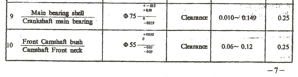

I have removed my oil pan and a crank cap , does anyone know the clearances for the main and rod bearing .if I get the plasti gauge which size should I get .
   / Agracat 2940 Y385 motor #8
Oil does come out of the oil sending unit , but you attach the manual line and it will barely fill the line..........
I wouldn't expect the line to fill with oil because of the trapped air. However, you can bleed off the air by loosening the fitting at the gauge.
Use the red Plastigage.
#9
Do you know the spec on clearances, for the main and rod bearings, thanks
   / Agracat 2940 Y385 motor #10
Not specifically, but I think you can use this as a guide. Convert cm to inch.
