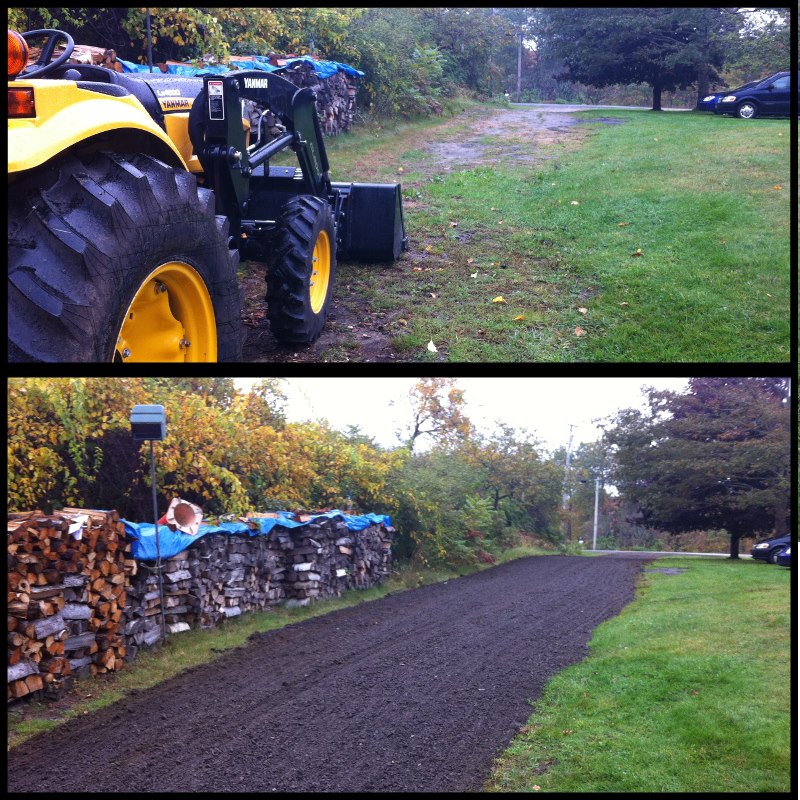

This was my first and only customer, my Mom's driveway. Bear in mind I'm not a professional and I was pretty new at box blade-ing, but Mom was happy!
   / AG Tires VS Industrial Tires for Driveway Grading/Box Scraping Compaction Advice? #8
(Several dump truck loads of crushed concrete was delivered and spread with the box blade)

Katahdin - It CAN'T be done any better than you did!!! You DEFINITELY have the touch.
