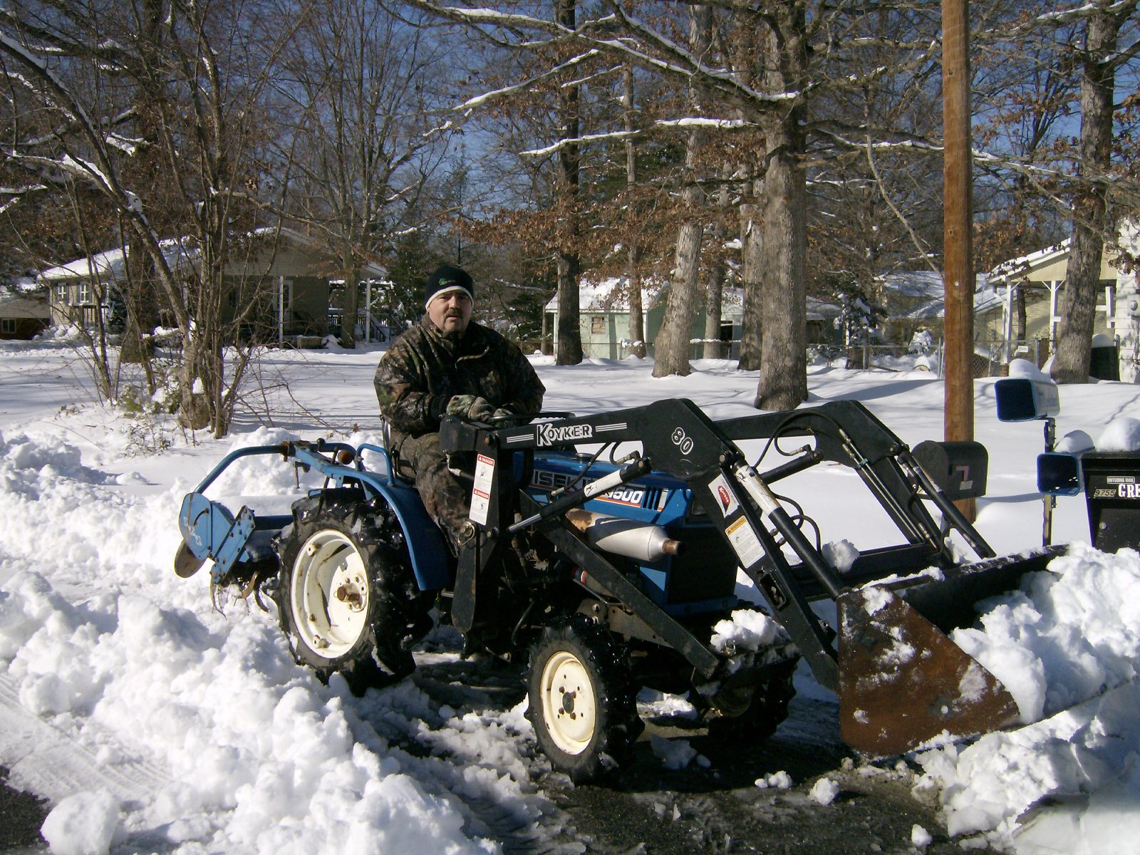

Me and my TX-1500 in a little snow!
While I do have the rice pattie tires and a FEL, it did ok!

from my last experience in the snow with my R1 ag tires, either get R1s with chains or just get chains for the R3s. I have heard the R3s are better in the snow with chains since they have more surface contact that the paddle R1s do and also have more tread contact with the ground.
