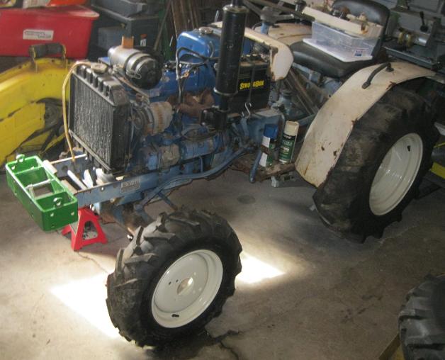

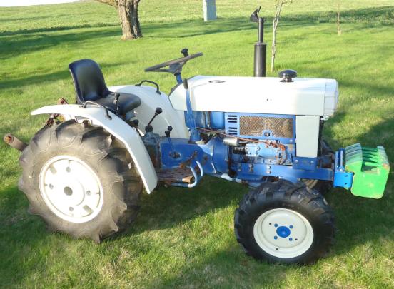

You will likely need 8-16 rear tires. They are available new, but not cheap. You see them used once in a while.

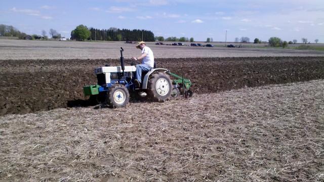

I put 9.5-16 Firestones on my S373D, got them used, work good. Had to match the right front tire diameter since mine is 4wd. I use my tractor to pull a 16" plow and needs bar tires, 4 wheel drive and the wheel weights to do it.
The diamond tread turf tires are pretty worhtless in the snow, not that you have any, but for others reading this. WIth chains that would be better, but they just fill up and become slicks in snow.
