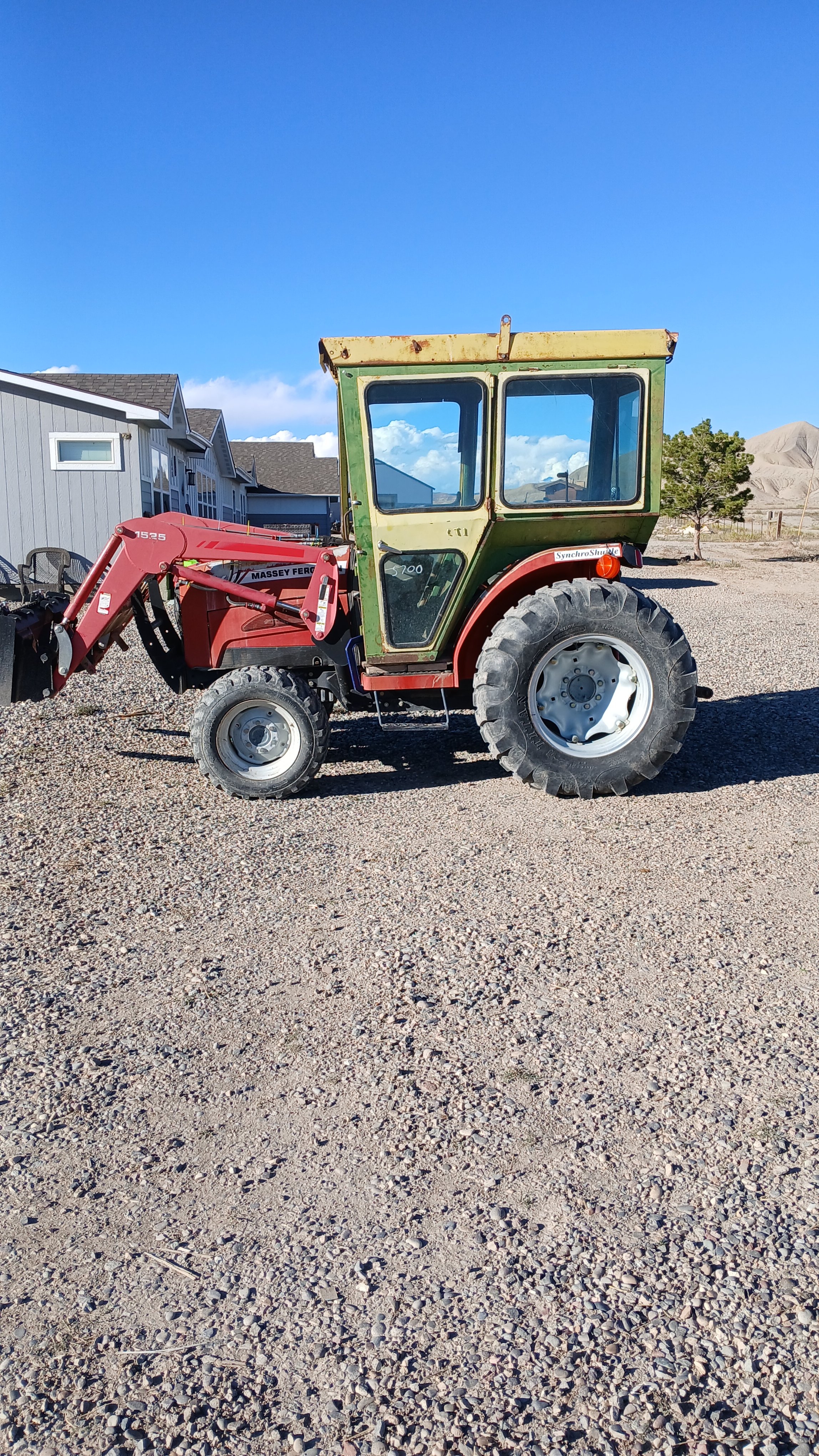

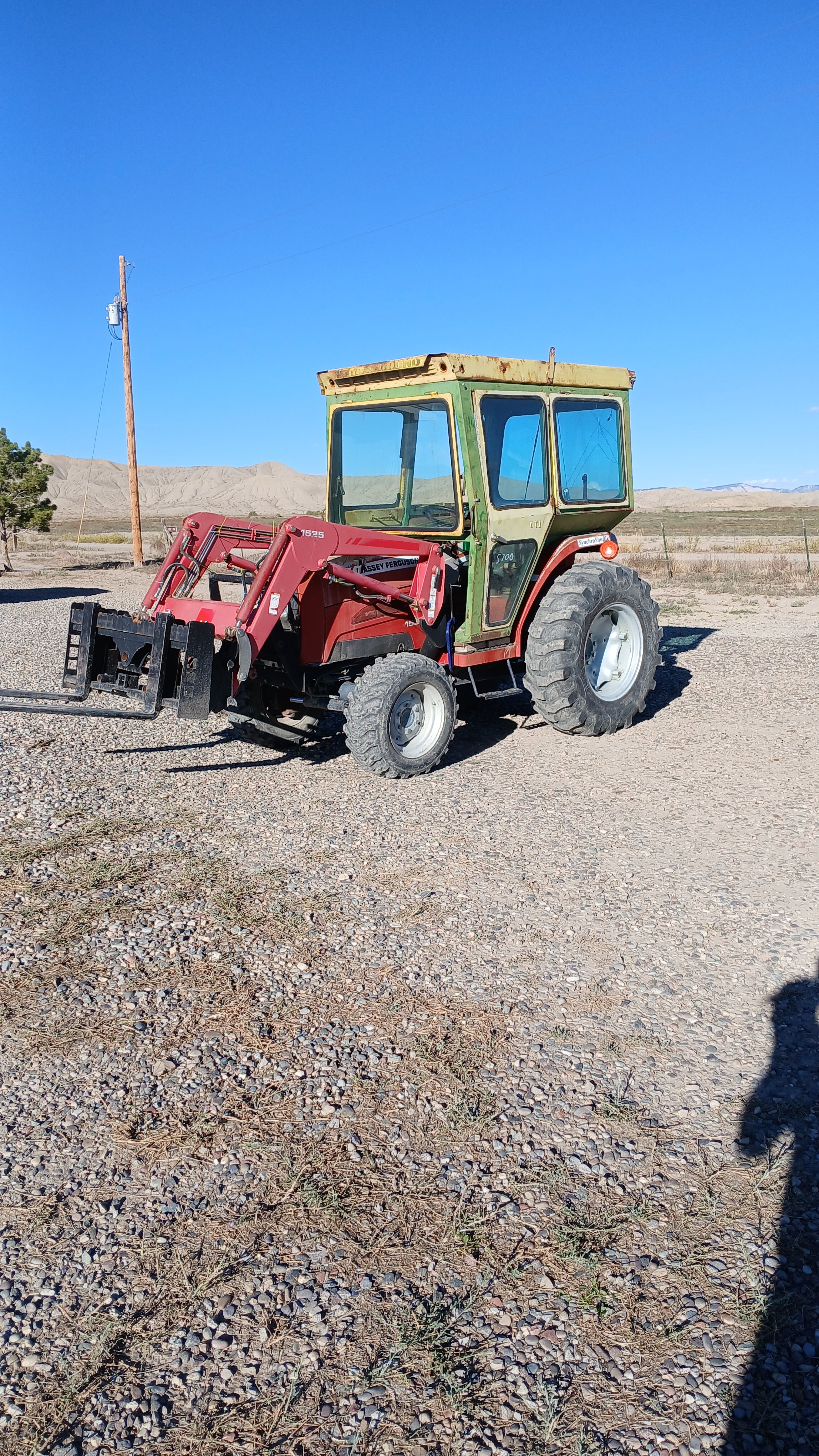

I'm grafting a 1980s Year-A-Round cab on a 2013 Massey and I'm needing to add a heater for the winter. What have yall used for aftermarket heaters? I've already got the heater core and some random parts to make a normal "radiator coolant" style heater but I'm just wondering if maybe a diesel 12V heater would be better because it'll get hot much faster than waiting for the radiator to heat up when its -20 and I can turn it on via Bluetooth. Or maybe something I'm unaware of?? Thanks everyone
Just because I'm sure you're curious here's pics of the project.

Negative 20F sucks, no way around that.
Your right that your engine might never warm up enough to heat the cab well, (your car most likely takes 30 minutes plus to warm the cab up at that temp too if left outside). A diesel powered heater might be the best way to warm you up.
Is the tractor stored outside? If not then I am not sure I would want a diesel heater running in a building. I would be inclined to put a basic space heater in the cab to prewarm it. If parked outside then a diesel heater might be the best option. Another though would be to use a diesel engine preheater, they are like a diesel heater but heat the coolent. This lets the engine start easier and your will already have warm coolant for your cab heater.
I have not messed with diesel heaters, or diesel engine preheaters. However when I was in Minnesota it sure sucked starting equipment. A couple hours on the block heater, then put a battery charger on fast charge for 15 minutes, switch the charger to boost, and hoped it would start. I was never lucky enough to have a warm cab, sure would have been nice. On equipment with cabs, 40 or so minutes in and it would blow warm air. Not enough to melt the snow on the boots, but it would help defrost the windows. Keep us posted on your progress.
