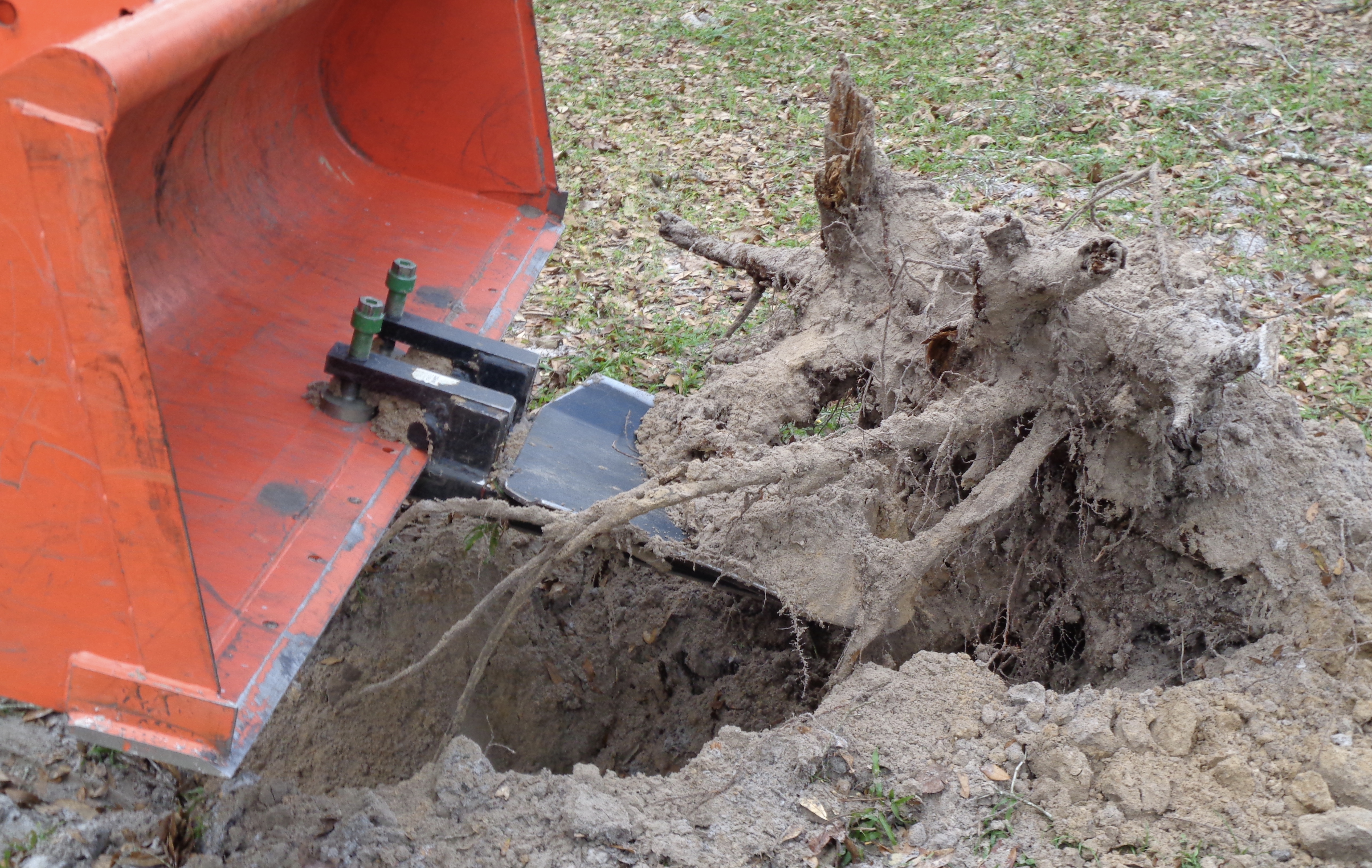

Your MF 2860 (4,400 pounds bare tractor weight ) is a good candidate for a $400 bucket spade.
VENDERS:
tractor bucket spade
Will a $400 bucket spade fulfill your need, preserving $6,600 of your money?
I use the tractor with a rotary cutter quite a lot as well as a rear blade in the winter.
A bucket spade is much faster to mount and dismount while your Three Point Hitch remains available. Bucket spade can be stored in any corner of your barn or garage.
