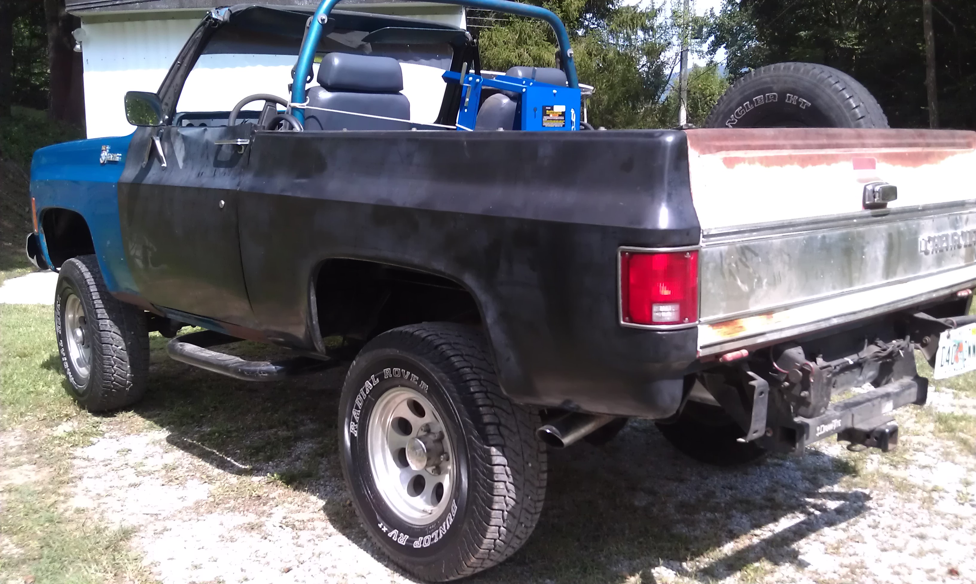

Guys,
My old trusty '75 Blazer had some serious rust....rear quarter panels, doors, tailgate...... I ordered new replacement doors and quarters from LMC Truck. The TAILGATE was located in a salvage yard in Nevada (no rust)
The REPLACEMENT panels/doors are extremely THIN, so thin that a firm THUMB would make a dent. You can see a dent on the drivers door top just from pulling the door closed by the top....Not much I can do for the doors 'cause there is a windup glass inside.
I'm thinking about adding "tubes" of steel, (pipes?) between the outer skin and the inner panel of the QUARTER panels. That would transfer an external blow to the tube and onto the inner panel making to much less susceptible to a dent..........or so my devious mind thinks.
Anyone have any suggestions.....before I spend money for the paint job?

I wonder if you can add fiber reinforced fiber glass to the backside of the panels
   / After- Market Body Panels..... Any BODY men there? #3
That is a fact of life. The skins are all thin now to save cost,and to improve fuel mileage. My old pick up trucks you could bounce firewood off the sides when loading and no damage done. you could put a 2x6 on the tailgate and ride your motorcycle into the truck bed. No longer. If I was doing it I would lay chopped fiberglass mat full of resin,and back that up with a door panel insert made out of another old door or car hood. Rustproof as needed. Looked at the pictures and it looks like a very nice unit in the making. Congrats.

I was shocked, DT.......The inner door panels are not installed yet....I wanted to paint the doors to match the truck BEFORE I put the panels back on (window winders, armrests, speakers etc) so I had been guilty of just pulling the door closed by grasping the top center of the door......as you can see, it's too thin. I thought and thought about how to strengthen that section.....a rod run fore and aft on the inside, an additional metal angle welded and smoothed with bondo on the outside, etc......none of my ideas are good. bummer
