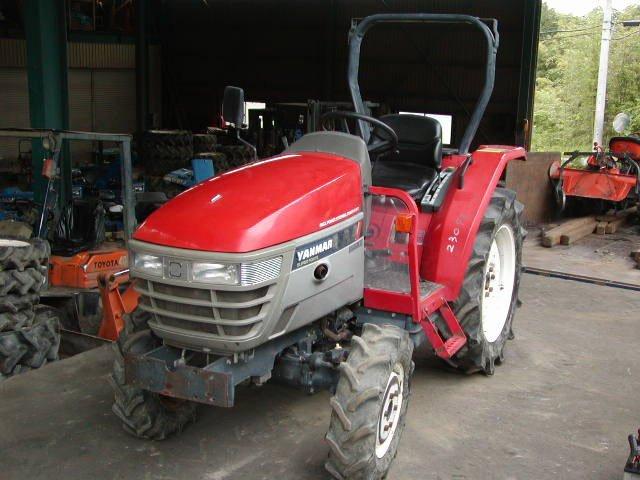

I have a reputable importer getting me a AF33F Super Forte, fitted with new loader. What does the F mean, I have only seen D on net. It is the first of this model he has imported. It is for a small vineyard and clearing small timber. How do I find its age? Are parts more difficult for newer model? What model was it's predecesser and is it similar. Any comments on this model. Is it better than Iseki TK33 which I was looking for?
Where can I get an English operators manual for this model?

and sorry, I know very little about the AF series tractors. Someone should correct me if I'm wrong but the Yanmar gray market series tractors start with the YM, then the F, FX, Ke and the latest or newer models are the AF series which are around 1996 and newer.
Knowing the exact age of gray market Yanmar tractors isn't commonly known on the newer models and I'd think your reputable dealer should have an approximate year. He should also be able to supply you with regular maintenance items (fuel, oil, air and hydraulic filters) and have a well established connection in Japan should you need something of a more serious nature. Even then it may take weeks to acquire and ship. Which doesn't happen too often with the earlier models as they are well stocked and readily available by dealers here... Will your dealer offer a warranty?
I believe the loader is probably a Kanzaki model and it should work well in your vineyard. I have a picture of an AF24 (D) and would assume the AF33 is a bit larger. Hope others here have more to offer and here's a picture of the AF24 just in case you don't know what they look like - Good luck. ---:

Operators manual is not available nor is a maintenance manual. Parts manuals are available though but are quite expensive. The AF model was a new design and didn稚 follow any prior model lineup. The offshoot low budget model was the US30D and US33D. The AF series was replaced by the Eco friendly RS series. The EF and EG series replaced the RS.
F denotes field version vs. rice version. The RS33D would be a better model for your vineyard since it has the option to go much narrower if desired.
Should have 88 degree power steering with selectable double speed front axle. Don稚 use the double speed with the loader attached it will destroy itself and be wicked dangerous to boot.
It will have a 5 speed PTO with one reverse gear. Auto level, auto raise and quick raise 3 point.
All parts are available but most non consumables will have to come from Japan.
