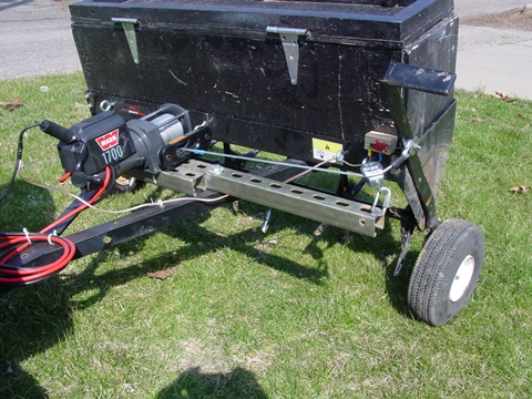

I'm 70 years old and am tired of having to get off my tractor and raise the plug tines onto the wheels every time I get to a sidewalk or drive and if you need to back up. I received a Warn 1700 winch for Christmas and today the weather was 60 degrees so I went and played with the Brinly 40 inch aerator I have been using for over 10 years. I chose the Warn 1700 as it had the fastest line speed at 7 ft a minute. In the pictures you will see the power cables are a little short but work. Before spring I will add cable under the tractor and probably a plug by the hitch. The remote is great, power in and out. I may add 2 switches and a relay so I can just press up and release and it will go all the way up and stop when it reaches a switch, same for down. I left out the construction details as the pictures should be good enough if you want do build one.
I also built a weight box on the aerator which is bolted to the aerator. It is wood construction and water tight with a hinged top and has baffles to keep the water from sloshing around. Just add or remove water for the weight needed. Full it is about 30 gal, over 200 pounds.
Aerator 1.JPG Click for video [video]http://home.roadrunner.com/~rblapham/Aerator.wmv[/video]

I've decided since small adjustments are needed besides being able to lift I'm going to go with a 12 V linear actuator. That'll make small adjustments easier and I can just mount it inline with the lever.
The less expensive ones (< $100) are not water proof but just install with quick release pins and put it in the shop when not in use.
The water proof ones like on electric gates and such are a bit more $$.
   / Aerator lift using winch
I always dump the water out at the end of a day of use so no freezing:) Just tip it backwards to empty, was going to put a drain on it, but too easy to just tip.
I thought about using a actuator also, but so many to choose from it was impossible to figure out which one I needed. The winch can be moved for other purposes very easily another reason I chose it. A bit more than I wanted to spend at $100, there were several at $50 but liked the Warn.

OK spring has arrived, time to aerate. Updated the setup with the winch. Added a plug to connect the power to the tractor and quick disconnect -- see picture. I also added a limit switch using a switch I had laying around. I ordered a limit switch for $7 which has a spring actuator and is water proof and should last longer. I also moved the winch cable down to about half way on the lift handle for quicker movement. In the updated video at the end see holding the "Up" button and the limit switch stops it. May also add a "Down" limit switch later. Aerated 4 yards so far and worked great.
Video was taken with water in the weight box. [video]http://home.roadrunner.com/~rblapham/Aerator.wmv[/video]
#9
By the way I used 12 gauge 3 wire stranded extension cord (about 6 ft) to wire from the tractor battery to the plug at back of tractor (used 2 of the 3 wires). Original winch cable is 12 gauge and with the light load in this application it is plenty big enough. The wire and switch for the limit doesn’t need to be very big, I think I am using a 5 amp switch and 16 gauge stranded wire which is plenty as the switch like the remote just operates a relay in the winch not the full power. The 3 wires of the remote are a 1) common and 2) up and 3) down – easy to figure out which is which. I hooked the up limit switch in series with the up wire to the remote.
