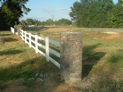

I'm working on my entrance and have built some columns. I've wrapped them in fake rock and now I want to cap them.
I can buy concrete pyramid style caps for $150 each. I need four of them, so $600. This is more than I feel they are worth, so I'm gonna make my own.
I figure some 3/4 plywood and 2X6's should do the job. Then I'll line the form with a yet unknow material so the concrete will release easily. Then I will pour a high grade of sack concrete from Lowes into the form with some wire to hold it all together.
This all seems pretty straight forward and within my abilities.
I would prefer the cap have a darker color to it, even almost black. I don't want to paint it, and prefer a stain or even better, something I can add to the mix while mixing.
Any ideas?

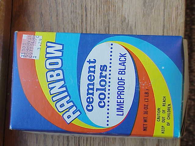

/ Advise on coloring concrete #4
I colored the mortar black when I did the brick work in our home. The only problem is that you want to buy all the coloring that you are going to need for the project at one time. I didn't and there is a color variation in the mortar that I notice, but no one else does. Best to be careful with the measurements of color so each batch comes out the same color. I don't know why I knew where to find it after all these years, but I still have one box left in the garage. See picture.

/ Advise on coloring concrete #15
I didn't use anything other than mortar, sand and water for the initial pour. This a general pic. is of the posts
. Thanks in advance for reminding me I need to cut my grass /forums/images/graemlins/crazy.gif
