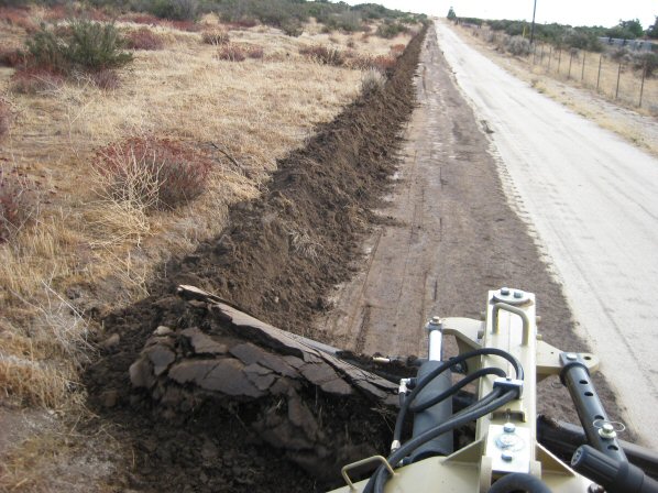

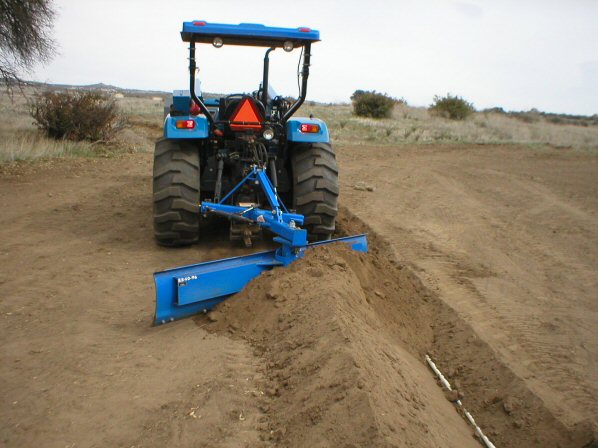

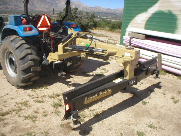

Just that we sort of think alike. I started out with the blue Midwest blade and ended up with a Land Pride RBT45108. Only a $2600 difference in price with a total of $4800 spent. An expensive learning curve. :ashamed: Getting on and off the tractor to change the angle of the blade gets old real fast.
