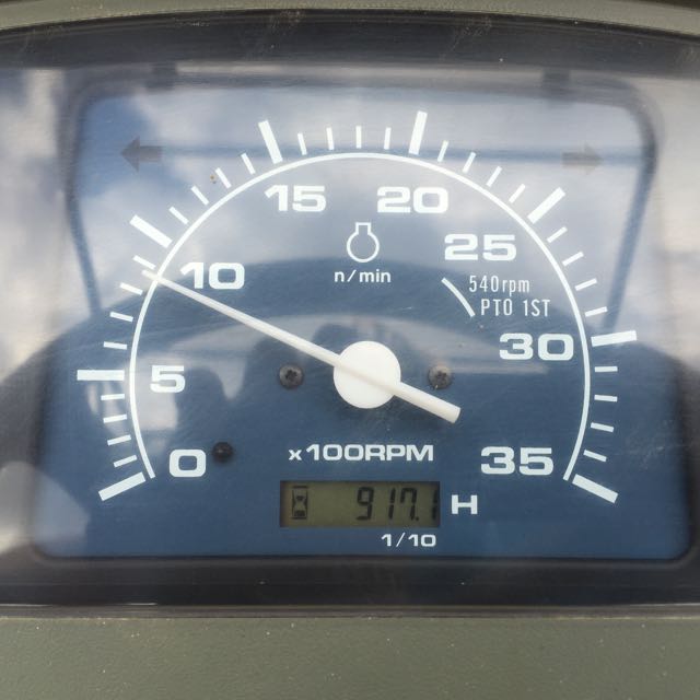

Just a couple of questions I'm hoping somebody might be able to answer please ...
1. On the dashboard, in the LCD screen showing hours, to the left of the hours there's a flashing icon - could be an hourglass. (See attached photo). I don't think it's always been there, at least I haven't noticed it. Has anybody else seen it please? If so, is it a service reminder - in which case how do you update it? My Operator Manual just shows the number of hours with no mention of any icon and the dealer who sold it, albeit 5 yrs ago to somebody else, doesn't know either.

I believe the hour glass flashing is just the hour meter indicating it is working. I have it on my 2400H.
   / Advice Please on a Branson 6530R #3
The flashing meter had always been there you've just now noticed. No worries!

Much thanks to ecbaatz and Mr Bitz for putting me straight on the flashing icon. I guess I'll have to clean my dashboard, and pay attention, a bit more often.
