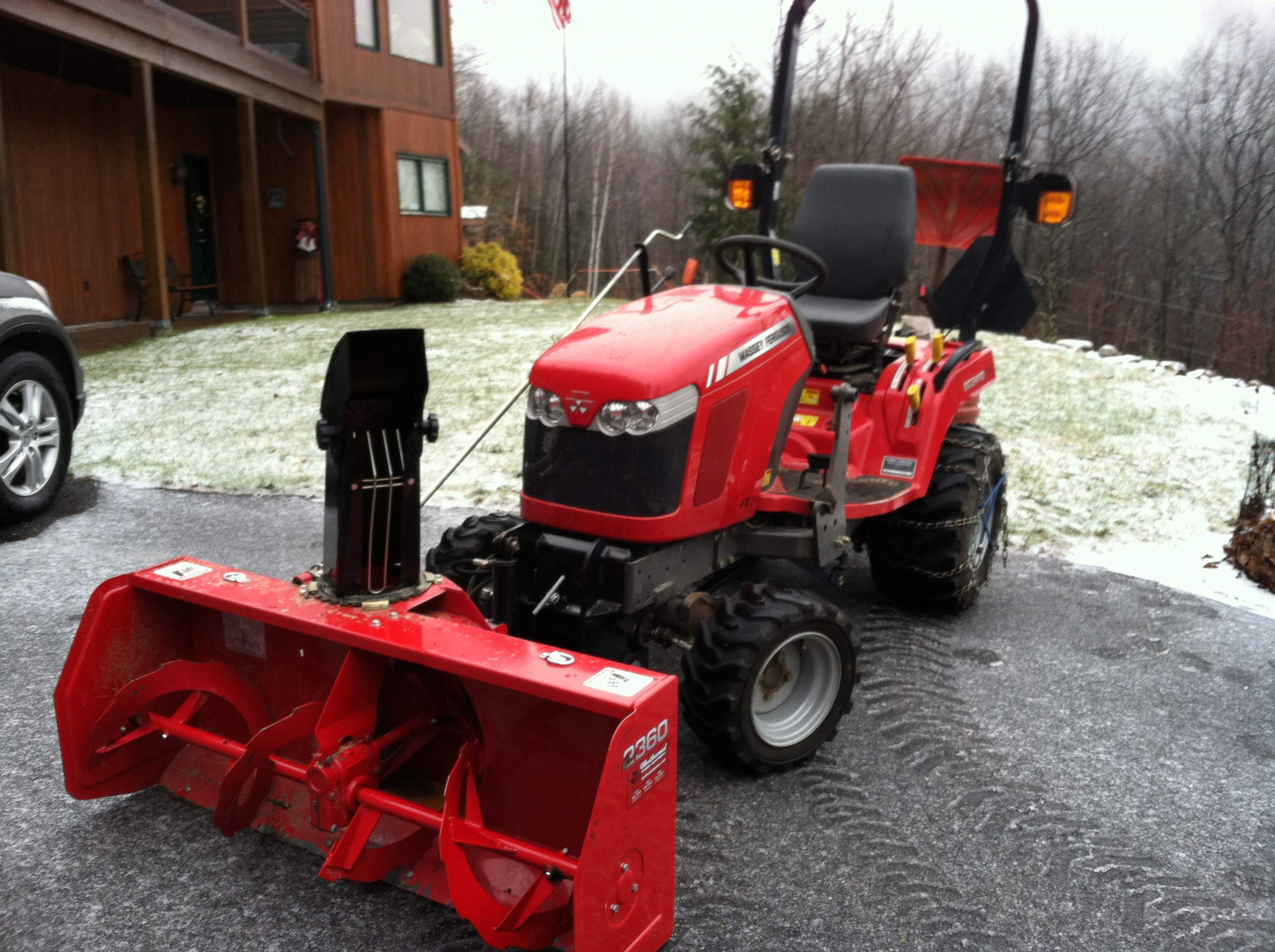

There are many scuts that have a QA that work well with a snowblower.
Here's my Massey 2410.
