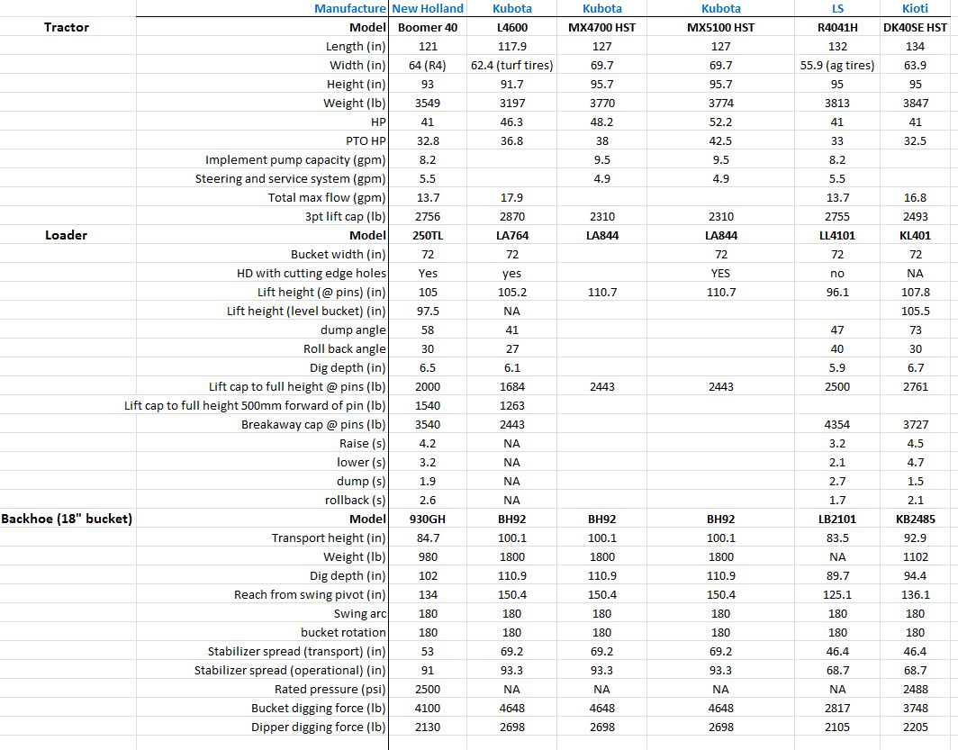

If your looking go to multiple dealers and do your research online. Figure out what you really need and what you can live without. Here is a quick list I put together for myself to help me see the numbers on everything I was looking for.
