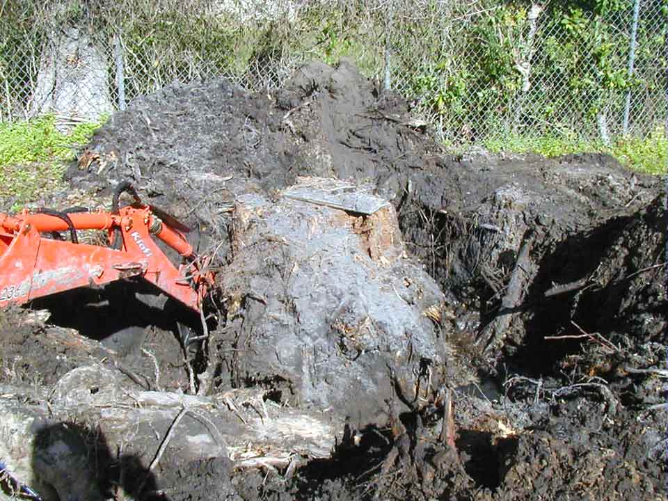

I'm close to buying a Kioti LB1914. I'm going to be digging footings for a cabin on posts, and digging a long 3-ft deep trench for a septic line. What can I expect this machine to do on stumps and roots? I can't afford a large backhoe, but I don't mind working my way around larger stumps. Have people been happy with this hoe?
   / Advice on LB1914 hoe requested #2
That tractor takes the KB2365. I have one and am pretty satisfied with it. If you check my pictures, you'll see me digging up some stumps with it. The attachment is of a BIG pine stump with a very long tap root that took me a long time to dig out. The above ground part was nearly 3 feet across, then below ground it got about 5 feet across. If you're digging oaks and other trees without tap roots, it will be much faster. Pines and other tap-rooted trees can take hours to dig out.
The only thing that bothers me about this hoe is the way the bracing on the subframe loosens up. You have to retighten the bolts about every 10 hours or so. Not a big deal, just irks me some. John

Thanks. If you're able to dig up pines that are 3 ft at the butt, I should be fine with 8-inch spruces and maples. If I get final clearance from "the Boss" --my wife--I'm going ahead with the LB1914 plus hoe and loader. Wish me luck and thanks again.
