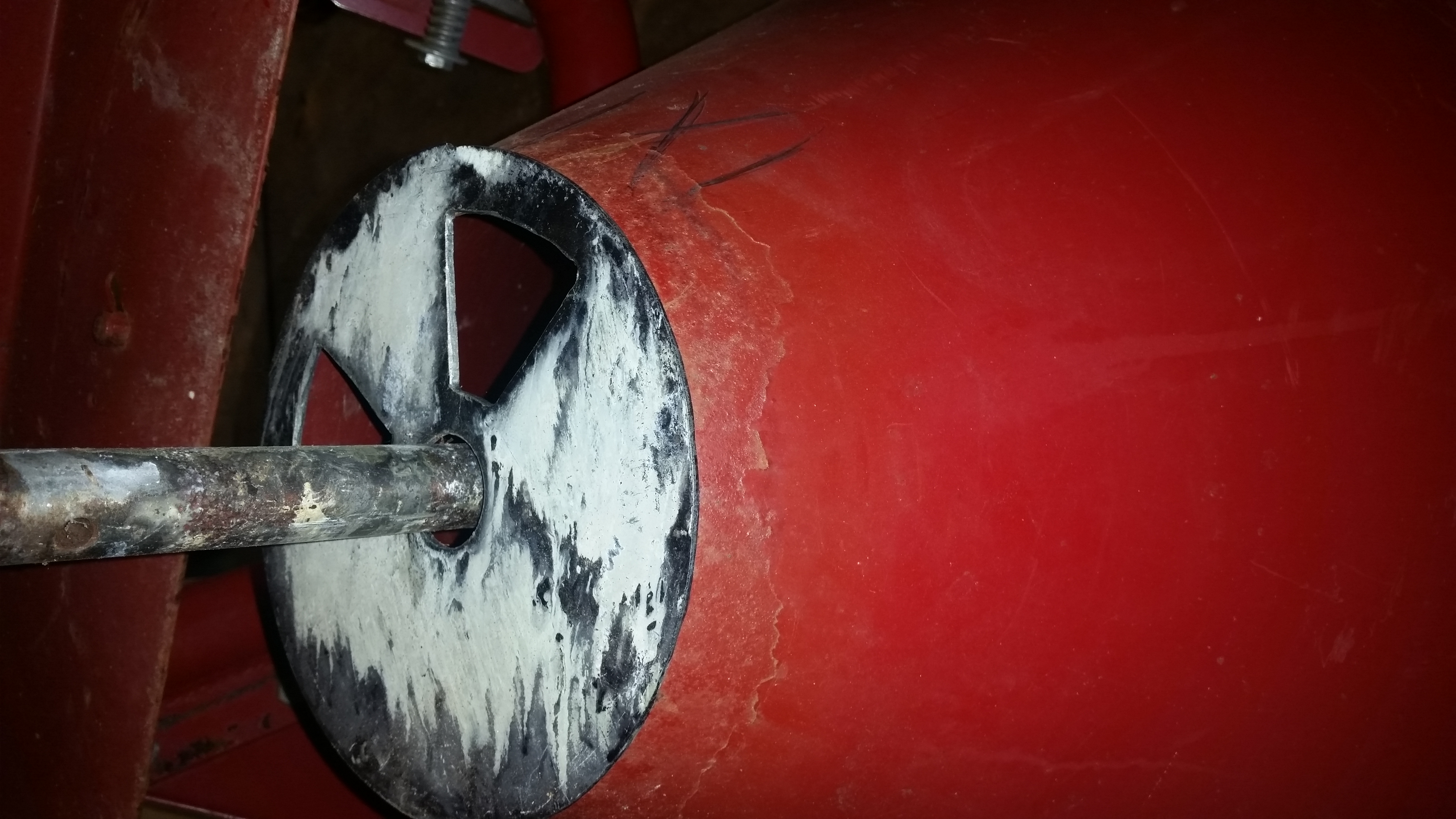

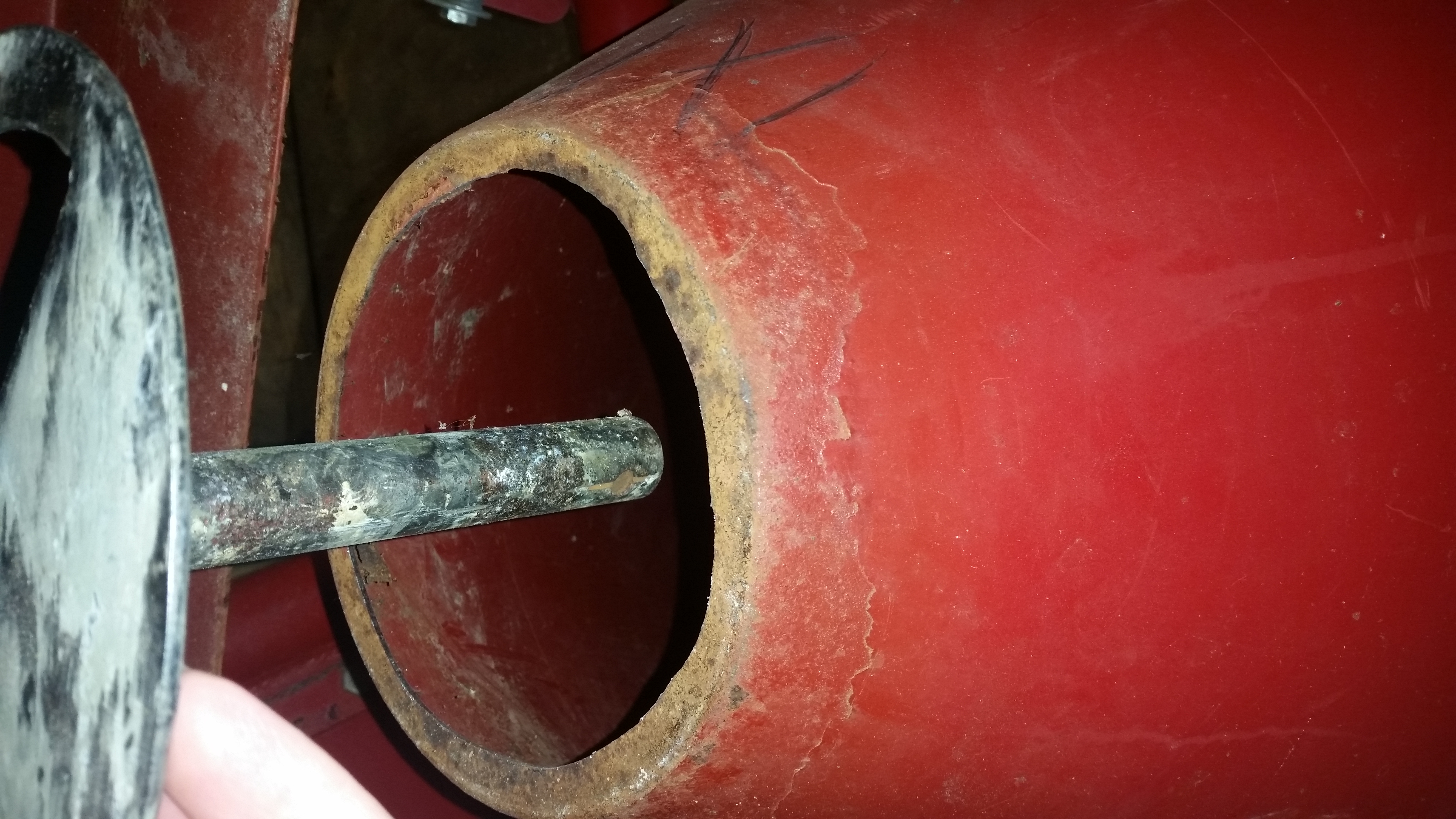

Here is the seeder with the hole cut, notice the flange area I left for a lap weld around the perimeter
   / Advice on fixing a seed spreader
This shows the new plate in position, notice how it overhangs the OD of the bottom of the cone.

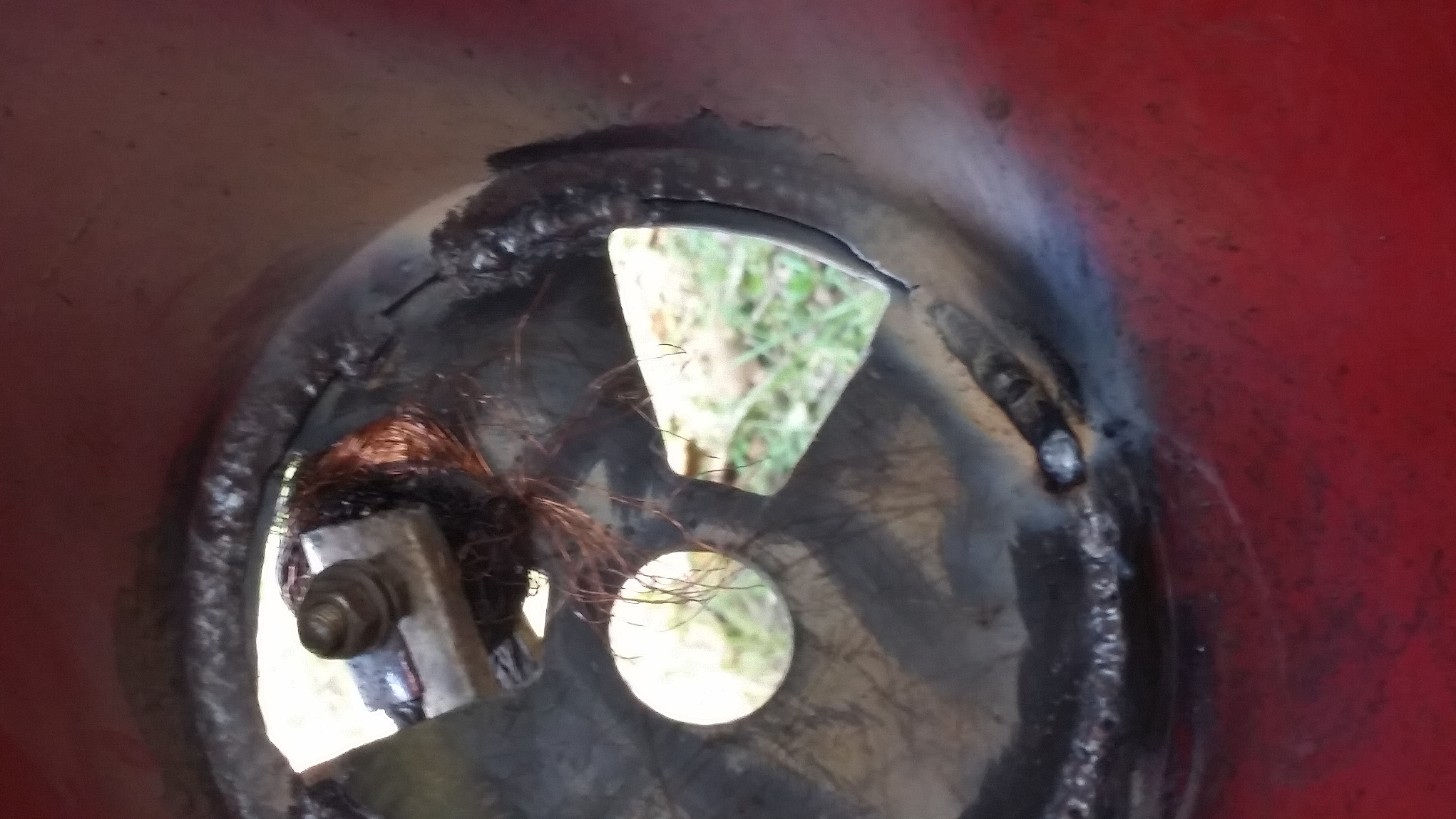

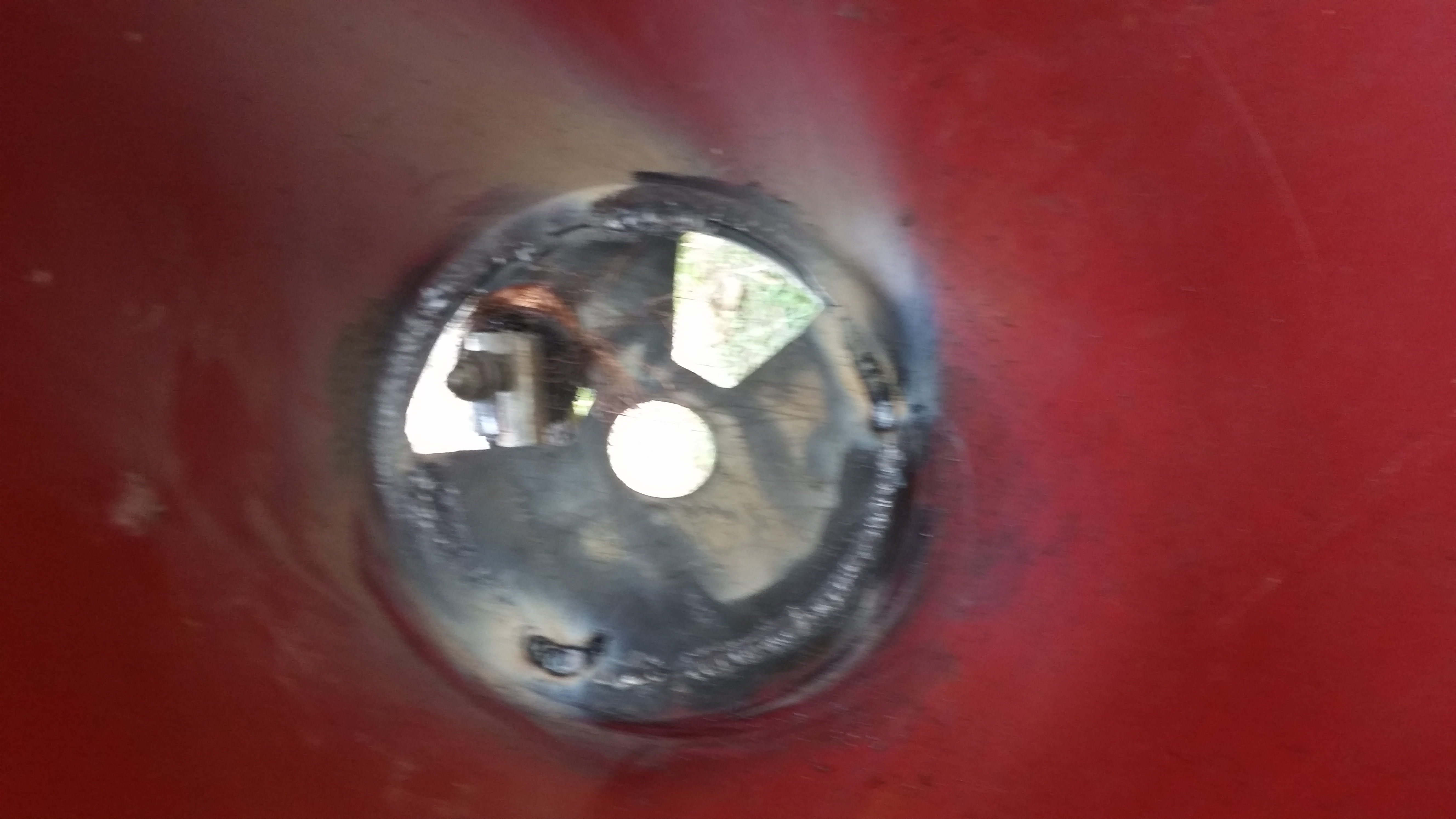

Yes you guys gave good advice. I did end up welding it, and that is exactly what I did, kept the puddle in the heavy plate and only barely swept in to the sheet metal. I also rotated stitches as y'all mentioned to keep it from creeping too bad. I think it came out ok, I could have run the grinder on it but I am satisfied with it as it is. For a guy who pulls the welder out once a year, I didnt think it came out too bad.
Tractorguy24, I was indeed worried about corrosion from the fertilizer dust. Seems everything it gets on will rust just from dewfall, and no amount of cleaning seems to be enough. From here on out, I will spray it down with diesel as others have recommended. Plus I hit the bare metal with ChemPrime, one of those rust converters, then primed with RustOleum, and will lay down a few coats after that.
I didnt weld the outside diameter, I will actually just silicone it to keep stuff from accumulating there. I am thinking that if I ever have to do a rework, I will have that outer radius to weld to, and that heavy plate can be reused, nothing is going to damage that.
Pics of the welding attached, I will throw some of the other components to help anybody else on a similar project in the future.
