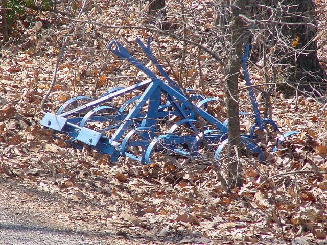

The attached picture is of a spring harrow (I think that's the name).
It's old..real old, but not rusted up or anything. The handles still move and springs pivot freely.
I bought a backblade, and this thing got thrown in...I've absolutely no use for it. If you don't mind a drive to York County, PA..I'll give ya the thing. You will need a pick up truck and some tie downs or rope.
If ya want it, e-mail me directly...if not, please reply here and maybe someone else will want it.
By the way, I drag this thing with my 670...you'd have no trouble with your 4100.

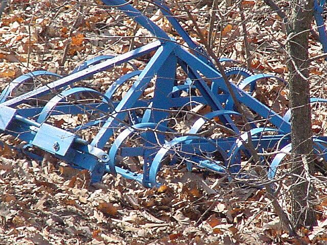

Closer view of the same harrow...

Roy,
The only thing I can't figure out is how the dang thing works!! I do not see any 3pt hitch mounting points. I'm interested but need a little more info. As a matter of fact, I will be in Harrisburg on Sunday for the Mason-Dixon Kennel Club show at the fairgrounds. If I'm not mistake, you should be about an hour or so away. I should be able to break away around mid-day.
Either respond here or send me a private message. Man - TBNers are the best!! /w3tcompact/icons/smile.gif/w3tcompact/icons/smile.gif/w3tcompact/icons/smile.gif
Terry
   / Advice on finishing a large garden plot... #6
Around here them things sell for $40. You'd better grab that one Terry. You pull it behind your machine with a chain. Nice paint job Roy. ;^)

Terry, I don’t know what kind of tiller your using, but if it’s a 3pt PTO driven one, then that’s your best bet for smoothing out the clumps in your garden. You’ll just have to keep going over it, if you have sod to break up it takes a long time to get all the clumps chewed up.
The spring harrow Roy has is not going to chew up the clumps, but might help get them all in one area so you could work on them with your tiller some more, or just drag them out of the way where they can rot out. We have a similar one on the farm where I grew up. You just drag it behind you with a chain.
That sure is a nice offer Roy, you could easily sell that for a few $ to an antique collector.
