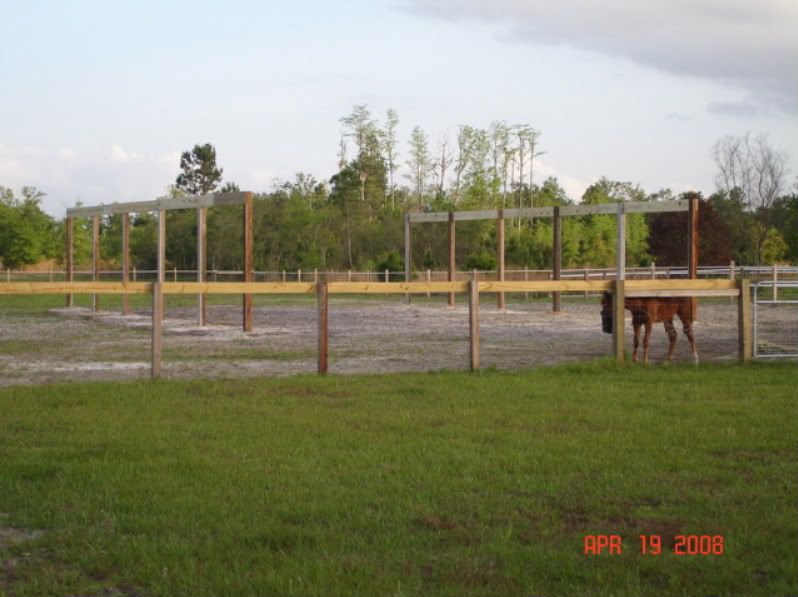

I am building an open sided dirt floor tractor shed soon. It will be about 34' wide by 20' deep with three bays. It will have shed type roof. One bay will be probably be set up as a 'loafing' area/ stall for my daughter's horse to generate some goodwill from the female half of the family that frowns on my tractor expenditures while thinking that anything they spend on a horse is a necessity.
In any case, I'm also fencing in an area around the shed as a corral. This is at our weekend cabin and my daughter has a horse that stays on her cousin's farm. My B-I-L and his family also ride their horses over when they come over for dinner, etc. So it will be nice to finally have a place for them to put their horses and my daughter's horse can stay there over the weekend too.
So I need to know what the minimum requirements for a cheap horse fence would be. I want it to look nice since its in the 'back yard' of the cabin and it will probably be post and rail of some sort. How tall does it need to be? How many rails? Rail spacing?
Remember, the horses will only be there for a few days at a time, always with us there. And again, I'm looking for minimum requirements. This whole project is being done on the cheap.

Although doing it on the cheap, I understand, I also advise you that horses can get hurt very easily and it no longer is cheap... so, whatever you do try to make everything smooth, no splinters or sharp points... anywhere.
One horse, by itself, typically gets bored and likes to paw at things. they also like to chew on the top rails of wood fences.
putting horses together who are unfamilar with each other can be a recipe for disaster... they can fight and one run the other over the fence.. any fence.
So, those are the parameters.... now, for ideas for solutions... you will have to determine what resources you have to implement...and your ideas may vary.
what about two stalls... not one.... keeps them separated. A gate between will allow a larger area when only one horse is there.
a 12 foot by 12 foot stall would be about minimum...needs water and place to put hay and feed bin.... make sure they are reachable from outside the stall, and constructed such that they won't injure the animal.
I'm not a fan of rails.... unless they are horizontal and solid with no gaps from ground to top...which they were in on the ranch where I grew up. Don't leave gaps for a hoof to get caught.
Do you suppose you could find some used privacy fence planks... these would be about right.... solid visual barrier (very important)... height should be 6 feet, IMHO. I'm thinking about selecting the best sections from what is available and sawing into 3 feet lengths... inside of pen should be the solid planks.... so that horse pushes against the bottom/middle/top attachment boards... put posts about 4 feet apart. The idea is that when standing in the pen you see none of the posts or horizontal boards... only the vertical fence planks, a smooth interior, no place for hooves to get caught when pawing at the fence (will happen) . Craig's list is here always has people wanting somebody to come drag away their fencing material for free... often there is a lot of good material.. posts and planks...
Remember that horse will walk up and down the fence... so, need extra sand/dirt inside the pen. If pen is uncovered, it WILL become muddy in whatever low spot develops...so think about drainage... reduces hoof problems in wet weather.
Place gate where easy to get into pen to muck it out with wheelbarrow, etc. Don't forget a place to put the tack... it really builds up, along with feed and hay (hmm... you may not have any place for your tractor and equipment:rolleyes:)
For a larger run around, it's hard to beat this tightly woven wire netting... although cost is significant. An alternative is a 1X12 board fence..horizontal boards with about 1 foot gap from 1 foot off the ground to top at about 6 foot. Height is influenced by how intimidating you want the fence to be to the horse... and how tall the animal is.
Good luck.... horses are never cheap! Watch out... you may soon be building a riding arena complete with lights and outhouses:eek:

Only one or two horses would ever stay even overnight. And all of these horses live completely outdoors year round. So this area would mostly be a place for cross ties for grooming, cleaning hooves, etc. and rain shelter if needed. It would be open into the corral area. More like a loafing shed than a stall. The 'bay' will be about 11' wide, but up to 20' deep.
Ugh. Its probably going to be a plain 2 or 3 rail fence. I've seen them on lots of horse farms, but I can see what you're saying. But remember, these horse usually just get tied to a cedar tree for hours at a time in this same area and do just fine. They currently live in pastures behind 3 strand barbed wire.
Had not thought of that. Drainage is okay. No puddling, but the ground here gets spongy. Fortunately I have an endless supply of nice white creek sand to patch low and worn spots with. And again, the horses won't be in there long or often. A weekend here and there. They live only about 1/2 mile down the road. So this is more like a rest area than a home.

my old house had a 4 foot three rail wood fence made of 2x6 rails and 4x4 posts. never had a problem. the only problem is we have a 16 2 hand wood chuck named johnny, who also does a mean stevie wonder impression (x race horse with a few issues). to fix the chewing we ran a strand of hot wire tape about 4 inches inside the top rail with a solar fence charger. jon

An inexpensive quick way to make a corral is to use the electric fencing and T posts with caps. Use the wider tape kind and it looks nice to.
If your into the wooden rail look and want something thats safe check out centar or Electrobraid fencing.
Here is one link: Electrobraid - Electric Horse Fence, Safe Livestock Fencing
   / Advice on building a small corral. #9
George I did field fence 48" tall with a 6" board on the top, I did this just on the front side facing my house so my kids would not touch the hot wire. The 3 other sides I used 1.5" electric tape above the field fence. I have seen too many horses get hurt with nothing but rail fence or tied up in barb wire so I always put up field fence to try and keep them safe. You can see the font with the board on top in the picture below.
