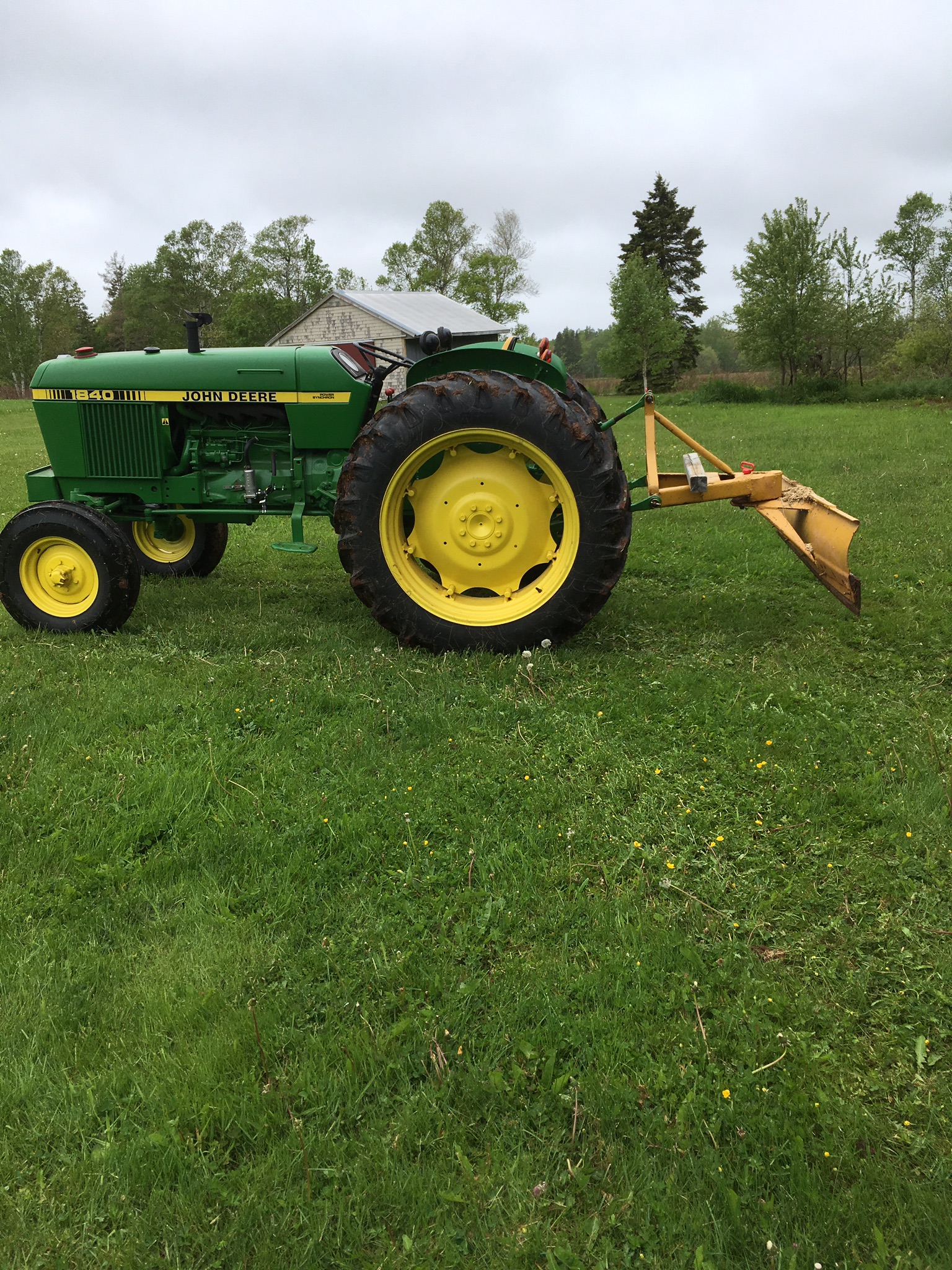

I bought a JD 1840 which is the Canadian designation for the 2440 a year ago and I use it for clearing snow and pulling the odd implement about the acreage. It has no FEL but that was not a big requirement of mine. I like that it is a simple tractor with no electronics to cause issues and 60hp is plenty for snowblowing with the 70” blower I have.
Mine has the Hi-Lo transmission and independent PTO which are handy. I have new tires on it and a gradually sloping 600’ drive which I plow with the grade and have never felt the need for chains or a 4WD solution.
One issue I discovered once I was blowing snow last year was the PTO was slipping, and this resulted in a need to replace the clutch pack on the PTO. The fault was a result of hydraulic pipe in the back end that had a hole worn through it by a bracket assembly that prevented full hydraulic pressure from reaching the PTO hydraulic clutch and allowed slippage.
I had to have the tractor split to access the clutch assembly and the new pipe is redesigned to eleiminate the bracket that caused the wear so it won’t reoccur. While in there I had some shift forks and rods replaced that were showing excessive wear, and she shifts like a new machine now.
You could have a mobile mechanic put gauges on the test ports to see if your hydraulics are OK but given only 1200 hrs on the tractor you are likely fine. Mine had 6600 on it and had a fresh in-frame rebuild on the engine when I got it last year, and now that the PTO issue is fixed I should see many years of use with few issues.
I chose an older machine in good shape over a new tractor as new tractors cost far too much and these older machines are simple and will run near forever with a bit of maintenance, especially if not used every day all year. Mine was built in Mannheim, GE and is a solid machine with parts easily available if needed.
