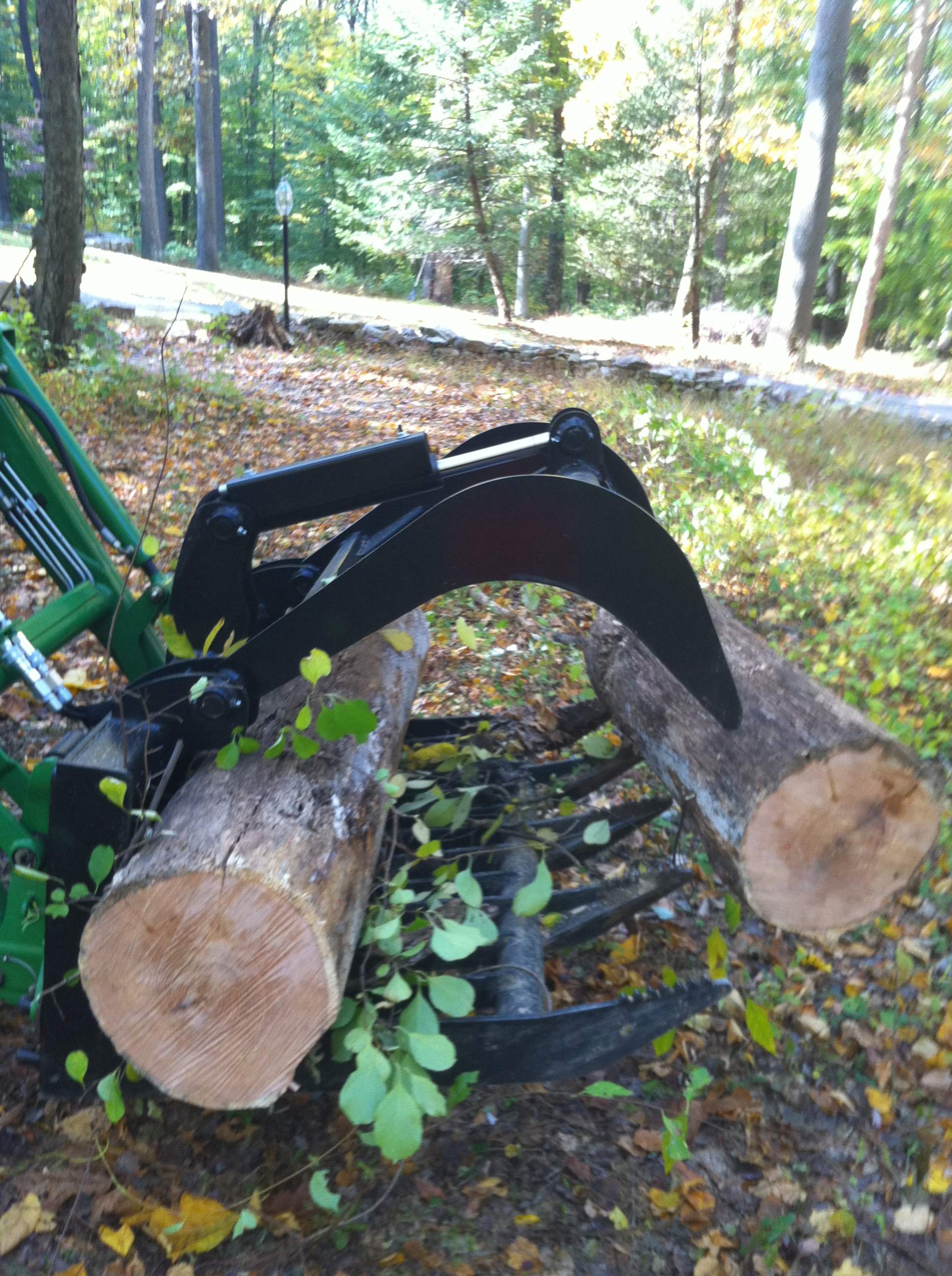

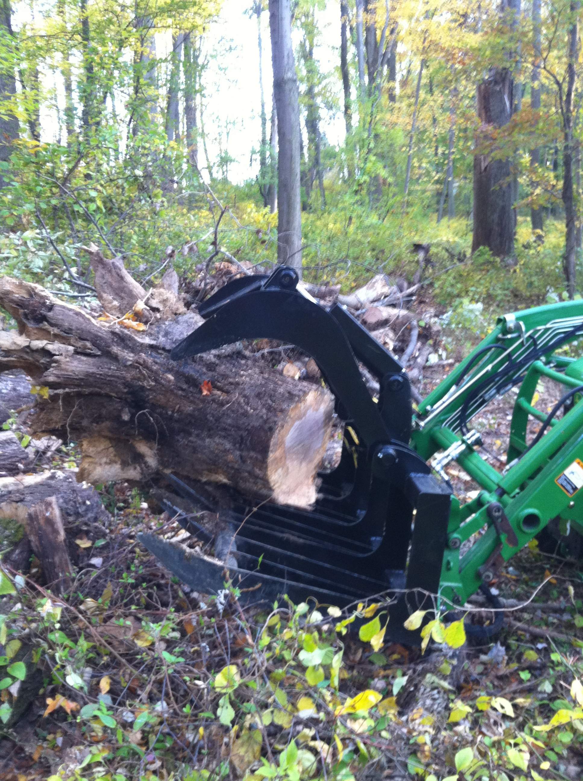

You might consider a grapple for your FEL. I recommend pulling posts with the rear hitch. I made a little post puller attachment for the 3 point.

as for the trees, get pallet forks for loader or a double bale spear setup. you can dive under and pick them up without having to get off and chain them to the bucket.
i even made a grapple for my spear/fork setup. works awesome

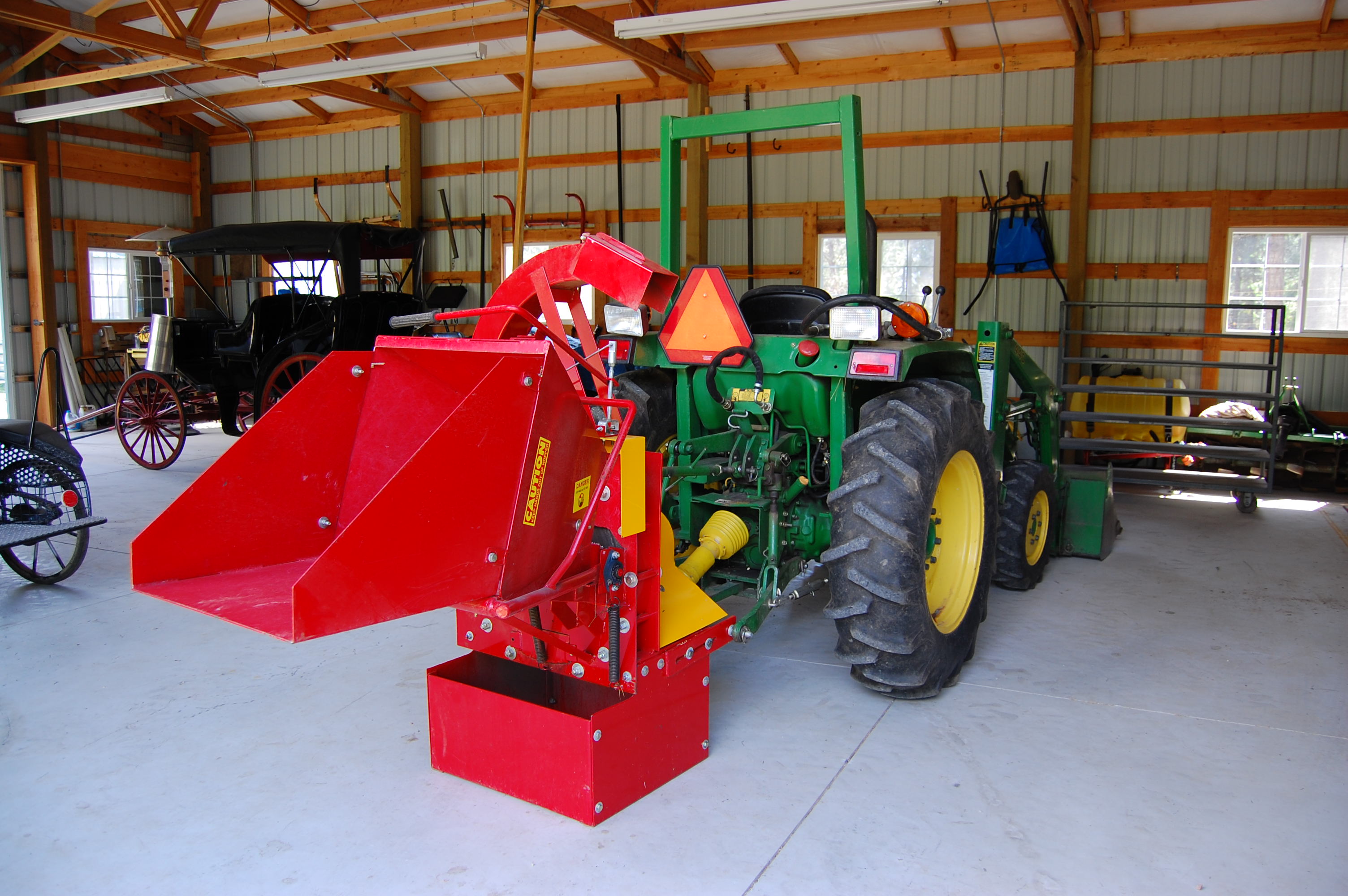

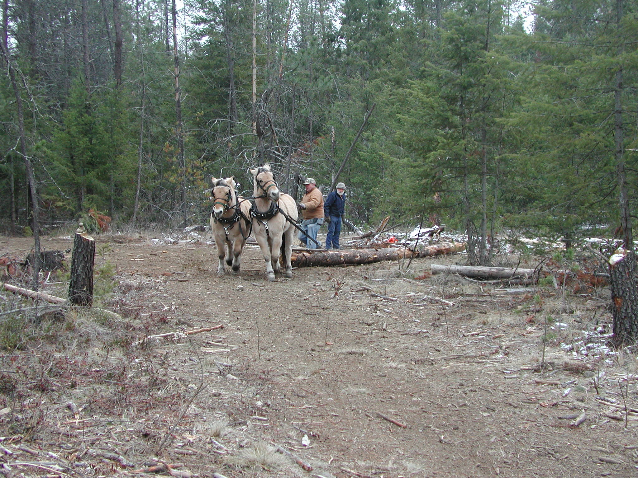

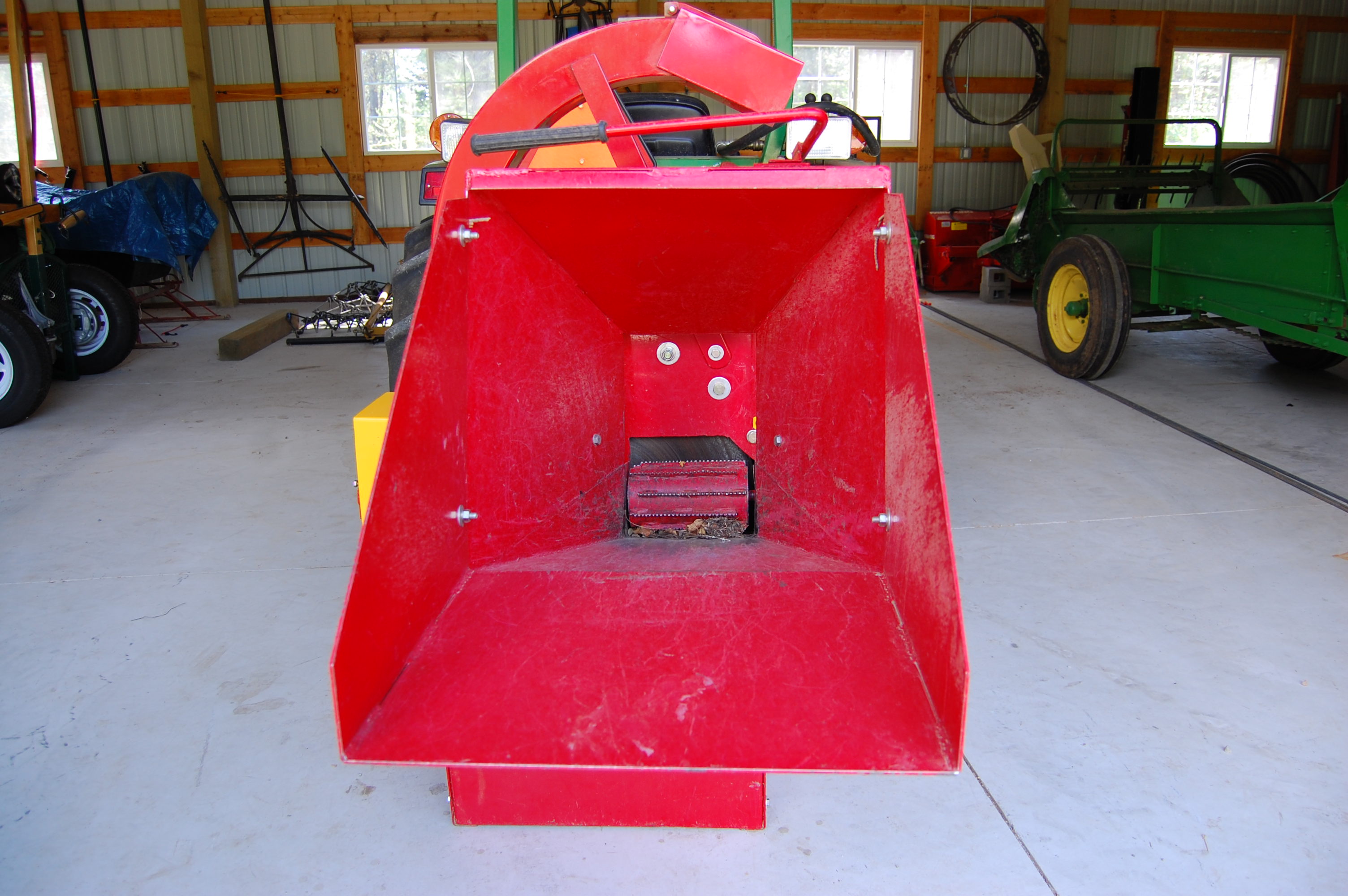

i like grapples, but they were still hard to get the logs out of my trail system on my property without hitting other trees. what i ended up doing was buying a Jimna wood chipper ($about $1,400 but you can also rent). this makes short work on anything under 4". it can handle 6" diameter, but i burn that size.
i shred all my brush and downed trees, spread the chips on my paths, and the trail system looks like a park. Old rotten wood still has to be skidded out and burnt. i like to skid with the horses, but skidding with a tractor is faster, but not as much fun.

Some type of grapple for the loader would probably be the best choice for picking up and moving logs, but would require some extra hydraulics beyond the standard setup from the factory for the 2520.

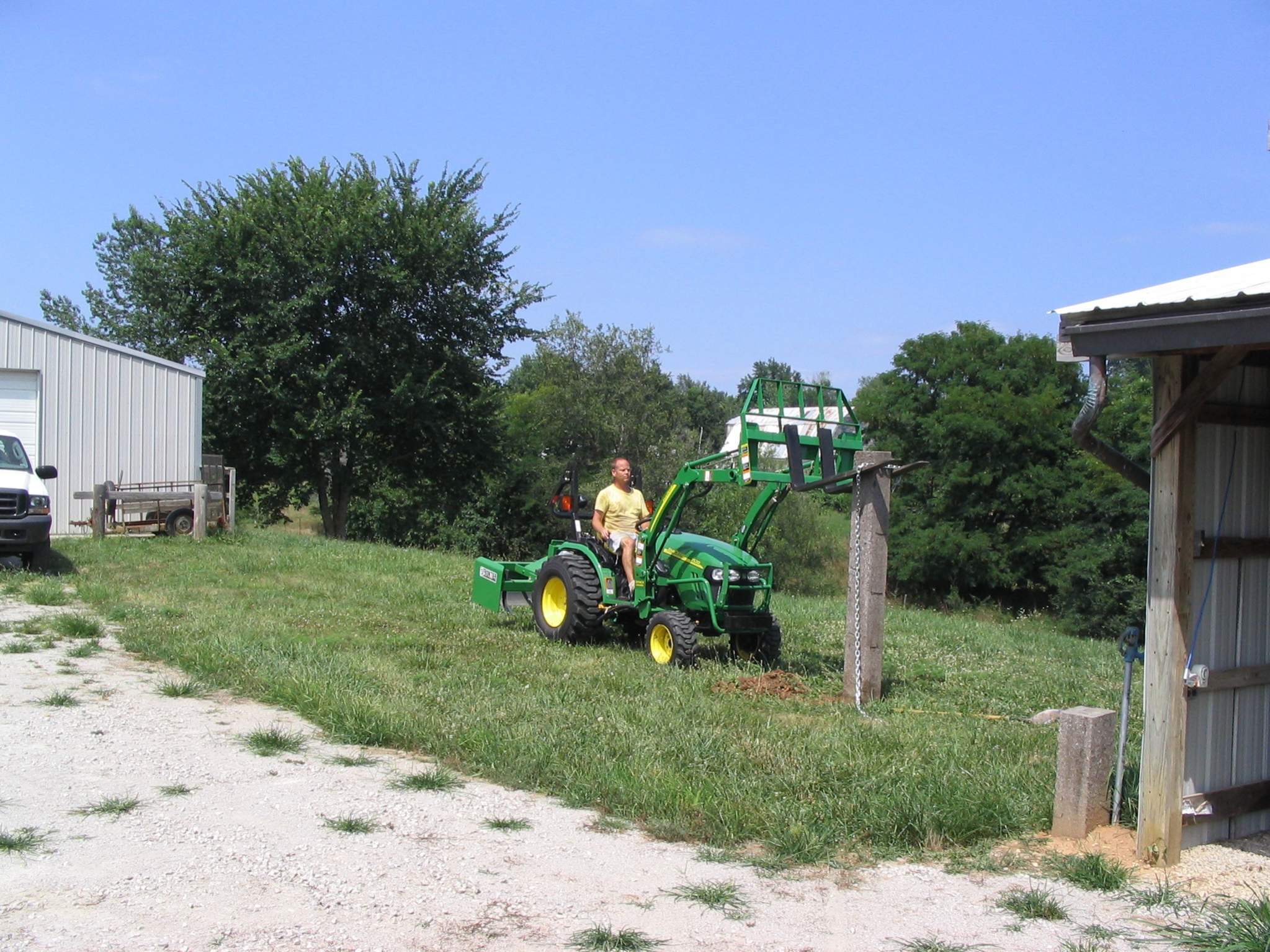

I find my pallet forks to be invaluable and have used them to move a lot of rocks, logs lumber and whatever. They are also good for pulling posts, just wrap a chain around the post and over the forks.

I agree with all advice provided. And for the fence posts, a chain hooked around a FEL pallet fork and then wrapped around the T-post makes pullout easy. If you use pallet forks to move a stack of small tree trunks just remember to move your load in a low travel position at slow speed with your hand on the FEL joystick to avoid or recover from the "thrill" of lifting a rear tire and feeling the tractor begin to tip.
