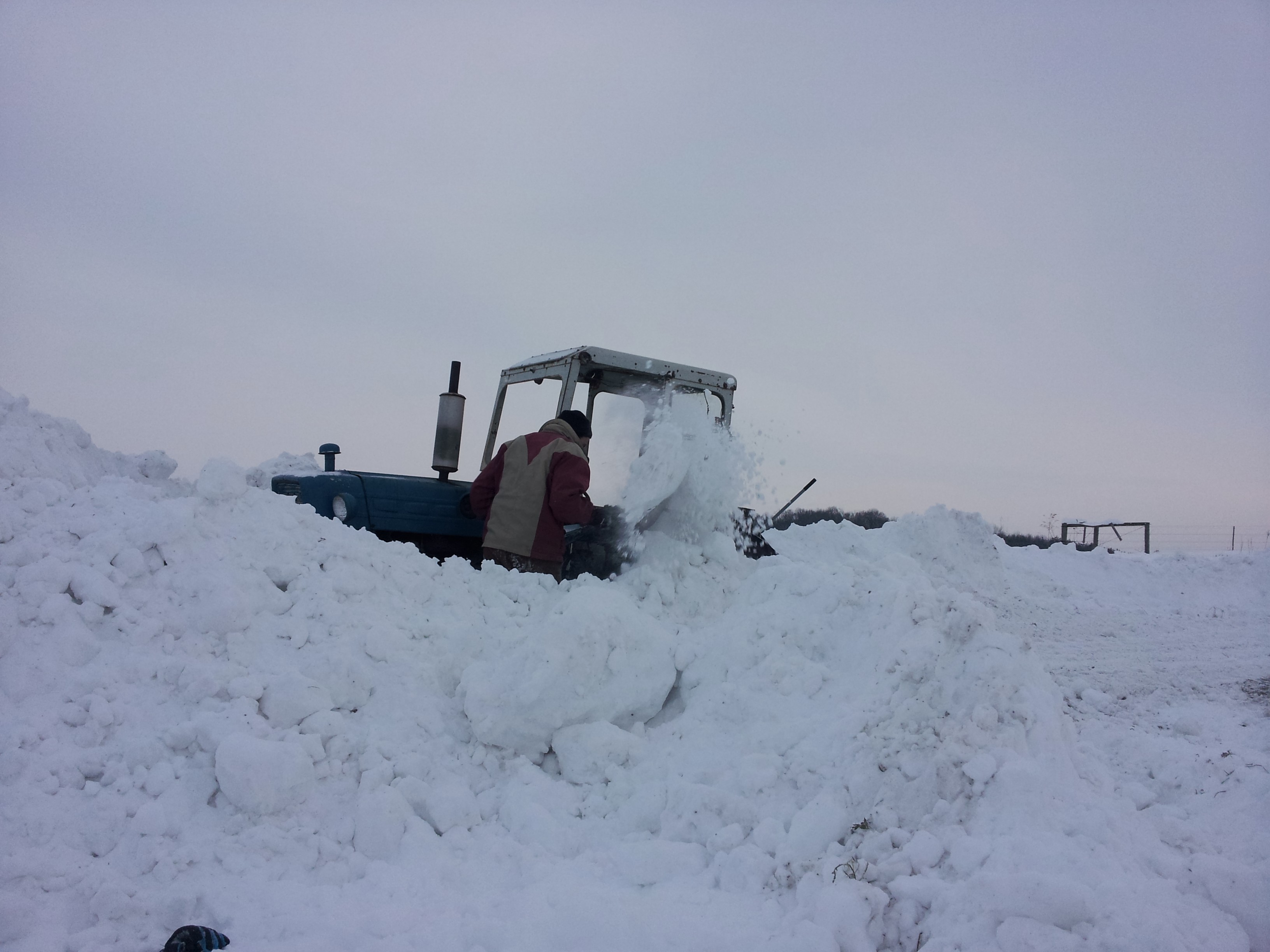

  • Removing snow from a 1600' gravel drive, usually just a blade, but sometimes I get very deep drifts. This has become a big issue this winter.

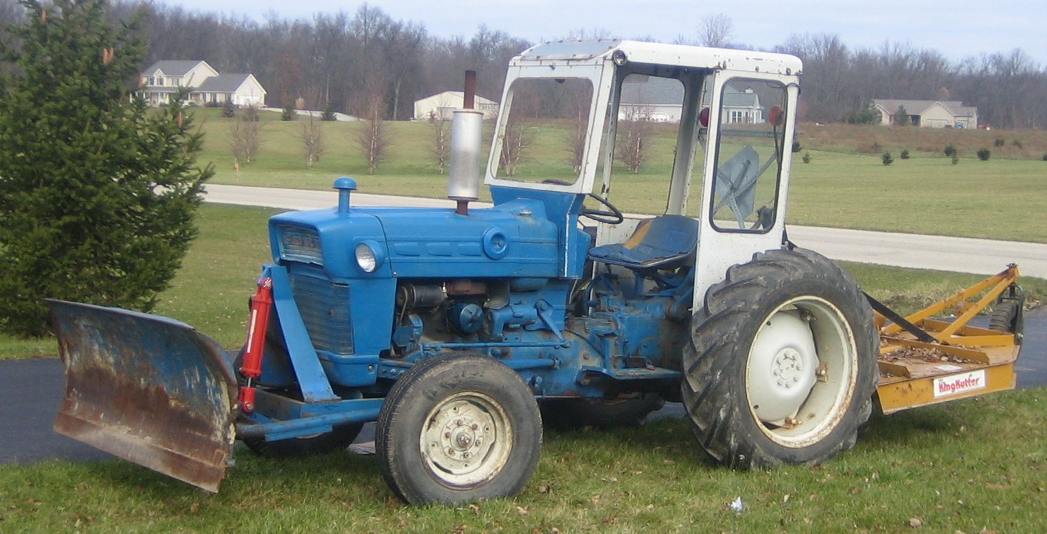

I currently do this with a '68 Ford 2000.
This was originally a snow removal tractor, but the heated cab is no more and the front blade no longer has many of the original features. This is an old picture from when I bought it, the blade is now unbent and painted and looks much nicer. I really love this old tractor. I bought it for $1500 and after replacing the fuel pump, water pump, modern carb, elec ignition and new coil it runs great. ;-) Starts well and has plenty of power. That is 36hp, but with good gearing I have skidded some huge trees out of the woods. I really wish I had pictures of some of them. The most noticeable missing feature is a loader. This year the blade isn't working for snow removal, I have piles on both sides of the drive that are taller than the blade and these piles cause the blowing snow to collect directly on the drive.

On snow we get a big snow only every 4-5 years and normally a blade is plenty. So I wasn't planning on spending money on a snow blower. I figured I could just use the loader on those years where the piles get too big for the blade.

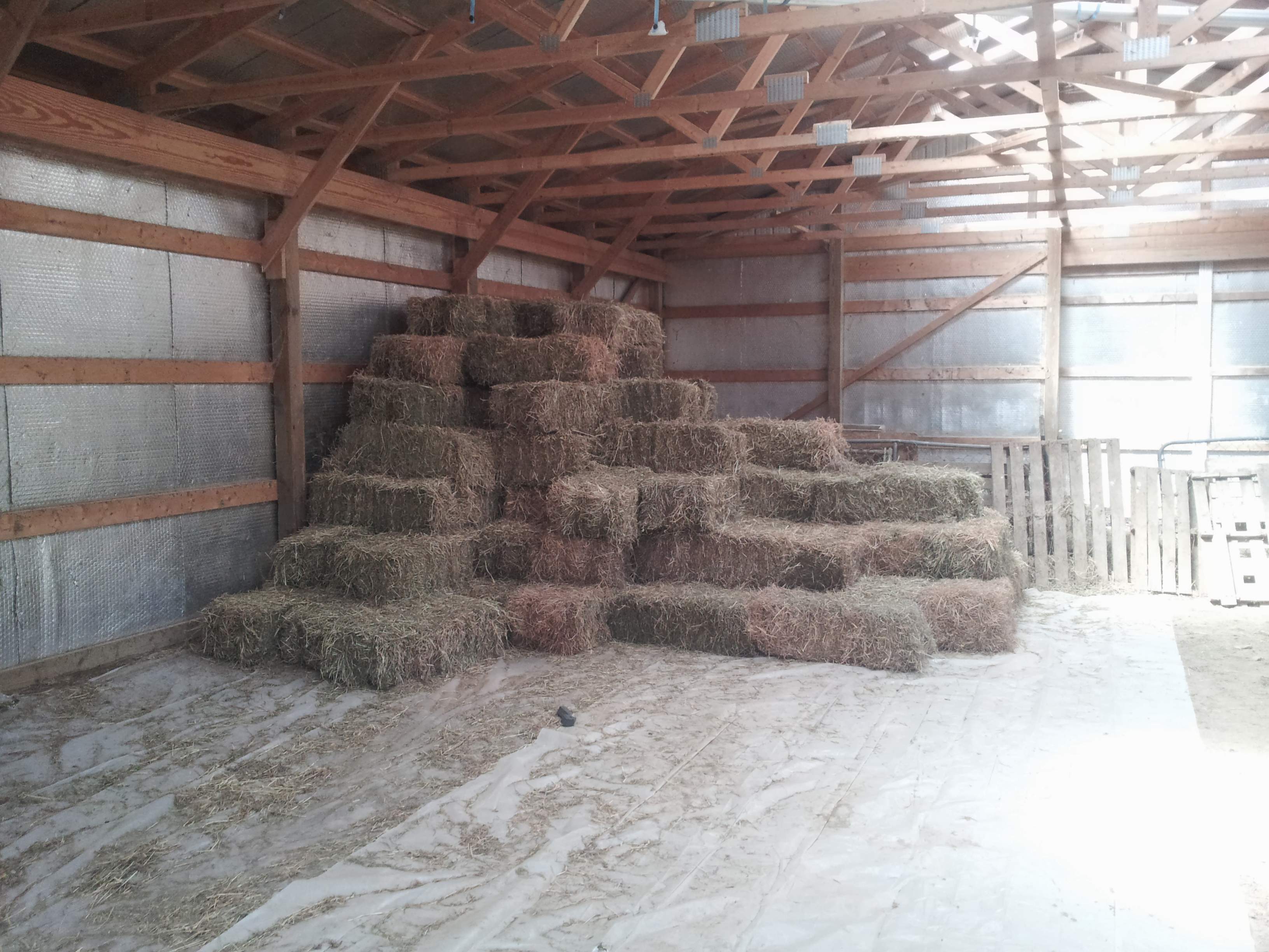

That does remind me of another idea I had for a new tractor that favors the 5100. We store small hay bales in the barn:
And piling that hay be hand is a real chore. I have considered the idea of stacking the hay in 4' cubes on pallets and then using pallet forks to carry these into the barn and stack them.
I was thinking I could do 3 high without them being too unstable if I am careful and it would certainly mean moving the bales less.
If that works then the smaller 5100 with the more nimble HST would win.

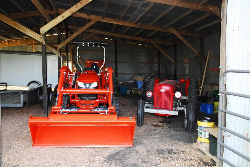

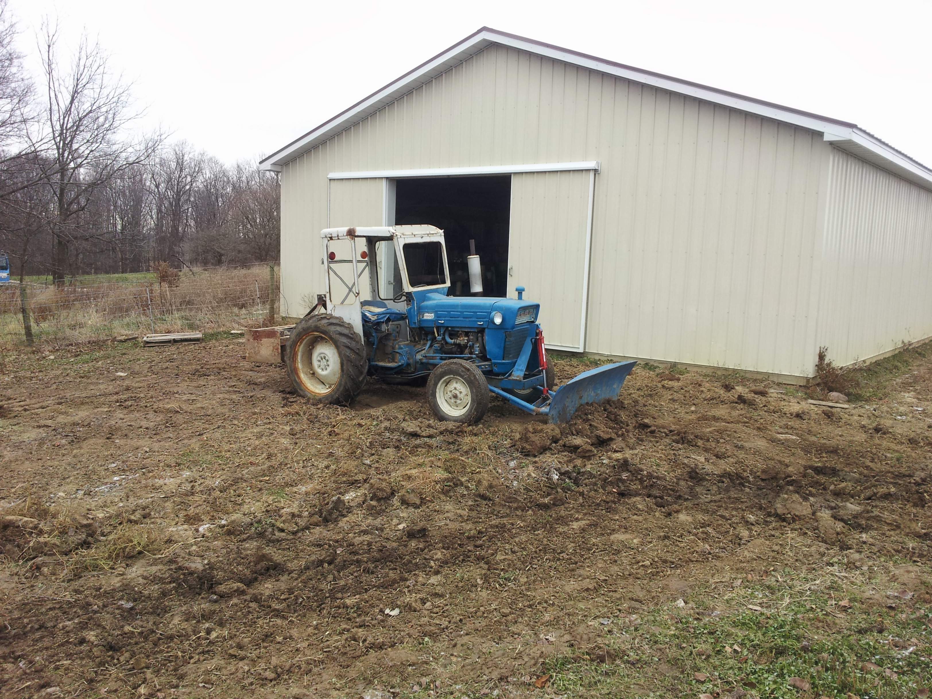

BTW since people like pictures here are some other tractor pictures:

View attachment 356448View attachment 356449View attachment 356450
I have a 70 HP tractor that I bought when looking for a 50 HP mostly because I got it for the same price as the 1652 MF that I had looked long at. While it is great for heavy lifting etc. and I still need it occasionally for heavy chores, I find my go to tractor is my Kubota B26 TLB. It gets into places the LS just cant go, has a fair capacity for moving things and the backhoe is my most used piece of equipment. I bought it used 18 months ago with 68 hours on it, it now has 350 or so while my LS is just approaching 100 in over 3 years. It is hard to put many hours on it as it does stuff so quickly.
I suppose I am saying that you can get too large of a tractor. If you only have one, get the one that can do 90% of your tasks easily and the other 10% not so easily but still can do. To me a 45-50 HP tractor can do most anything on a farm that needs done, it may take a bit longer or take more trips.
