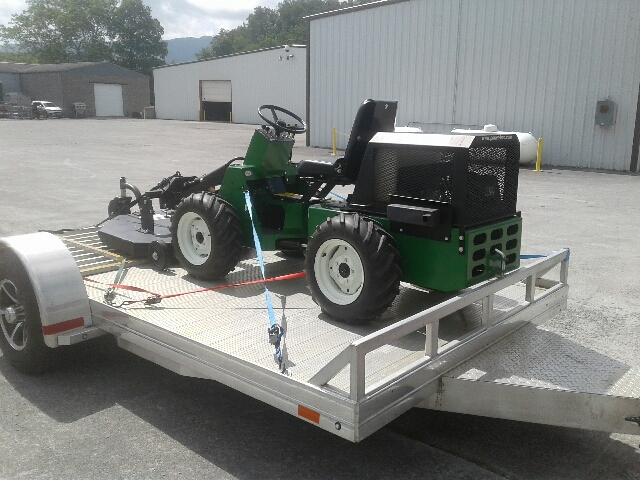

Thanks for the info. They seem to update the machines as the years go by. Hopefully the engine company did too. I took the plunge and went down to the factory, tried them all out (PT180-425-1430) and could not find a reason not to buy the PT180. The only downside I see is no oil cooler which limits op time. Thanks again!
