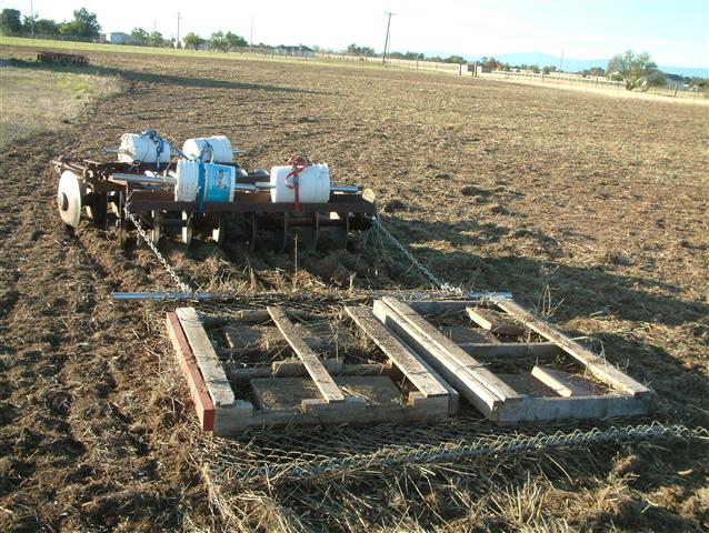

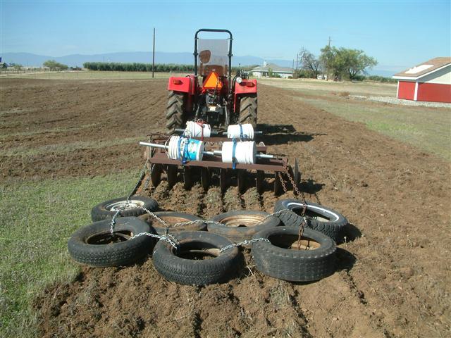

I have a 6 acre hayfield (10 acres total parcel) that I take care of with an old 6.5 ft Towner offset disc that I pull with my Mahindra 5525. Add about 500 lb of weight (4 buckets filled with concrete) and a home made drag to work the soil (it's thin and gravely).
The tire drag works OK, but the new drag (a piece of chain link fence with paver block weights) works better.
