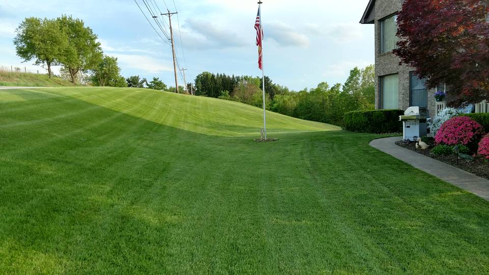

With you mowing under an acre, you will not really put hours on that garden tractor. I mow just over 3.5 acres in Beaver County and I average 50 hours a year and I mow 2 times a week in heavy growth season. That affordable tractor will last you decades if you store it inside.

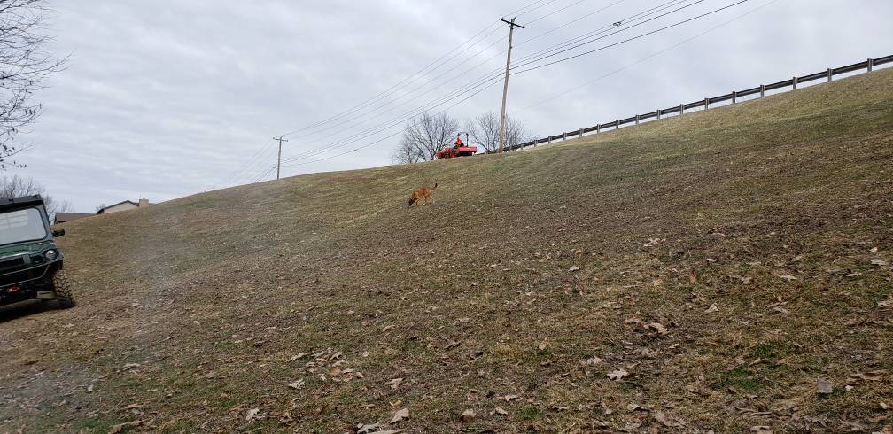

If your near Beaver County, I invite you come over and play on my "cheap" garden tractor and go do some hill climbs while mowing. One is a 2011 with just under 700 hours on it and the other is a 2019 with 6 hours on it. Both will live a long, long, stupid long time because maintenance is like a religion to me. I would expect an easy 1500 hours from the machines. I am 10 minutes from Cranberry Twp., come on over if you want to go hands on.

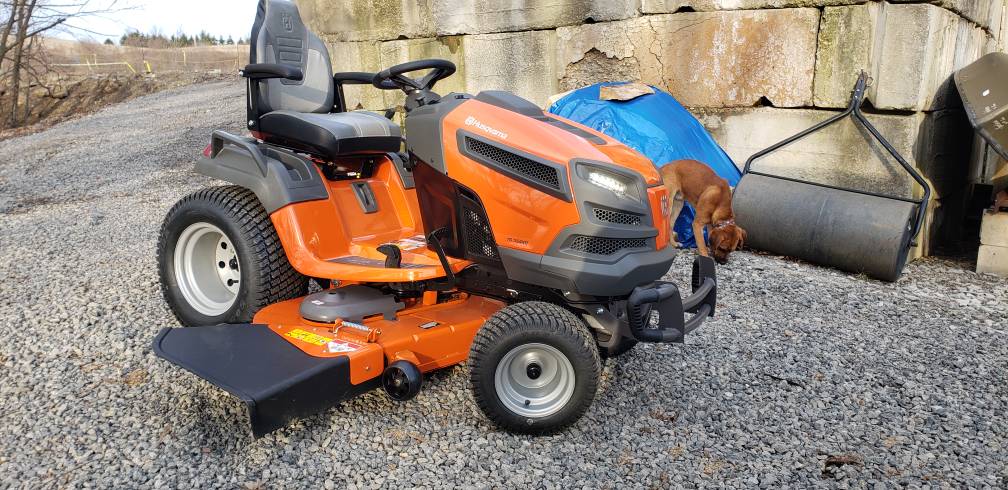

Best bang for the buck in your price range, in my opinion, is the Husqvarna that I have. The Husqvarna TS348XD or TS354XD. It's not a $8,000 to $12,000 John Deere, nor is it a $7000 Simplicity. Those are a different class of machine and no one would argue it. But in your price range, you are not going to find a better value for mowing and light towing with a yard cart for firewood. It has a belt drive Tuff Torq K66 that has electronic locking rear differential and a pair of healthy engine choices in the Kohler 7000 series V Twin or the 2018 Kawasaki V Twin. With a set of 50lb wheel weights and a set of chains it can climb, push or pull very well. I was dragging a 450 lb roller on my sloped property that you see in the attached photos above all afternoon Sunday after the morning rains passed us by.
You have choices to make. Good luck.
