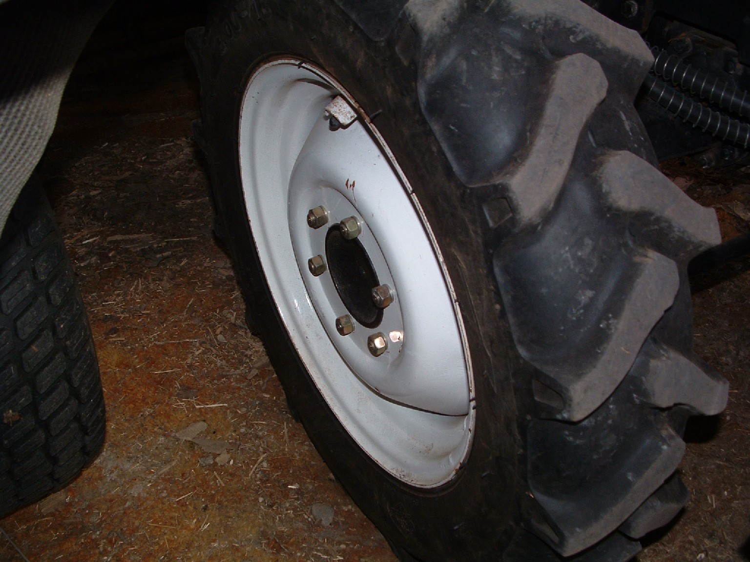

Well if you swapped the fronts right, it should have moved each wheel out about 5"-6". Do your wheels look like the attached pic? Mine are shoiwn here still in the narrowest position. The center section is dished out nearly to the outer edge of the wheel rim. If I took this tire and wheel off and flipped it around right where it sets, it would be setting several inches farther out from the tractor than it is now. If I did that the tire tread would of course be going the wrong way. There are arrows on the tire side wall that shows the proper rotation direction when the tractor is rolling forward(best traction for pulling). If I took this wheel the way it is pictured(proper tread direction) and keeping the arrow pointing in the forward rolling direction and moved the wheel to the other side it would mount with the dished center section pointing inward. If you keep the arrows so they are pointing forward and move the wheels to the opposite side, your front wheel base should increase by nearly a foot if they are mounted like mine in the picture.

/ Adjusting Wheel Tread
Ron - I did just that as I knew the tread had to face a certain way. My front wheel does not look like yours. It appears my wheel center is almost centered in the rim, not dished toward one way or the other, thus flipping to other side did absolutely nothing. I called the folks at Nortrac and they seem just as confused. I begining to think that you can't widen these for some reason.

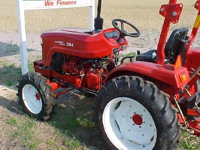

You can widen the stance take the front tires and swap sides turning the dished out part of the rim to the inside which will move the tires out 5-6"
If you look at the pic of the front wheel in the previous pic,that outside of the rim would be inside when you swap them.You have to put the left front on the rightside and the right front on the leftside to keep the direction of the tires right.Do the same with the rear,you can leave the weights on the inside if you want,also on the rears you can unbolt the center plate and reverse it for move width.Take a look,you will see it's not that hard once you swap sides

/ Adjusting Wheel Tread #12
Here is a pic to look at
Tommy
Affordable Tractor Sales

/ Adjusting Wheel Tread #13
Pirate said:
It appears my wheel center is almost centered in the rim, not dished toward one way or the other, thus flipping to other side did absolutely nothing. .... I begining to think that you can't widen these for some reason.
The front rim that originally came on the 4wd 200 series was a fixed offset type, mounted concave side in to help protect the drive assemblies from ground obstacles. I've got an older Jinma 200 series owner's manual that is pretty clear about NOT reversing the front offset rims on 4wd models. That said, subsequent manuals may have changed. A drawing of the 4wd rim I'm talking about can be seen at http://johnstractor.com/files/FrontWheel.jpg
#14
Well, now that I have my eyeballs calibrated, I found that I did indeed gain some distance by swapping the fronts. Funny, they seem exactly lined up with rears now so I don't think I will mess with the rears. In fact, I will probably put fronts back. Guess I need to hire a dozer to level some roads to ease that pucker factor.
