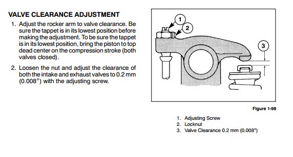

Hi Fellas,
My '89 FORD 1720 4x4 Owner's Manual says to check (& adjust if necessary) the valves every 600 hours.
It has the 3-cyl Shibaura diesel engine. The tractor has logged 3,135 hours of operation.
Considering that the previous owner primarily just fueled and greased the tractor, (I've only put 1I hours on it) I'm betting the valve clearances has never been checked - but to the tractor's credit - it starts & runs fine - currently.
Now this check/adjustment is explained in the Owner's Manual, but is this task really something a novice mechanic can accomplish or should I plan to have a diesel mechanic / dealer perform this check/adjustment? :confused:
How many of you guys do this check/adjustment yourselves every 600 hours? :confused:
Thanks in Advance for any & all suggestions, thoughts and advice, Guys! :drink:

I just looked at this procedure in the service manual for my TC29D since it is nearing the 600 hour mark. If the valve cover isn't hard to get off it looks like a straightforward job. I am also not sure what the access is like to turn the engine over by hand. You'll need a good feeler gauge - step type is the best but not necessary. A dial indicator is the most accurate way to make sure your piston is at TDC (Top dead center) where the adjustment must be made.
From my experience with cars it is best to make this adjustment with the engine as warm as practical.
