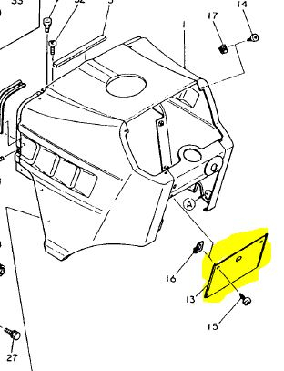

Ok so before I get pissed off and dismantle the the body what's the secret to access the throttle friction adjustment. The FSM I have for the 276 diagrams an access panel that does not exist on the 2310.
   / Adjusting throttle friction on my 2310 #2
I think you should be able to reach it by removing the highlighted panel below.
