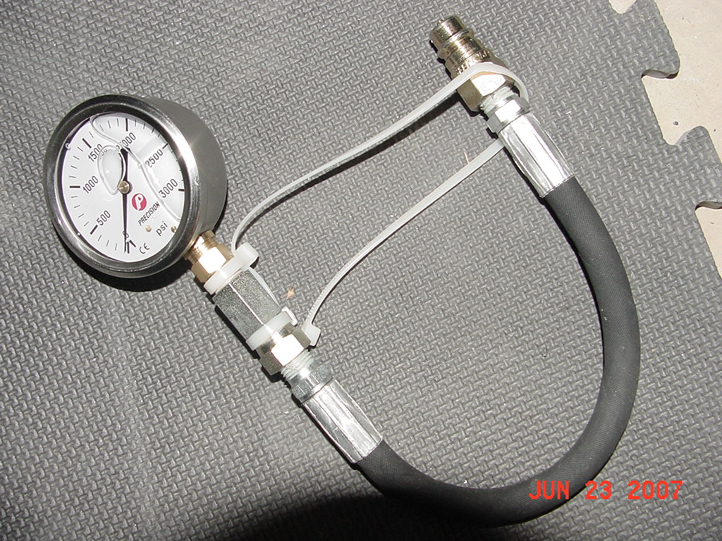

You need to make up a pressure gauge and take a reading before you do anything...The relief valve I believe is under the seat on the tranny somewhere BUT you MUST have a gauge BEFORE you mess with it!
You can get a 0-3000psi gauge from TSC or the SurplusCenter, a short hose, and a coupler that will plug into one of your FEL ports to get the reading. (see attached picture) Once you have the gauge made up I can help you further.

I believe that each valve has its own pressure relief and there could be different opperating pressure depending on the setting of any valve on the tractor. Like kennyd said, in order to adjust the relief valve you need to use a pressure gauge. If you are having trouble with your log splitter, take a reading of the hydraulic valve on your splitter. I think the common working pressure is around 2500 psi. most hoses and components have a limit of 5000 psi bursting pressure that should not be exceded.

This (above) is what I had in mind. Thanks. My cheater thought was simply to check the regulator and try and determine if it was roughly set correctly.

Well, get a gauge setup and we will see what you get:D
